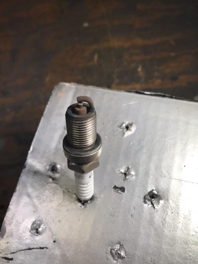

hello, just looking for comments on this plug. engine is a 468, 6:71 blower, 8:1 comp, #8 boost (2)- 750 holley carbs 5.5power valve, 67main jets. To me the plug looks good but I would like some input as to whether or not its a little rich or to lean for a blower . Im new to a blower motor.
thanks jim

looks ok to me. you probly need lots of initial timing and not so much total centrifugal timing. i use an af monitor to tune wot, cruise and power valve values. idle and off idle i just go by how it drives. if it goes too lean at wot you could get into lots of trouble. i use big plug gaps too. that air pump makes it a whole different animal.

All I have ever read was small gaps but your using long gap. Im at about .030

Agree - looks pretty go to me but I don’t have any experience with boosted engines. Timing mark looks good. Get a real bright light and see if you can see down the space to view most of the porcelain. You may not be able to see the combustion line w/o cutting off the threads. Line should be almost down at the junction Make sure you check after a high speed run with minimal to no idling as that will soot them up

try it, it cant hurt.if you dont run at full power you wont know the difference. maybe like .045

Id really need a clearer photo to read the plug effectively, that picture looks like the plug was out of a car that had not been run in several days minimum.
post a clear picture of a plug you removed from a car that you ran briskly under load for several miles and I can get more info!
