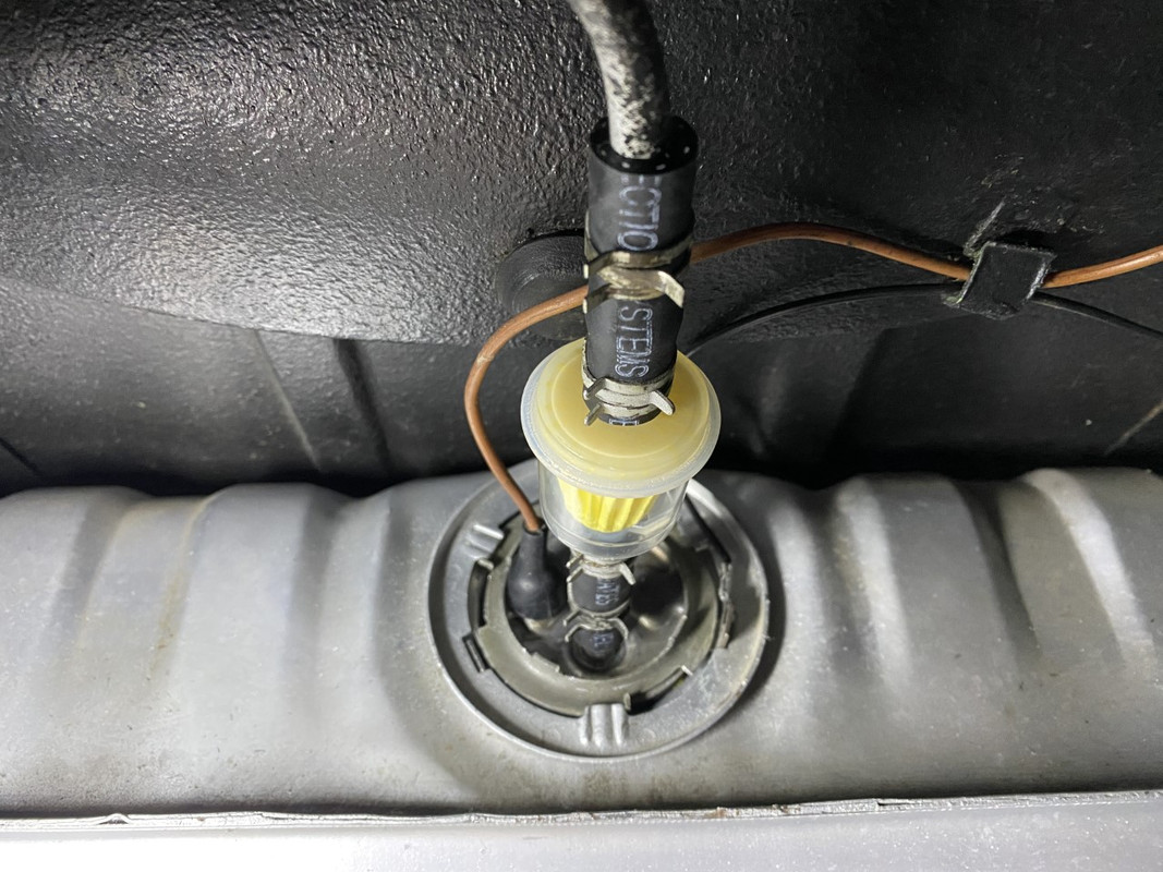

Thanks Scott, what initially crossed my mind was that it was a mold take off.
I ended up setting the gasket at 12 o-clock simply because that was a convenient place to hold it as I pressed it in place after thinly applying 3M weatherstrip adhesive to it and the tank.
It wouldn't stay in it's recess in the tank otherwise.
It was easier to get the sending unit centered on the gasket and push down on the lock ring without being bothered by the gasket moving on the tank.
I don't have a lock ring tool, so I used a plastic coupling chamfered out to fit over the tabs to push the ring down evenly to get it started, and a hammer and brass drift to turn it the rest of the way.
I'll fill a jerry can tomorrow and check for leaks.
If there's an issue, a shop can deal with it because I can't do it any better than I already did.

One other thing. I realize the sender isn't submerged in fuel but I would be careful assuming any sealant was gasoline compatible. I've not had an issue seating the seal. I use the brass drift solution as well. I try to contact as much surface of the tab as possible and then I give each tab a few taps before moving to the next. If you focus only on one the sender may want to shift off center but using a tab-by-tab approach normally keeps it centered.

There was only space to tap on 3 of the 4 lock ring tabs, but I got the ring is centered with all 3 stops seated which won't happen otherwise.
I run a little fuel filter there so I don't have to disturb that nightmare filter setup at the carb.
I don't know why they didn't have a piece of hose between instead of the hard line threading into the inlet fitting that threads into the carb.

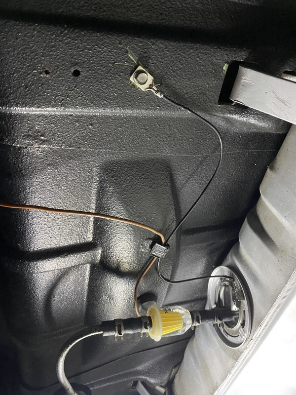

Oshawa65SS
Posts: 1219
Oshawa65SS
Loc: Grande Prairie AB & N...
Reg: 09-22-14
03-19-23 09:59 PM - Post#2855944
    In response to toro455
Good point about the POR 15 Scott.
I don't know what it is, but it's hard and not rubbery like Rhino bed liner.
Is Raptor liner a harder coating then?
Doesn't seem thick either, under the sender ground wire somebody scratched to expose metal and the scratch is shallow as seen in the pic.
Needless damage when the fastener screws into the metal smh.
