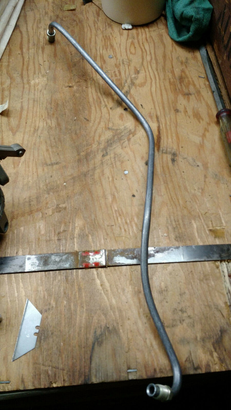

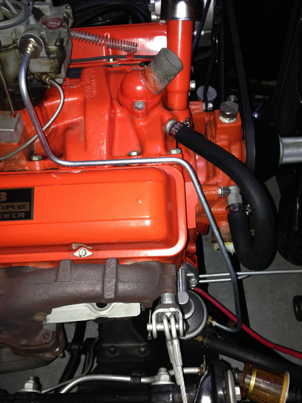

Funny you should mention copper, when that was what I replaced from the pump to the carb on my car.
I bought a stick with the fittings already on each end and bent it up to fit.
It's not touching the valve cover although it may look that way in the pic, I can slide corrugated cardboard underneath.
It's shaped like on 66 cars I believe, but I have an NOS 65 style hard line to install after I rebuild an original AC Delco pump.
Engine looks a lot different now than in that old pic.
Water pump is now rebuilt original without the top plug accommodation, fuel filter is gone, chrome oil cap is replaced with used original.
