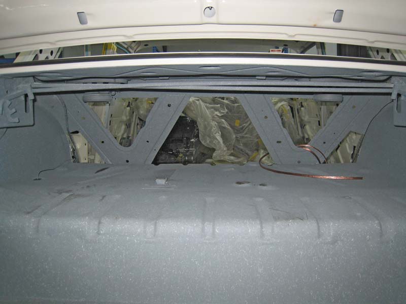

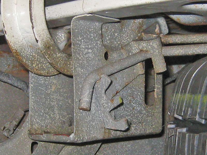

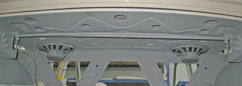

These pics are from my 64, but 63 should be the same.
- Dave

The trunk lid is held open by the energy stored in the torsion bar springs. Those torsion bar springs have slots (as in the pic) to adjust the tension. I recall in the service manual that Chevrolet had a tool for dealers that was a long extension rod to leverage the rods into their slots.
If the lid won't stay up, then either the torsion springs are not attached or are otherwise compromised.

The '63 is the same as those '64 pics.
The torsion bars do not have to be in the same 'notch'; left and right. There are six adjustment positions (not three). On my '63, both bars in the top notches (left and right) was too 'tight'; making the lid too hard to close. Lowering one side (it does not matter which side) one notch while keeping the the other side in the top notch was perfect. That's just my personal experience.

01-24-23 07:40 AM - Post#2853668
    In response to japete92
I adjusted mine with a bottle jack handle. Basically a piece of pipe that fit over the end of the torsion bar. It gives you a 'handle' and leverage to move the bar up or down a notch. I suppose a short (1-2 ft) length of galvanized pipe from the hardware store would do the trick.

    In response to dcairns
In the top picture the Left Torsion Bar Bracket appears to be cracked at the top and likely is bending down when you close the trunk.
Perhaps this has since been repaired.
