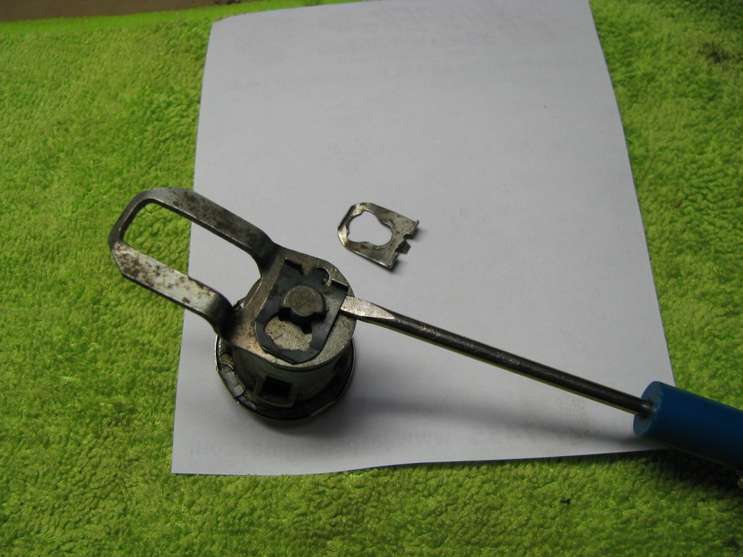

I am guessing this is the clip you are referring to?

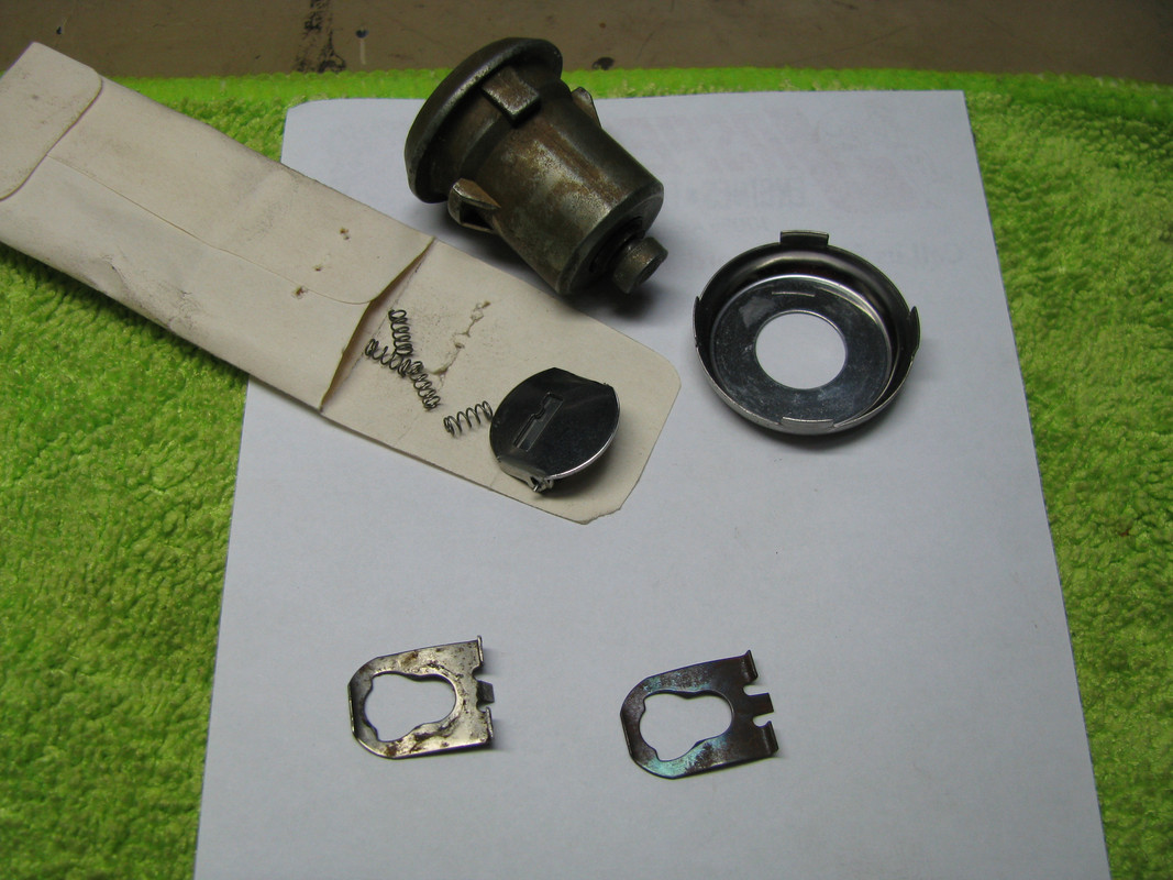

I use a small flat screwdriver and slide it in under the clip towards the bent tab keeping feature . Twist the screwdriver slightly to distort clip until the tab clears the lever hole . At this point the clip can be positioned on the lock cylinder keyed end and removed. I see that some of the clips have a aggressive bend to the tab and others just a slight bend to lock them in place. I removed the one in the picture many times to see if the clip would retain its shape and be reusable. I dont see why the clip would not be able to be removed and reinstalled on a new lock cylinder. But IF you run into problems OR dont feel like you want to trust the old clip , I can fix you up with a couple . TIM
