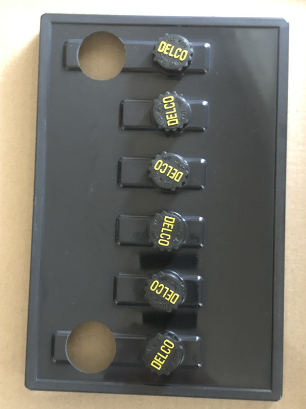

If you want a battery topper:
https://batterytoppers.com/products/
Keep in mind that your factory hold down won't accommodate the extra width.
I had to reweld the rear right angle metal piece slightly further down the rod so the clamp sits flat.
Means redoing the plasti-dip too.
The topper holes for the terminals also need to be enlarged so the topper is not resting on the raised plastic rings that surround the terminals of a battery.
Do that and it sits flush so those terminal extenders they sell are not required.
The felt washer for under the positive cable will also pass thru this enlarged hole and rest right at the base of the terminal.
Your 66 also predates the Delco Eye.

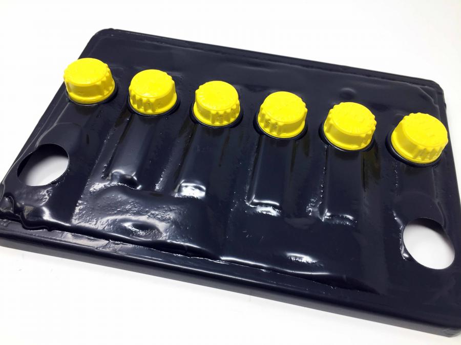

If I had to do it again, I'd just buy one of these cheap thin ones that fit the hold down without modification.
Just a matter of picking the right caps for 66.
The Legendary Topper is not randomly formed enough to look like a real tar top battery anyway.
