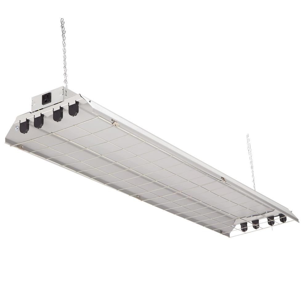

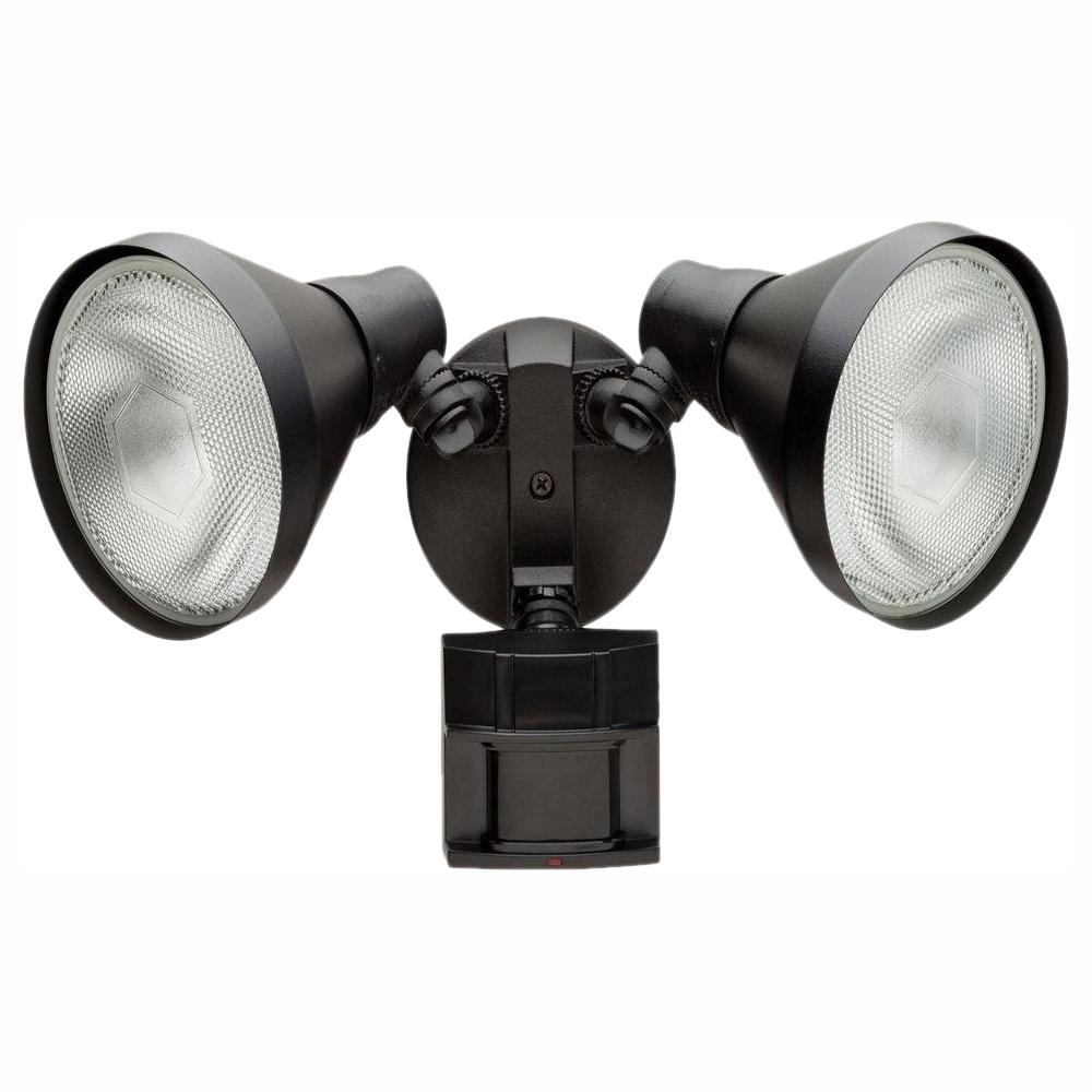

when I built my shop I installed 4ft long 4 bulb florescent fixtures about every 10 ft so on a 30x30 shop that would either be about 4 fixtures arranged in a square, or 9 arranged in three rows of three , where each fixture was 10 foot from the next one and 10 ft from any wall and I put a motion sensor dual light about every 15 ft so in your case in the center of each wall at about 8 ft height,
on my 80ft x 36 ft shop is three rows of 7 fixtures or 21 lights on the ceiling and about 8 motion lights on the walls
http://www.grumpysperformance.com/garage20.jpg
the combo of motion sensor lamps on walls and over head florescent fixtures makes the area easy to work in

I would use some lights like these.
https://www.homedepot.com/p/Commercial-Electric -2-...
Put at least 4 in a square.
When putting up ceiling lights don't just space them equally. You use 1/4 for 2 lights. I'll try to explain. When putting up 2 lights in 30' width, divide 30' by 4. You get 7.5'. Put the each light 7.5' from a wall. That way, each light will be centered in 1/2 of the shop. In other words, The left light will light up 7.5' to the left and 7.5' to the right. Same with the right light.
If you space them equally at 10', then there is more light in the middle and less light around the edges. Each light is 5' to the center and 10' to the wall. Light is not spread equally.
You can make a sketch to see figure out how they should be spaced as you add more lights.
W-L--L-W -> 2 lights, 4 dashes so divide by 4.
W-L--L--L-W -> 3 lights, 6 dashes so divide by 6, 1/6th, 3/6th, and 5/6th to lights.
W-L--L--L--L-W -> 4 lights, 8 dashes so divide by 8, 1/8th, 3/8th, 5/8th and 7/8th to lights.
etc.
If you mark them out, a quick check that you have it correct is that the distance from light to light should be double the distance from a wall to a light.
