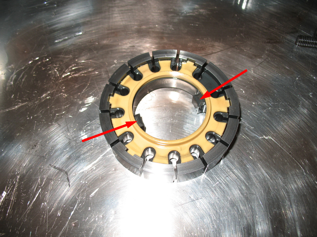

When you installed the converter onto the input/stator shafts, did you make sure the slots in the converter "snout" engaged the tabs in the pump rotor?
Not engaging the tabs will sometimes fracture the pump rotor causing a low/no fluid pressure condition - which sounds like your problem.
You can check the line pressure. Most parts places will have pressure test gauges for rent. Make sure the gauge has sufficient range. At this point, you're not so much interested in what the pressure is, just that there's pressure.
