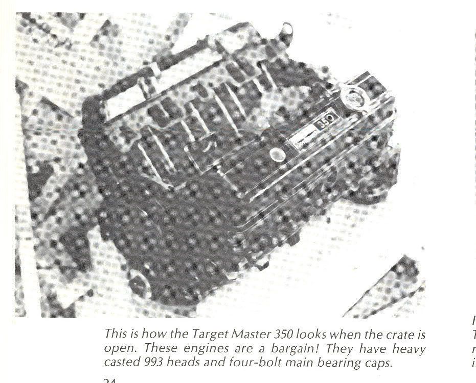

V0999800
V - Flint Made
09 - Month
9 - day
9800 - engine ID number, built for 1979 model year vehicles that had 350 engines, cars, trucks etc. One size fits all.
Its a GM parts Targermaster 350 crate engine generic replacement. It is only a serial number. There is no way to decode the horsepower of the engine. The are long blocks in that you need to reuse a lots of parts from original engine such as intake, dist, exhaust, water pump etc. see photo.
Note - Info from a 79-81 Chevy parts catalog page 20..
