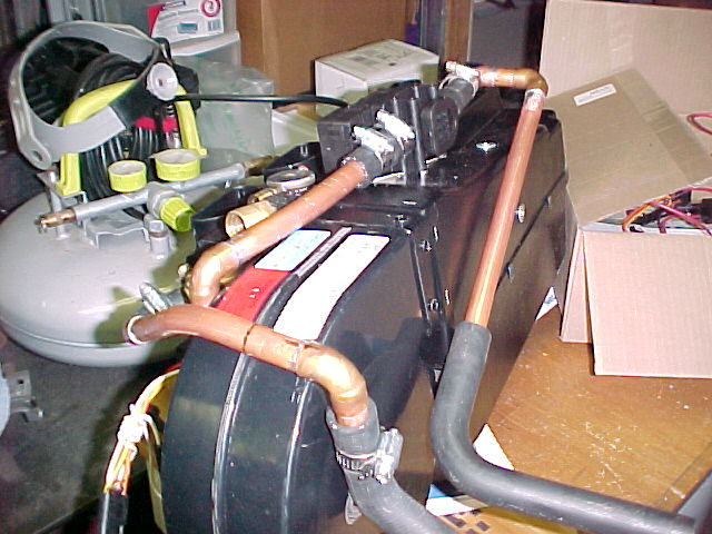

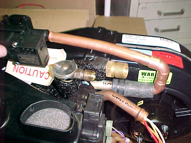

Here's a few pics of the Old Air unit in my SD.
[image][/image]
And here is a pic of the 55-59 PU controller
'38 Chevy Coupe Gasser 409 powered
'50 Sedan Delivery 401 Nailhead powered
'62 Buick Electra original survivor
Edited by lobucrod on 12-04-19 05:41 AM. Reason for edit: No reason given.

12-04-19 10:04 AM - Post#2781485
    In response to lobucrod
Thanks looks good, You said you used electronic controls in upper post, your picture looks like mechanical. Also are you running electric fan or motor driven fan? Which condenser did you use? mount in front of radiator. Wondering because I have regular motor fan with electric in front of radiator which I will have to eliminate. Have new walker radiator with built-in tranny cooler. Engine heat is 180 even in 90 degrees, Don't know if I will have to install a separate tranny cooler being I would be going to just the engine fan.
If your not the lead dog the view never changes
lobucrod
Posts: 675
Loc: Slaton, TX
Reg: 10-01-07
12-04-19 11:27 AM - Post#2781488
    In response to bolake
It is an electronic controller. No electric fan just a mechanical fan with shroud. I am using a condenser I had picked at a swap meet a while back that supposedly is for a 55-57 Chevy.
