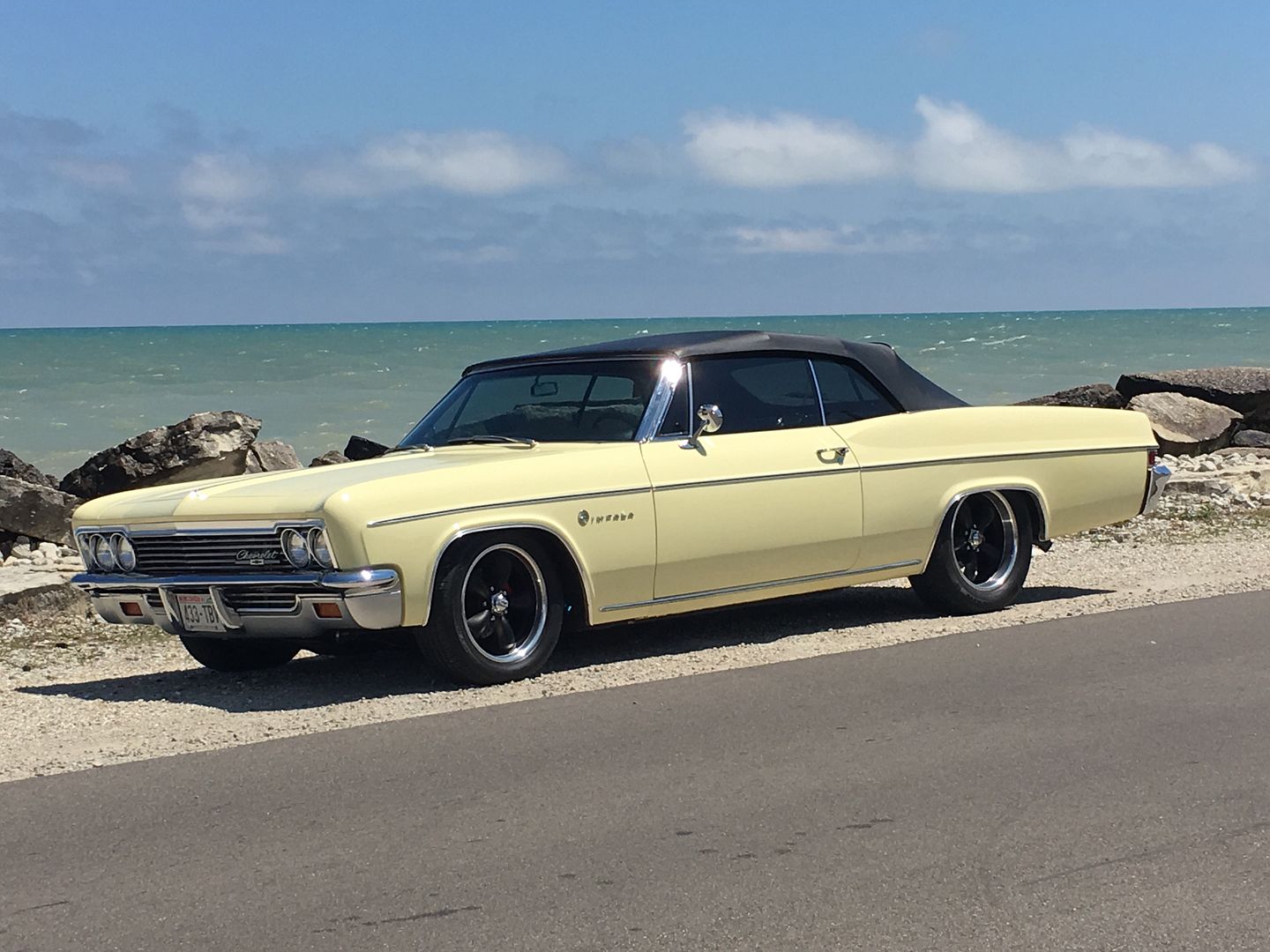

B/G wheels:
17x8 245-50-17
17x9.5 275-50-17
Attachment: 1.jpg (1.85 MB) 6 View(s)
Joe

12-04-19 08:00 PM - Post#2781516
    In response to SSvert396
Me likes.
Wow, that looks great! Is the car lowered? I like the fact that the tires aren’t super low, looks really good

12-12-19 11:56 AM - Post#2782018
    In response to 65Impala396
I have 2 inch drop spindles on the front, air shocks in the back. still has a little big/little look but also modern not too big.

12-12-19 04:13 PM - Post#2782031
Do you know the size of your springs and what brand shocks? I really like your stance. I may go a little bigger on wheels but yours looks awesome.

12-13-19 03:34 AM - Post#2782049
    In response to Bramlettjk
Thank you!....I have the original stock big block springs up front with one coil cut and CPP shocks. Stock rear springs...I set rear ride height with the air shocks LOL. Sometimes there's a canopy, chairs, cooler, and 2 more passengers in the back...... Future plans = I will eventually put coil overs at all 4 corners because while it rides fine, I have the springs inside the frame pockets with no insulator up front(squeaks occasionally over sharp bumps)and there is no rebound control with air shocks in the rear(kinda stiff). Plus I am constantly adjusting ride height due to air pressure changes/temp etc. Suspension will be next year as she is currently getting an all new top installed with glass window, exhaust, Dynamat and new carpet.
Attachment: IMG_0356.JPEG (727.17 KB) 1 View(s)
