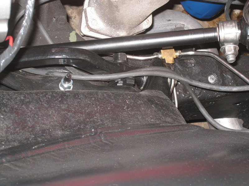

If you want to keep this one and don't know the history of it, it is probably a good idea to check the condition of things inside. This is mine after a few decades of neglect. An unhealthy mix of what was once oil,water and rust.
And after being rebuild by a local shop:
Even the stock exhaust is a tight fit, I hope those headers don't get in the way of the shaft.
