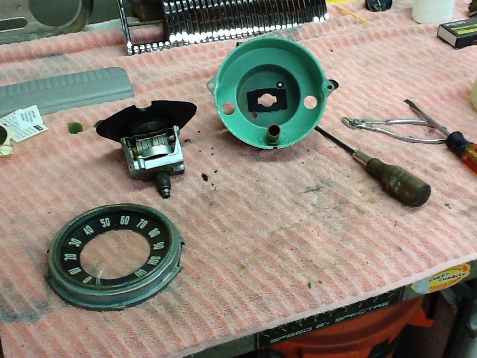

I've posted his photo before but now seems like a good time to post it again. You should also remove the brass plug and lube this area. You can use a drill bit to pry the plug out in order to reuse it. There is a fiber wick also that would have to be removed. I use a straight pin to remove it. I usually use a light oil here...3 in 1...is a good choice. After getting things moving and making sure all internal parts have been well oiled, replace the wick and plug.

It was on here I think I picked up the tip to pull the plug in order to clean and lube the bushing. That really made the speedometer spin free, like new.
