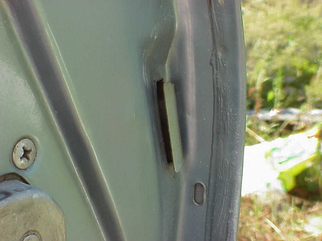

Do you have the lock retainers? Here is a picture of the door on my '62 station wagon, showing the retainer partially pulled out.

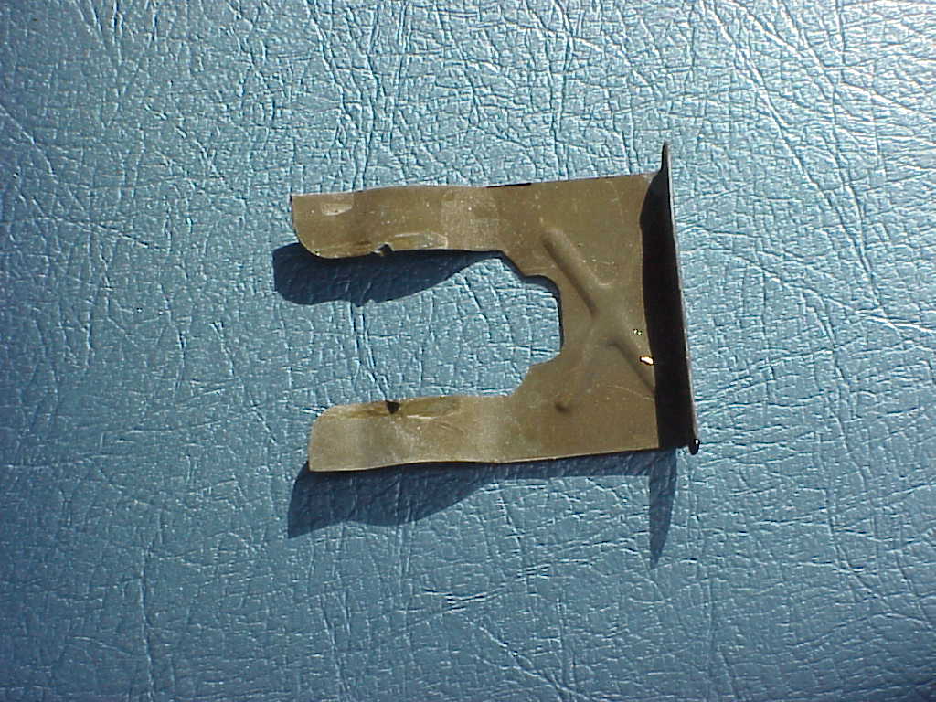

This is what the retainer looks like out of the door.
Also, the 2 door cars use a different lock rod than the 4 door cars, so what is you car? When posting questions, it is always best to tell us the particulars of your vehicle. I have a friend that might have the parts that you need, however, he asked me for the body type, and I couldn't tell him. The locks themselves are the same, and the only thing that changes on the locks themselves, is the tab on the end. Those are right and left hand specific.
