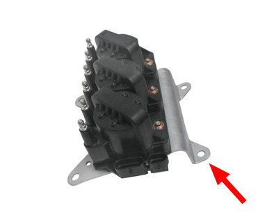

Doing a coil or module R&R on a 3.1 is a pain even when everything goes smoothly. I remove the entire coil/ignition module/bracket assembly from the engine block.
It'll be easier for you to remove that buggered up coil mounting screw if you do this too.
The only issue is the bracket mounting bolt shown below.
For some reason (IIRC, the starter is kind of in the way), it's difficult to next to impossible to see it and get a socket on it properly. I have resorted to removing just the coil that's directly under it in order to get to that bolt.
Before I bolt the assembly back onto the engine block, I make that hole a slot and partially install that bolt into the block allowing me to slide the bracket into place.
And yes, please consider replacing the module while it's on the bench.
