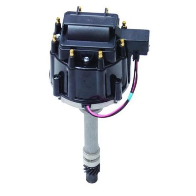

I'm going to assume your engine has a large cap HEI distributor...looks like this:
Locate the single, pink wire going into the side of the distributor cap (not the one shown in the image)
The pink wire in question is coming from the ignition switch.
The pink wire in question should have 12-volts with the key ON.
The pink wire should have 0-volts with the key OFF.
With the key OFF and the engine OFF, unplug the pink wire from the distributor. Using a volt meter or test light, probe the wire.
The meter/test light should show zero volts/light off.
