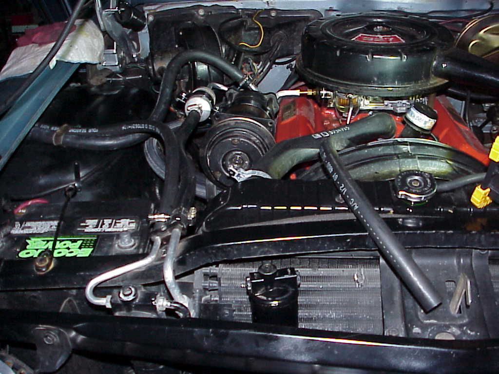

I just rehosed my 1962 BelAir, and it was amazingly easy once you get the old hoses off. To remove the old hose, you have to cut the rubber off a little at a time till you are down to the cord. Then you can carefully score the cord and pull the hose off. You have to be careful not to damage the aluminum barbed fitting, because if you do, it can cause you leaks. The new hose is what is called barrier hose, and it keeps the freon contained better than the old hoses. I would suggest that you replace all hoses, and the drier. Remove the compressor, and drain the oil and add new oil. I bought the AC Delco mineral oil from Amazon, about $15 per quart. I bought my all my hoses on eBay in 25' lengths. My '62 uses 1/2", 3/4", and 13/16". I added 11 ounces of oil to the compressor, and evacuated the system for 48 hours, and then closed the valves on the gauges, and left it for 12 hours, to verify that it held vacuum. Then I pressurized it with nitrogen and checked it again. I found that it was leaking down a little. Checked and found that it was the front seal on the compressor. This leak was caused because there was no oil in this seal, so I went ahead and charged the system. Once the compressor was working, the leak went away. I am not a believer in using R134 in place of R12 for various reasons that I don't see a need to get into. If you would like to discuss this further, I will be happy to give you my experience, just send me a PM. Junk

Where did you find your new receiver/dryer? It looks correct in the photos.
