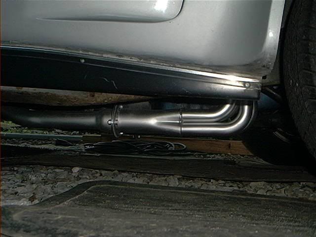

I DONT KNOW WHAT SIZE YOUR EXHAUST IS NOW. SO IF YOUR GOING TO GO DUAL EXHAUST YOUR GONA HAVE TO GO CUSTOM.THE STOCK GOES INTO A Y THEN THE CAT.OUT THE CAT INTO ANOTHER Y TO THE MUFFLERS.
AS YOU CAN SEE THE EXHAUST IS PRETTY RESTRICTIVE.
THATS WHY I WENT WITH HEADERS & CONVERTED TO DUAL EXHAUST WITH NO MUFFLERS.
[image][/image]
