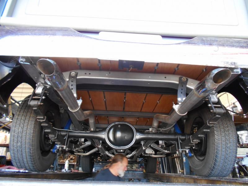

I have a very close cousin who has a 1st series 55 pickup. It's fully restored and VERY minimally modified. The engine is a 261 bored/stroked to 283. The carb is a small AFB (I don't know the size) with Fenton headers. Runs like a Swiss watch and will pull stumps.
The transmission is a 4sp Saginaw and I built a 3.08 posi for it.
Attachment: 100_1373_zpsa2a12ac9.jpg (89.23 KB) 8 View(s)
Attachment: 100_1374_zps0c51f70b.jpg (79.64 KB) 7 View(s)
Attachment: DSCN1565.JPG (2.17 MB) 7 View(s)
Attachment: DSCN1566.JPG (2.19 MB) 8 View(s)
