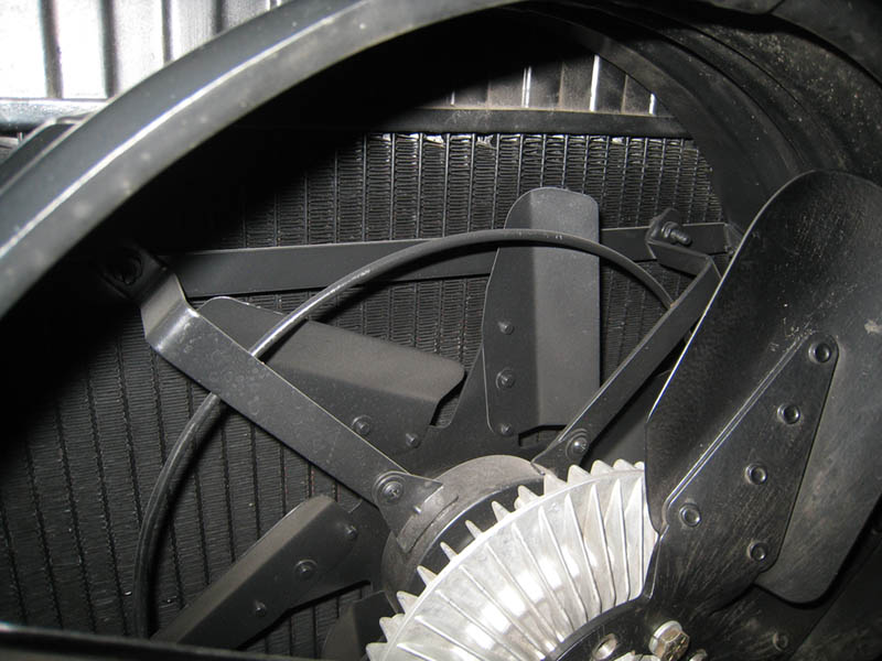

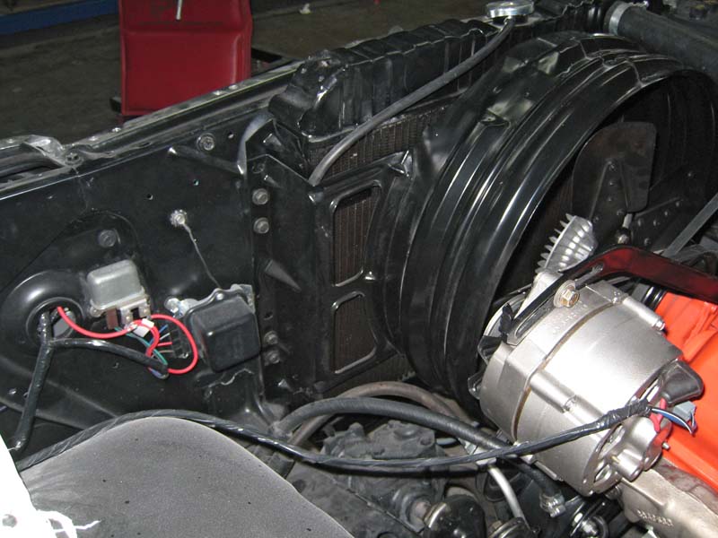

Grumpy - I do agree, it is an issue with getting enough air through the radiator when the car is moving slowly or stopped. I have a higher pitched fan from a corvette installed, and also bumped it up from 17" fan to an 18" fan, so it fits tighter in the 19" shroud. One other factor to consider, I have a 700r4 transmission running through the stock cooler in the bottom of the radiator. I would not think it generates more heat than the original Powerglide, especially when stopped.
Currently I have an electric fan helping out. Carefully hidden in the far front of the shroud and painted black, you would probably never notice it till it comes on. It slows the over heating down some, but does not stop it.
Radiator is stock for a 327/300 or 409. Has 3 rows. I had it cleaned/rodded out before installation, so it is in good condition.
You can see the gap between the shroud and radiator, this is the way it they built them and would be hard to come up with a way of sealing that without looking modified. It might be possible to disassemble the shroud by cutting out the spot welds and reassembling it with a smaller gap.
Fan positioned 'half in / half out' of the shroud.
Stock style 5 blade clutch fan. 18" fan in a 19" shroud opening. This one is from a Corvette and has a bit higher pitched than the original.
I have even tried a Heavy Duty fan clutch, which involved modifying a fan blade (mounting hole locations are different). But the fan just roared VERY LOUD under normal (normal temperatures too) driving and I could even feel it taking power away when I tried to accelerate fast.
(stock on left, HD on right)
- Dave

grumpyvette
Posts: 17382
grumpyvette
Loc: FLORIDA USA
Reg: 03-16-01
06-11-19 10:05 AM - Post#2768231
    In response to dcairns
http://garage.grumpysperformance.com/index.php?thr...
if it was my car id take very careful measurements and visit a local salvage yard looking for a compatible
or easily modified fan shroud, off a luxury car,
no one sees the fan shroud with the hood closed and 90% of the people won,t have a clue its not original,
if the hood open
hell I had a 496 BBC with a three deuce corvette intake in my 1965 lemans painted pontiac light blue,
and had 389 stickers on the valve covers and you would be amazed at the number of people,
that thought it was the original tri power 389 pontiac GTO engine
that looked similar to this picture
many full size pontiac, buick and caddys of the 1970s-1980s even 1990s had great fan shrouds,
Id bet it solve the issue and probably costs you less than $30 and a couple hours time,
keep the original parts if you ever sell the car,
but why deal with 50 year old technology when its an easily solved issue
btw some mopar big blocks came with 7 blade 20" clutch fans that can be modified to fit a chevy water pump and do a great deal better at providing air flow
most salvage yards will sell you those reasonably (under $60)

65_Impala
Posts: 4241
Reg: 12-29-02
06-11-19 06:30 PM - Post#2768263
The shroud is terrible. Not sealed to the rad, doesn't draw air from the sides of the rad, too big for the fan diameter and the fan is too far into the shroud.
You may have to give up some of the original look and use different shroud. I don't see another easy solution besides building a sheetmetal shroud that looks original but checks all the want boxes.

In looking at your pictures, I can't help but wonder if sealing the shroud would help pull more air.
The gaping holes on each side of the bracket, and the gap between the radiator and shroud will let a LOT of air get sucked in behind the radiator, not through it.
I stuck a 455 Buick into a 83 Regal in place of a 231 V-6. I used the factory radiator with the shortened fan shroud. I had some heating issues, but cured them when I put some foam insulation between the shroud and the radiator. It ran warm, but never got really hot. I live in Corpus Christi, so I have heat. Like heat index yesterday of 116!
It would be a cheap fix if it worked.
Griff

scrambldcj8- The problem with over heating predates the electric fan. The electric fan no doubt is a bit of obstruction when it is not on, but when the electric fan is on, it does help a bit.
Also I have an 18" fan in a 19" shroud. That is about as tight as you want to get as it only leaves 1/2 inch to spare between the fan and shroud given engine movement when operating.
The link to the info on setting the fan clutch temperature settings did not make it through. That might be interesting info.
I am kinda stuck to keeping the existing shroud. I went through a lot of trouble to make/keep this original looking. I even got a near perfect score at a judged event (the judges didn't look carefully enough under the car to detect the 700r4 vs powerglide (they both have squarish pans )
A few years ago, I did try putting some foam around the gaps and also tried some tape on parts of the shroud, however it just got blown off as I drove. I should see what I can do with the shroud. I went out and looked at the shroud some more, and I can see where I might be able to make a metal strip curved around the inside of the shroud. I also notice there is some room for the radiator core to be thicker. Perhaps a thicker radiator core might effectively bring the core closer to the shroud as well adding some more cooling capacity.
I think I will give another go at trying to close the gaps on the shroud. As mentioned, it is cheaper if it works.
