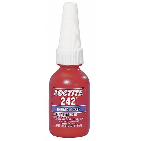

under the bolt head over the washer
loc-tite on threads certainly wont hurt
but I generally use thread sealer on the threads and it works fine

"under the bolt head over the washer
loc-tite on threads certainly wont hurt"
Thanks so much Grumpy. I'll give that a try. I used anti-seize when installing the intake bolts so Loc Tite probably wouldn't stick but I'll give the star washers a try.
