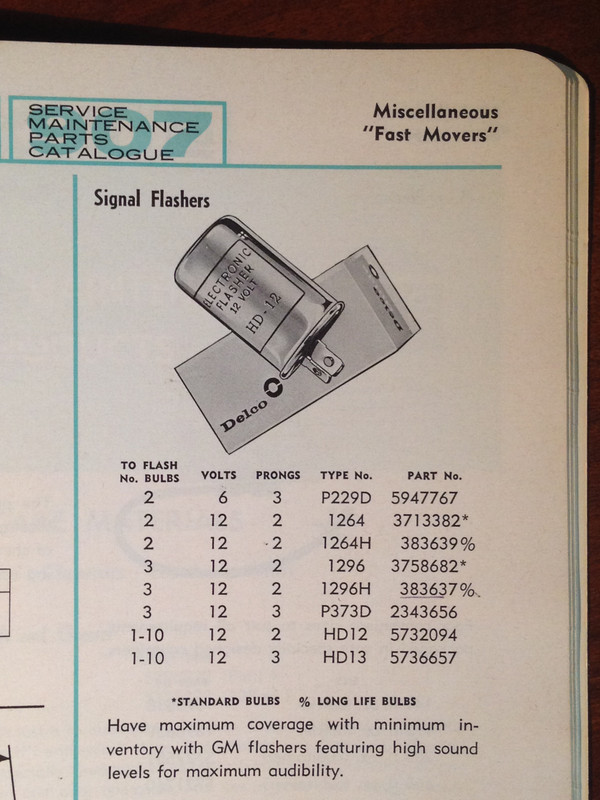

Just as an aside, here's the Dec. 64 Canadian catalog group 2.892 page showing a note to refer to the 907 catalog for flasher part numbers:
http://www.gmpartswiki.com/getpage?pageid=7835
I can't find the 907 catalog on line so here's a pic of mine dated May 65:
Good numbers for Canadian Impala would be the 1296H/383637 which also appears in the US catalog and HD12/5732094 which is not in the US catalog.
A Delco flasher is pictured so it seems that was what the dealer stocked in Canada, although in addition to Delco, I see US GM boxes with Tung Sol and Signal Stat flashers.
