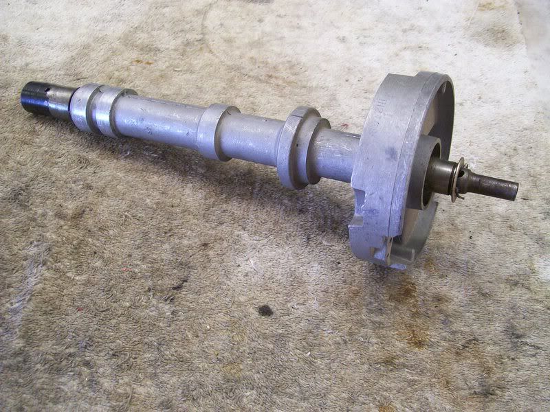

If it were my engine (and it is not), and had sat for 10yrs as in the condition as described, I would pull the plugs, fill the pan with oil, squirt plenty of oil through the plug holes, remove the distributor (if a distributor is in) and use something to spin the oil pump over and over and over, as you occasionally rotate the crankshaft 90deg.
This is what I use, with a drill, for turning an oil pump shaft. I made it from an old Chevy distributor. I've picked up several old distributors at swap meets for free to $5.

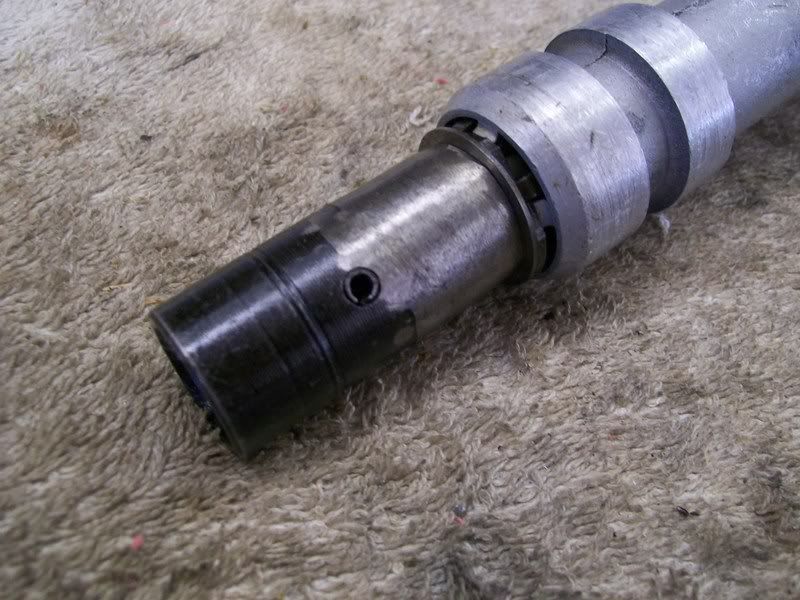

Since this is in the '49 to '54 forum, I'll post this picture of a dist. I modified to spin the oil pump. I drove the pin out of the gear on the bottom of the shaft, removed the gear and took off everything above the plate. I can just barely chuck up the end of the shaft in a close-quarter drill and spin it. I think I'll extend the shaft tho, by welding a bolt onto it so I can chuck it up easier.

Nice but I am a simple person and just cut the shaft of an old screw driver near its handle, chuck it in the drill and it works fine.

I know... I know. But I had a few extra distributors laying around and couldn't help but fiddle with this one.
Why not just take an angle grinder to the housing and cut it off above the breaker plate; unless maybe you still want to keep that "distributor". I had bought one of those engine (V-8) pre-lubers, mostly made of aluminum, and it basically did't survive the first use; it just wore itself out and I had to check everything out to make sure no aluminum particles had gone down into the engine (did't). So, I have an old distributor also, looks terrible, but it works. I am Butch/56sedandelivery.

Looks like a drill bit extension might fit that shaft, lot less work.
