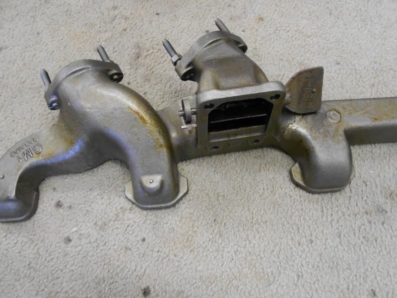

There is a lot of stuff that I have forgotten about these early drive lines because I switched (WHICH I GREATLY REGRET NOW!!!!) from a 6cyl to a V8 in 67. My last 6cyl was a 261 truck engine with the Corvette 3carb/dual exhaust setup. I would NEVER have one of those Corvette 3carb setups again, BUT, I would like to have a nice 2carb/Corvette dual exhaust setup on a 261 (bored/stroked to 283) on a 51-52 again (I still have the Corvette exhaust manifold).
