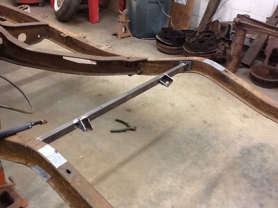

eplantage
Posts: 2171
Loc: Southern MN
Reg: 03-15-04
01-04-19 05:48 AM - Post#2756541
    In response to 49betty
It involves adding a crossmember between the frame side rails to attach the top of shock absorbers to rather than the factory floor mount.

Oh yes, I remember reading about that in these posts somewhere. Thanks. Would it be possible for you to direct me to a picture of that cross member. No worries if you cant. I don't have the computer talents to deal with pictures.

01-04-19 08:28 AM - Post#2756547
here is an example from 40grit's 53 convertible build.

Forgive me for being so vain but I just had to update that picture of my shock crossmember.

01-04-19 06:35 PM - Post#2756583
    In response to drew1987
Thanks for the picture of the cross member and all the ideas. I think I can locate a later steering box so I may try that. How does the shock absorber cross member improve the car. Must be an obvious answer that I cant see. I wish I had found this forum earlier. There is a ton of good information among all you guys. Thanks again.

01-04-19 06:56 PM - Post#2756586
Three things actually.
First, The crossmember removes the vibration being transferred to the body floors and isolates it somewhat in the chassis.
Secondly, most early Chevy's have the shock mounts cracked out. The sheet metal mounts would work harden and crack out over time.
Thirdly, a properly built crossmember will not flex as much and will enable the shock to better function.
