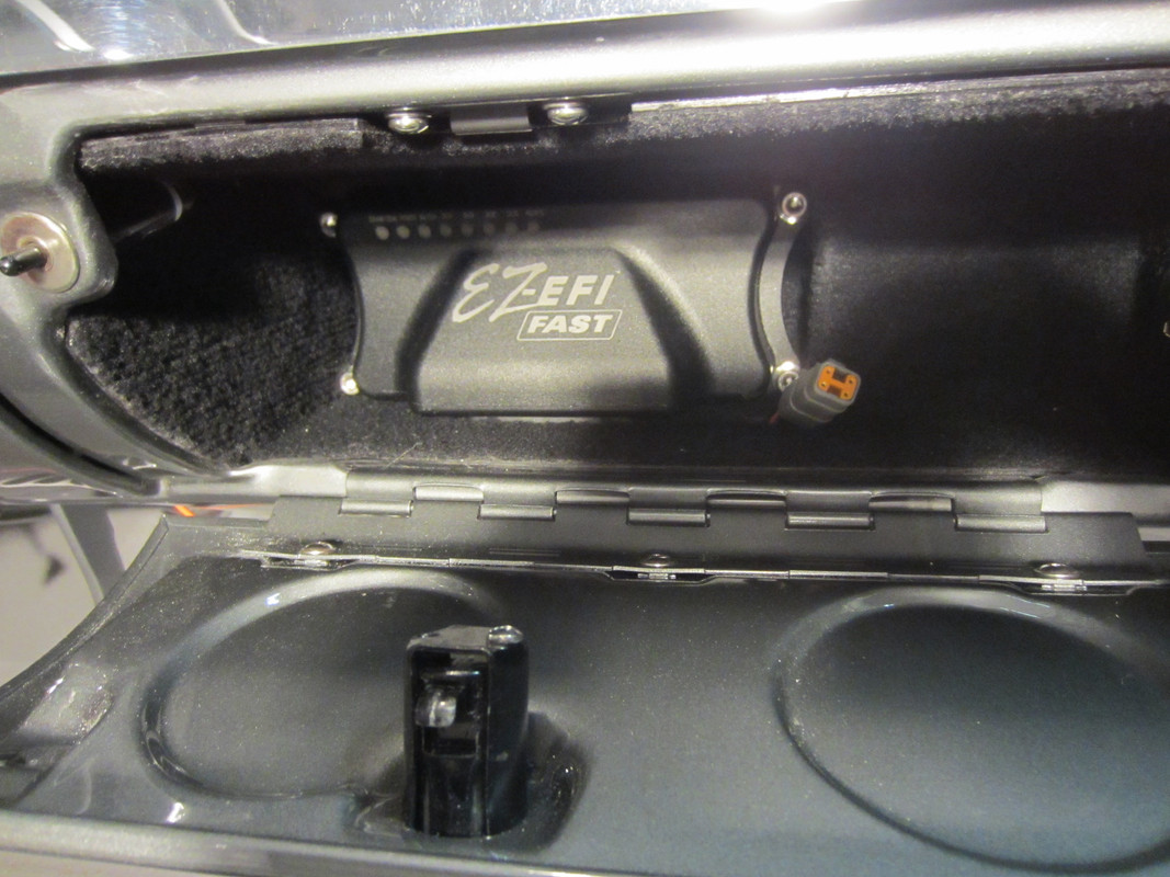

www.classictruckconsoles.com their Cruiser Model heavily modified
[image][/image]
Made my own glove box out of 1/8" ABS Plastic sheet
http://s2.photobucket.com/albums/y40/asbicca/55 %20...

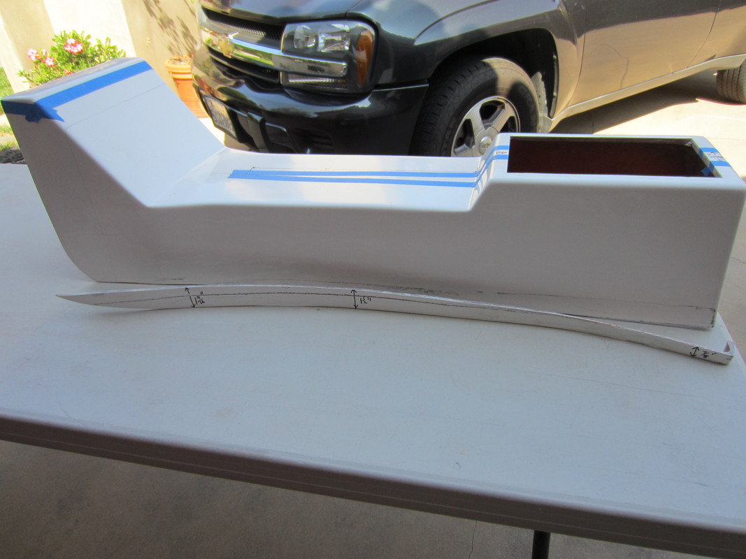

Made my own console with glove box in it and used a Cadallic shifter.
Gauges weren't installed yet in these pictures.

TR56210
Posts: 67
Reg: 10-28-18
12-14-18 11:19 PM - Post#2754554
    In response to acardon
Thanks for responding. I will visit the website.
Arcadian, I do have extra black leather hide....so can you walk me thru basics, materials used etc. I really like the natural curve you made.
I assume once seats are mounted I take critical measurements, length width height etc. Then, make cardboard mock up to refine.
What material did you use for the structure, thin sheet metal, wood, fiberglass? I assume you added 1/4 or 1/2 padding under your red leather.
You got me excited to finish the wire harness!!

12-15-18 07:33 AM - Post#2754568
    In response to TR56210
I used wood and fiberglass and body filler. The upholstery is glued directly on the console.

12-15-18 03:40 PM - Post#2754607
Thanks again. The classic truck console web had some great measurements as a starting point. I really like the curve you made and will incorporate in mine. Uncle has deep fiberglass background so likely will go that way first, and include him in project.
In the upper part of the console where the gages will reside, I want to bias or point the gages toward the driver to aid visibility. In your opinion, is gage visibility an issue with a flat console, or am I over thinking this? And who would ever think that a phone charger port would become a must have feature in a tri five....

12-16-18 10:12 AM - Post#2754674
I don't think it's necessary to tilt the gauges. Your far enough away from the gauges to see all the gauge. Although it wouldn't be hard to tilt them. As you see, I recessed the gauges a little. You could drill the holes at an angle and counter sink them at the same angle.

12-16-18 05:39 PM - Post#2754728
Over football this afternoon, my uncle convinced me that building a reverse mold for fiberglass console was much tougher than going with wood as you did. So, mock up in cardboard then get the saws and sanders out.
