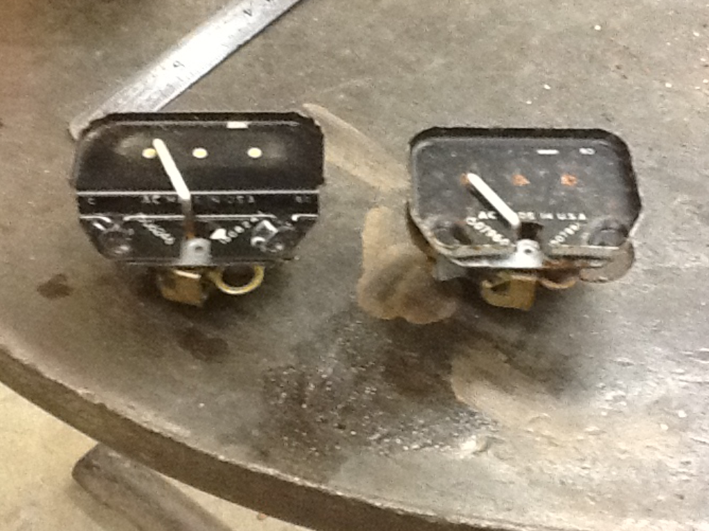

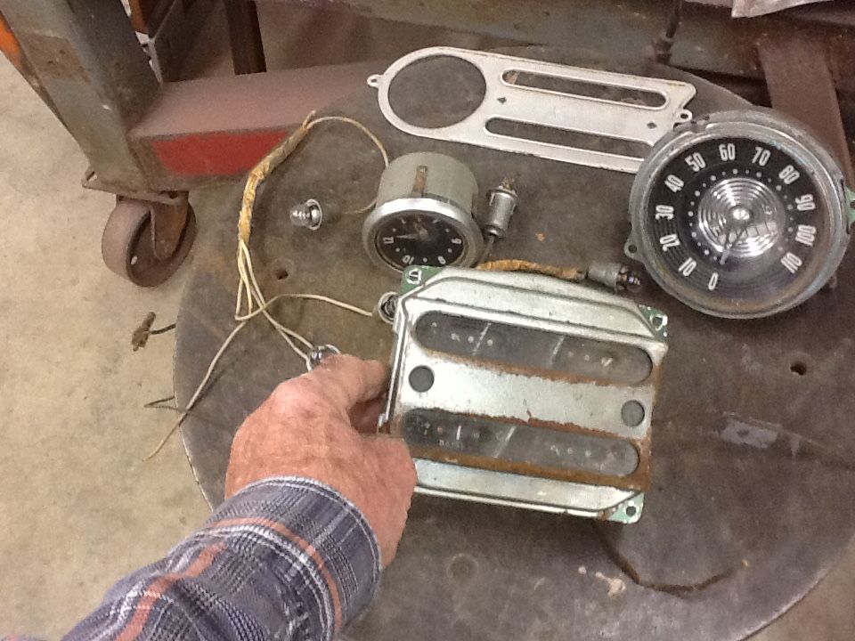

One of the interesting modifications I have done to my 53 rag top is converting the instruments to 12 volt by using 58 C10 pick up gauges. Not only did the truck use 12 volt gauges but it also uses an electric temperature gauge. I thought they would almost be a bolt in since the looked so similar but not quite so.
I started with my really rusty instrument cluster and this one from my parts car which was not so bad.
My truck gauges came from Ebay. I think I gave 45 bucks for the truck cluster, sold the speedo and chrome bezel for 35 leaving me the 4 gauges for 10 bucks.

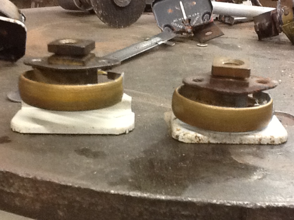

Here is what made it more challenging than I expected. The truck gauges are 3/16" deeper than the 53-54 gauges. The electric temp gauge is more like 3/8" deeper.
So here you see the challenge. I will post this and work on the next post showing how I chose to deal with it.

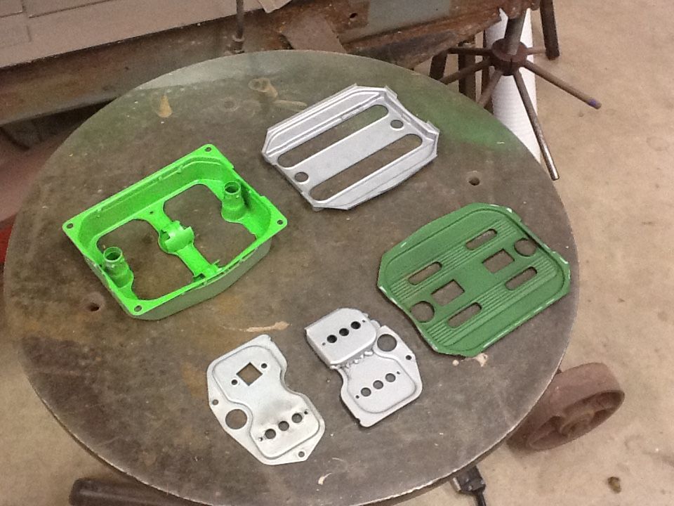

It seamed to me it would be better to modify the housing rather than try to modify the gauges. If one of the gauges fails, I would like to e able to just install a new gauge and not ha e to worry about modifying it to fit.

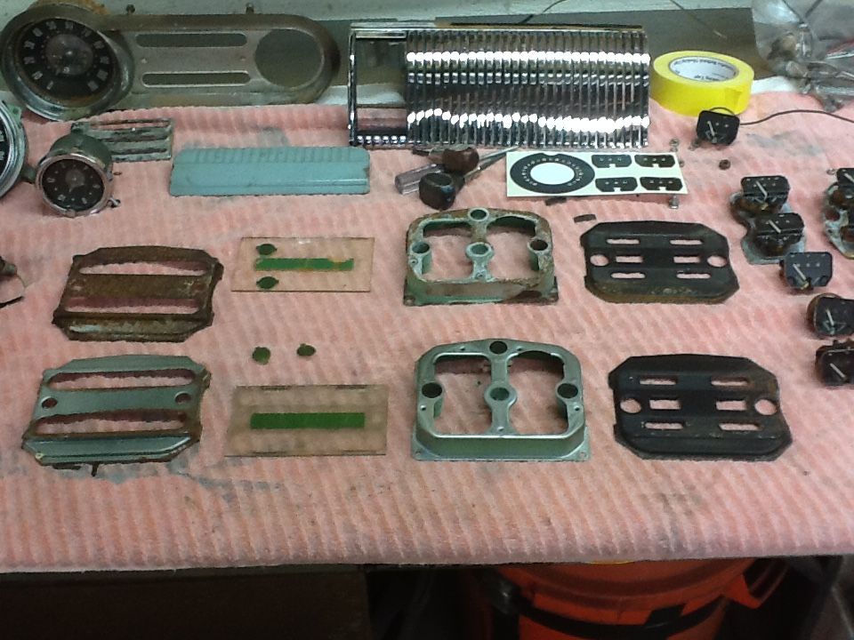

The housing comes apart simply by uncrimping the bezel. here you see the two housings taken apart and laid out on the work bench.

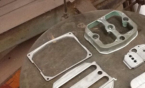

My solution was to cut the lip off one housing and cut 3/16" off the second housing. These were welded together resulting in one housing that was 3/16" deeper than stock.
Here are the two pieces laid out.
You can see the flange ready to be joined to the other housing.
Here is the new housing after the teo pieces are mated to each other. Look closely and you can see the seam.
The next item to deal with was the temp gauge which was deeper than the other things.
I will be back with another post on how I mounted the temp gauge next.

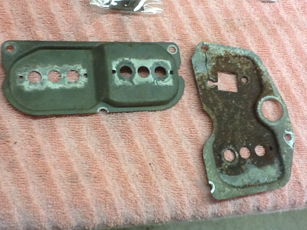

The mounting plate on the left is what the truck gauges used. They were mounted side by side above the speedo in the truck. The 53 gauges mount over and under as seen looking at the plate on the right. Notice the pocket on the left hand truck mounting plate.

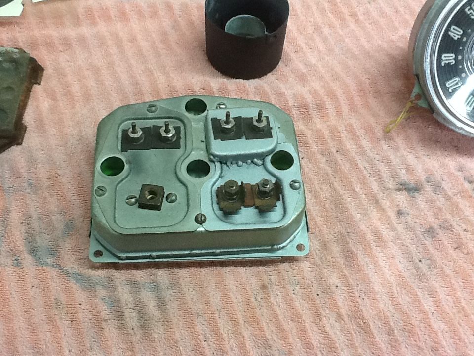

The solution to mounting the temp gauge was simply to cut that pocket out and weld it into the 53 mounting plate. You can see here how I mocked it up.

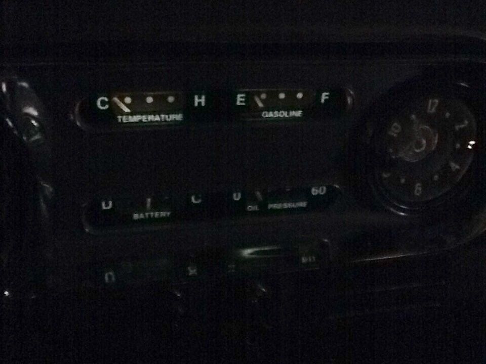

What was left was to put new decals on the gauge faces ($9.95) paint the housing, buy new instrument cluster lense ($30 from Chevy's of the 40's) and paint the black mask.
This leaves you with what appears to be a brand new stock instument cluster for somewhere around 70 bucks.
So there you have it. One of those modifications no one will ever know you did......unless you tell them.
I hope this helps someone out there who is looking for a gauge solution. Even if it makes them decide against this method, at least it has given them the knowledge to base their decision on. Personally, I enjoyed it and would definitely do it again.
