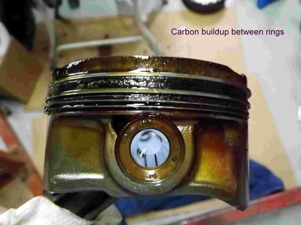

This is just one of the many bulletins they put out on oil use for 2007-13 AFM engines. Typically with oil consumption like you mentioned, its too late as the piston(s) looks like the one below and the only solution is new pistons and rings; provided the cylinders are not damaged.
Oil Use in 5.3L AFM engines
This condition may be caused by two conditions. Oil pulled through the PCV system or oil spray that is discharged from the AFM pressure relief valve within the crankcase.
Under most driving conditions and drive cycles, the discharged oil does not cause a problem. Under certain drive cycles (extended high engine speed operation), in combination with parts at the high end of their tolerance specification, the oil spray quantity may be more than usual, resulting in excessive deposit formation in the piston ring grooves, causing increased oil consumption and cracked or fouled spark plugs (#1 and/or #7). Refer to the latest version of Corporate Bulletin Number 120601001
Carbon buildup on pistons can cause the piston rings to stick in their grooves. Stuck rings can fail to seal the combustion chamber, leading to oil consumption and low compression, negatively affecting engine performance. Excess piston deposits can also lead to pre-ignition (pinging) and engine knocking, which results in lost power, reduced fuel economy and, in severe cases, engine damage. GM came out with new tougher dexos oil specifications in circa 2013 to combat this problem. It basically required oils to have lower volatility rates, aka less evaporation.
This is what the piston in the affected cylinder(s) can look like in extreme cases.
Circa 2013 GM came out with tougher oil specifications (dexos) to try to reduce oil consumption. Basically dexos lowered the acceptable volatility rate (evaporation) of engine oils from 15% to 13% max., among other improvements in oil quality.

What is wrong with GM that they cannot test an engine under normal driving conditions so that these things don't happen? Before AFM, these trucks would last forever.
So, looks like I need a new short block. Nice.
