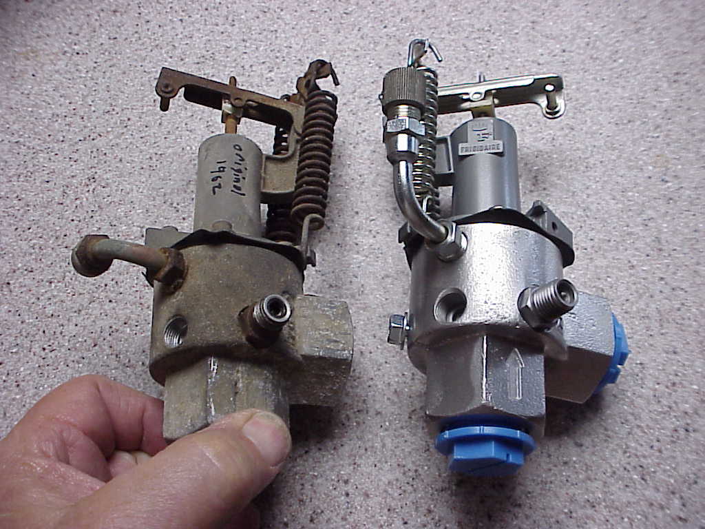

Today, in anticipation of installing all the reconditioned A/C parts that I had done a while ago, I removed the hood hinge, hinge box, and the front right tire. With all that out of the way I was able to get to all the bolts and screws. Due to some missing hardware, I could see that someone had their hands in there before.
Got the old A/C box out, and cleaned it with simple green, and blew out all the pine needles, leaves, and other debris. With everything cleaned, it was time to start reassembling with all the new parts. I got out the Throttle Suctioning Valve, only to find that when it was restored, they reassembled in up side down. Called the vendor, and was told to send pictures, and to mail it back to them for "repair". Looks like it will be another week to 10 days before I will be able to complete this project.

Looks like the top half needs to be clocked 180 degrees.

08-03-18 12:05 PM - Post#2741880
    In response to Carl1962
That is it exactly. I asked if it could be done in the field, and was told that there are springs inside that are difficult to set properly, and it would be best to send it back to them. With any luck, I will get it back next week.
