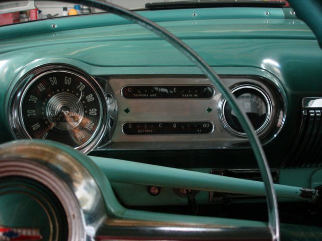

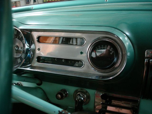

I removed my dash clock and fit a tachometer in a 54 clock housing I bought on ebay.

It is from Westach Mfg.model #2CT33-6V.This model is for a 6 volt system which I still have but they also sell tach`s for 12 volt systems too.This model is a 2 inch tach,I had to make a ring out of thin wood to fill the clock bezel opening slightly.
