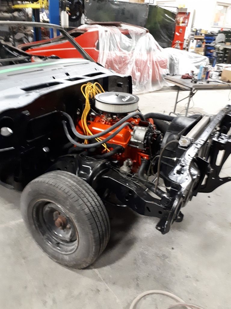

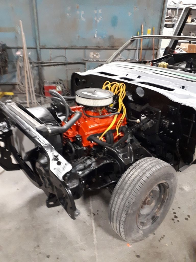

Well we got the engine/trans back together and in the frame,
Engine day on the weekend lol!
Engine getting mated up to the trans,
Frame got blasted and epoxied/urethane topcoat,
Going back together,
And the frame bolted back up to the body for the final time,
