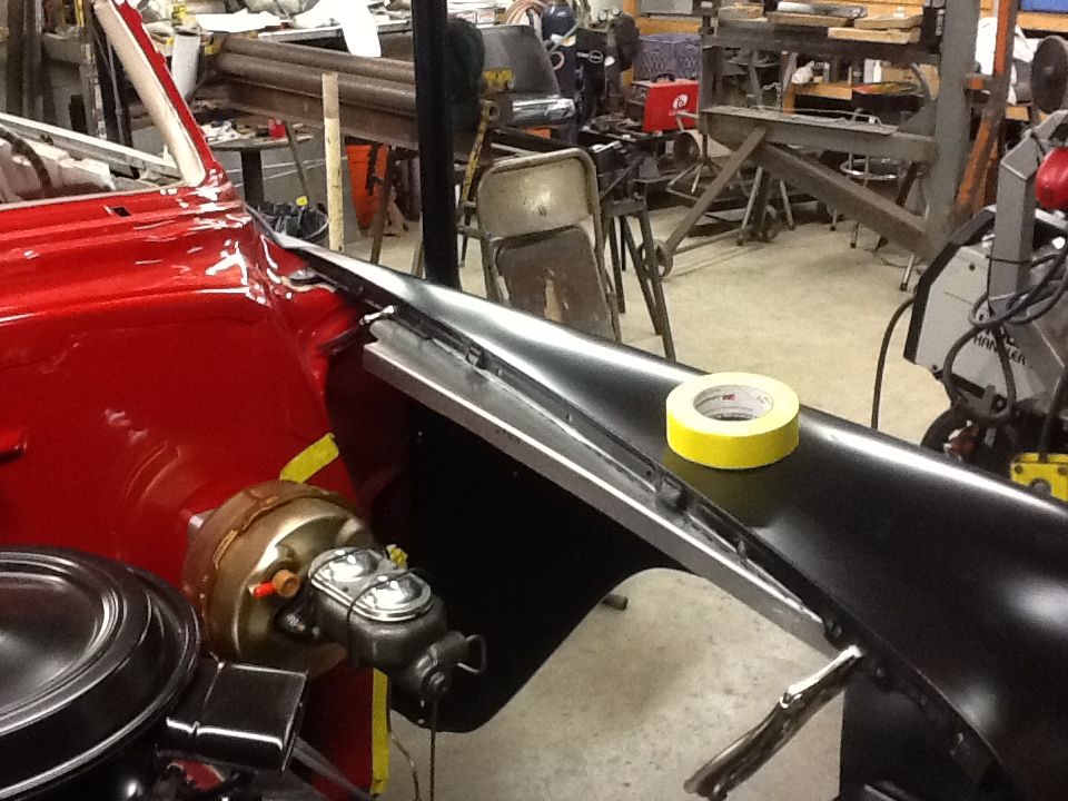

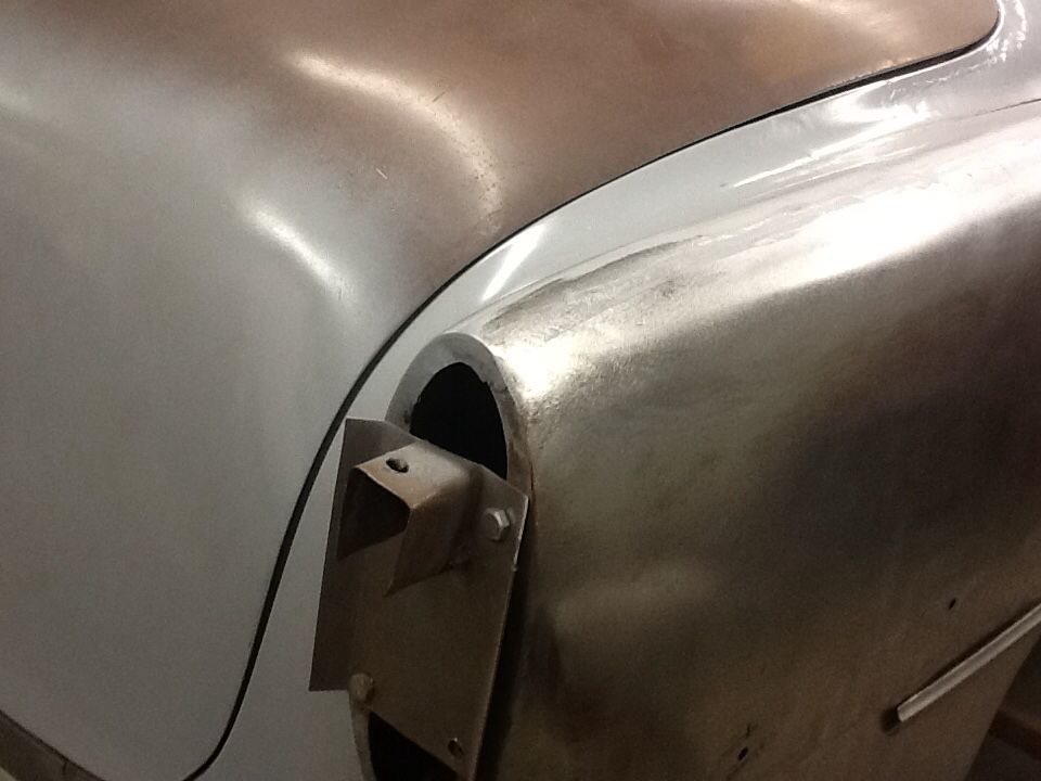

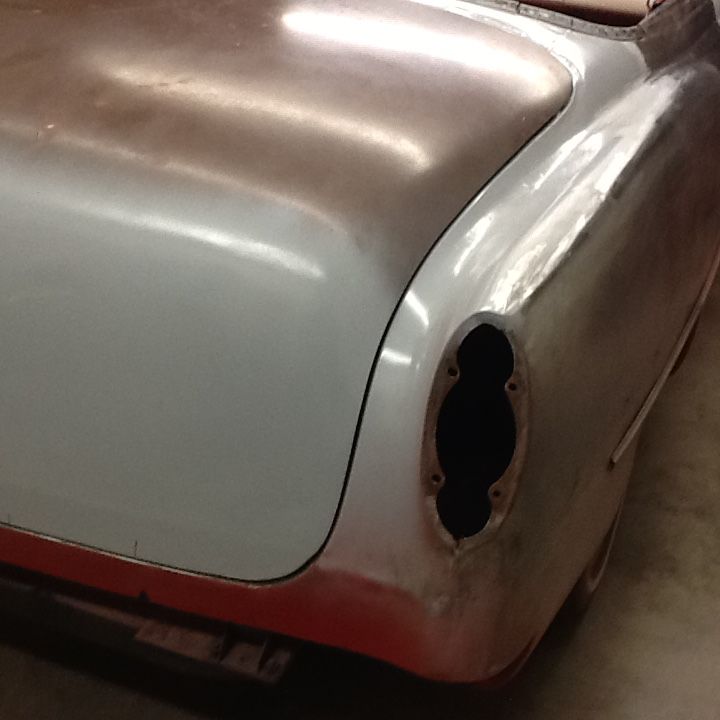

Thanks. I don't claim to be a bodyman. The gap should have been addressed before I replaced the bad metal in the quarter and tail pan.
Sometimes we are our own worst enemy.
This is where I made my biggest mistake. With all the rear of the car rebuilt, I had not opened up this gap to where it needed to be.
This series of Chevy is frequently a challenge for panel fit. It was exciting to be getting it worked out.

So John, question for you. Is there a rule of thumb when adjusting gaps, whether it's a trunk lid, doors, etc., do you modify the lid itself or the body itself? I guess that each scenario would be different. Thanks, beautiful work.
In this case the body was definitely the problem but in most cases it is the door or lid that would be modified because it is easier to grind off or weld on to the edge.
I have run a cutoff disc down a quarter panel 1/4" behind the door jam and welded it back to open up a door gap though.
The biggest thing is just not to be intimidated and do what you need to do. 3/16" or about the thickness of a stir stick works pretty well but I would rather my gap be slightly big as to push my luck and end up with a door, deck lid, or trunk chipping paint.

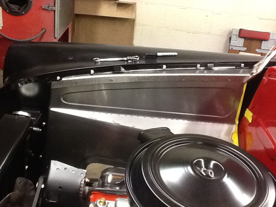

I have started fabricating the inner fenders last week. These are roughed in with some light 22 ga junk metal. Once the details are worked out they will be transferred to some heavier 18 ga and some detail added with the bead roller.

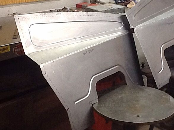

I was going to wait to post pictures when I got them mounted on the car but here is where I'm at. My wife's health does not let me spend much time in the shop these days.
The earlier picture was templates made out of light 22ga stock. Here are the 18ga actual panels taking shape. You are correct. Splash shields behind the wheels are next. They not only offer protection but the rear of the inner fender ties into them for support.
I have thought a lot about air flow. The inner fenders do not go all the way to the firewall and I am leaving the area open around the body mounts. Also, the subframe is quite a bit wider than the origional frame. All in all, I think I have left it open enough for good air flow. If I have to do anything more, it will be add a shroud behind the radiator. That would not surprise me at all.

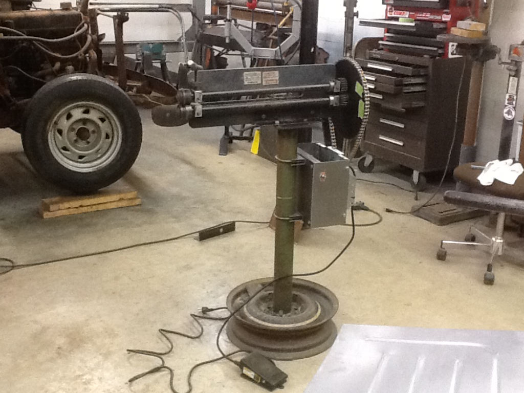

Like the panels and bead work, John! I have plans for some panels & bead roller work, but I need to wait until I motorize my roller. That crank just ain't working out.
I motorized mine with a $35 dollar used garage door motor Tommy. I will try to post a picture of what I did later today. The variable speed 1/2 hp drill motor is a good method also.

Here you go Tommy. $35 bucks for drive, 12 for pedal at Harbor Freight, 5 bucks for chain. The sprocket was the most difficult. It is a 55 tooth. I think I ended up paying somewhere aroun $50 for it. Anything smaller though and it would run too fast.
Cheap and dirty but works amazingly well.

Thanks for the pictures, John. I've been looking at drive idea's for a year, but I've reached that point where I'm just going to spend the bucks and buy the drive unit from Eastwood. Kat, the CFO, has a shop fund for me buying tools, so I'm going to dip into it. I think there's a new Miller tig welder on the list, too!
