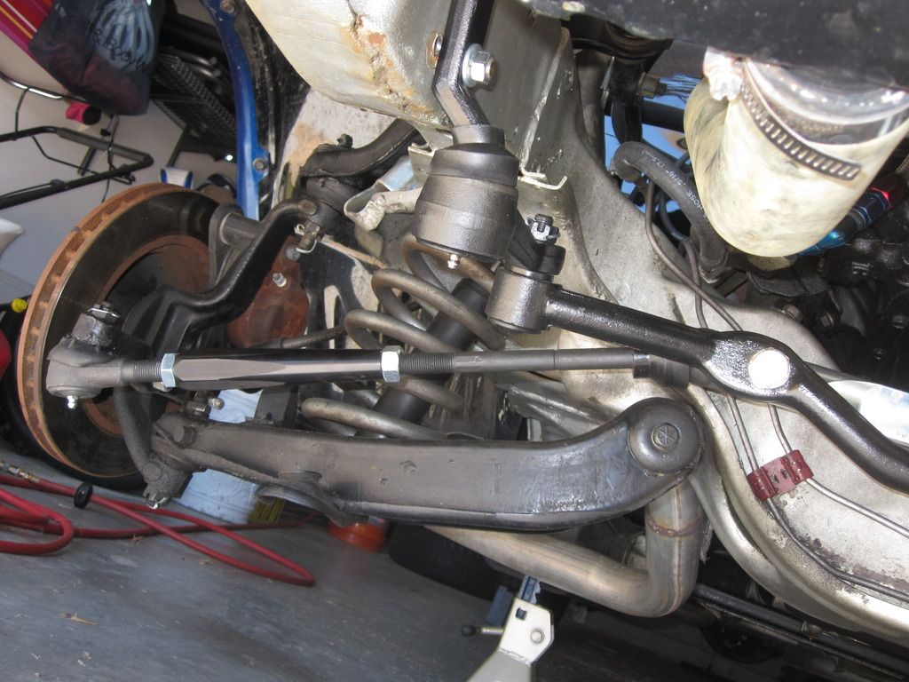

I thought I would do a write up on Global West's Power Steering Conversion and Bump Steer kit. There is not much on the subject and I know there are a few people who have bought the kit but have not installed it yet. Hopefully this will help out others interested in purchasing the product or deciding whether or not to try and install it themselves.
Two years ago I bought the Power Steering Conversion kit from Borgeson. I installed that myself but was not thrilled with the results. The car wandered all over the road and felt unsafe, especailly at 45+ mph. After hearing about this kit, I knew I wanted to go this route and hopefully get the quality ride I was expecting from the Borgeson Conversion.
So I bought the bump steer kit from Global West minus the steering box. My write up will start from this perspective as there are a couple steps I had to do that people buying the steering box with their kit will not have to do. I also did this install on my back with the car on jack stands.
I want to point out that the instructions are not the best. I will point out a couple of issues with the instructions that will save you some time trying to figure out what the heck they are talking about. Before I did anything, I took a paint pen and marked the steering gear box and spline so I knew where they matched up again. I also strapped the steering wheel in place so it wouldn't move. This might be overkill but it was easy to do and I didn't have to worry about anything moving.
Take off your old idler arm, center drag link, inner and outter tie rods, and sway bar/end links.
My comments on the provided instructions with the kit:
Step 1 of instructions: No problems here, very straight forward and accuarte.

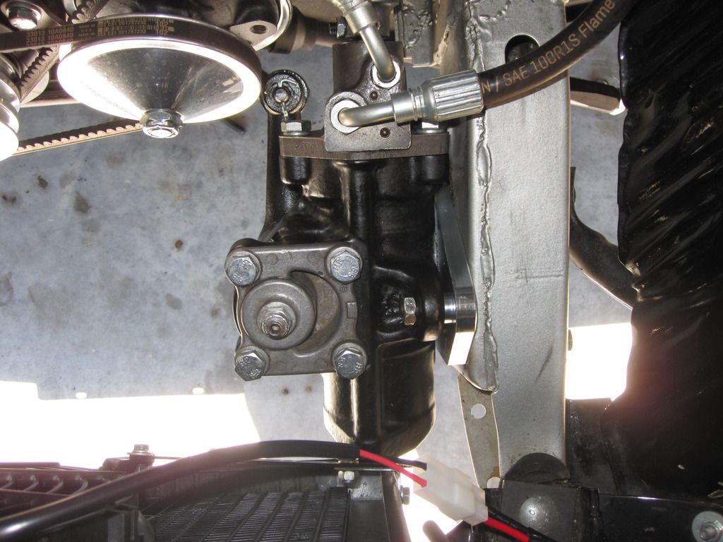

Step 2 of instructions: This is where I ran into multiple issues. First, I had to remove the adapter from my box so I could put on the new adapter. The new adapter changes the angle of the box substantially. If you already have the Borgeson box installed, you will have to swap the box adapter plates. The installed adapter plate was on really tight, so tight I had to use my air impact wrench to remove the bolts. Careful not to mess up the bolts because you have to re-use them (not mentioned in the instructions). You will be re-useing two of the three adapter plate bolts you took off. The other bolt you will use from the kit as it is specifically designed for the new adapter plate. The two bolts you re-use go on the bottom two holes of the adapter and the new bolt goes on top. The top bolt hole is recessed to fit the new bolt. You will sandwich the 3 provided spacers between the box and the frame.

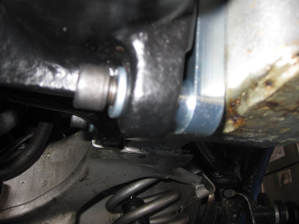

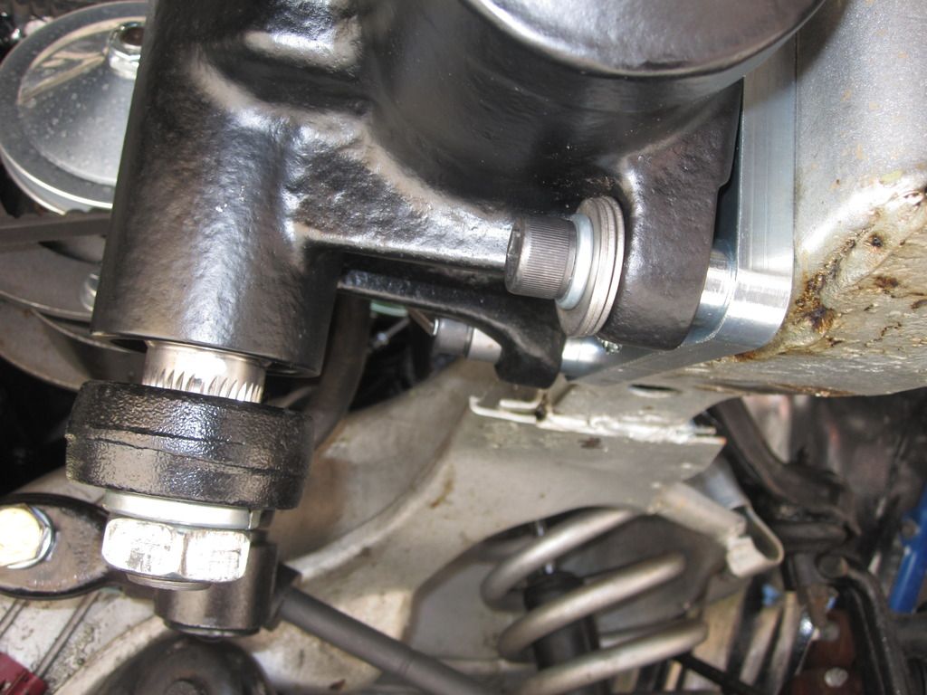

My first problem was the old bolts where about 1/4 to long.
I was none to pleased with that. The frame prevents you from tightening the bolt down any further so I had to use some additional washers as a temporary fix.

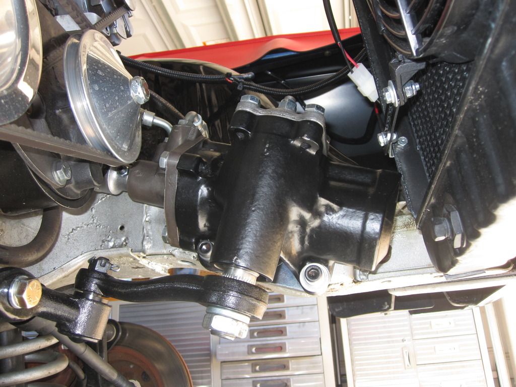

Steering box headache part two was when I tried to mount the box to the frame. I couldn't get the any of the bolts to catch any of the 3 hole threads to save my life. After about 15 min and a dead left arm, I took a break and removed the braket from the box. I still couldn't get the bolts to catch; however, they would catch easily from the other side and would contine to tighten until it reached the other side where it stopped and would not go any further. The adapter plate only fits one way due to the specail flush bolt used up top of the adapter. Bottom line, I had to take the plate to a friend's shop where he confirmed it wasn't threaded to accept bolts on that side it was supposed to. He cut the threads for me and I was back in business. That was 2hrs out of my day I wasn't going to get back. So, in short, if you have to swap the adapter plates, do yourself a favor and check to ensure the bolts go in where they are supposed to before you start your project. I got back to the house and fastened up the box to the frame easily.
Step 3: Accurate, just make sure you install the pitman arm pointing towards the back of the car with it angling down, not up.
Step 4: Accurate, my car didn't require the additoinal idler arm steps so I can attest to that. Make sure you install the grease fitting. It's a different size than the two used for the tie rod ends.

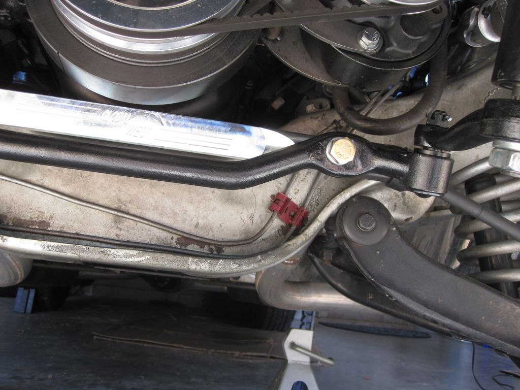

Step 5: Accurate, and pretty easy. After torqueing the nuts down on the idler arm and pitman arm, I noticed the nuts don't go all the way to the bottom to the plastic washer. I was initially concerned with this but left it as I figured that was by design or the washer wouldn't be made of plastic. See below at the center link-pitman arm connection. Idler arm connection is the same:
I had no trouble getting the idler arm and pitman arms parallel when installing the center link.
Step 6: Again, not applicable to my car. Others I know will have to do this step so I encourage them to post about their experience with this step.
Step 7: This step indicates that the new steering shaft the provide is indented on both ends and used for placing the set screw and factory clamp. The shaft was not indented on either end. I called Global West and asked them about it and they admitted the instructions were wrong about this and I didn't need to make any indentions myself. I installed the intermediate shaft easily ensuring I had enough on both sides for the factory clamp up top and set screw on the bottom to grab.
8. I used torque wrench as directed. Cotter pins and grease fittings installed. I did have two additional grease fittings as I only installed them on the idler arm and outter tie rod ends. I watched the bump steer video again and noticed they had grease fittings installed on the center drag link but there are no holes for this. I certainly didn't want to drill and tap any for fear metal shavings might get into the bearings. I called Global West again to confirm and there are no fittings installed on the center drag link. Thank goodness, I would have not been happy about that if I had to do it.
9. self explanatory.
I have not installed the sway bar yet. I also purchased their front end spring and getting them installed at the same time as my alignment is getting done. I'm pretty sure they would have to remove the the end links to get the springs installed anyway so I saw no point of doing it now.
I'll post more after I get the alignment and springs installed on Weds. I hope to install the sway bar Thurs or Friday and will continue my write up at that point.
Hopefully a few of you find some value in this as I wish I knew a couple of these issues prior to my starting the project. Here are a couple more pics of the install.
If you have any questions, feel free to ask. I'm no pro, if I can help, I certainly will.
