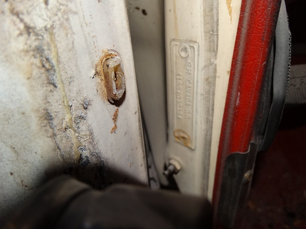

Well I didn't ask one, but if I must, on Canadian built cars did they stamp the serial number from the car on to the block?

On a Canadian car, they had an engine number on the block stamping. Not sure about 64, but 62 and 63 had it this way.
GM Vintage in Ontario can get you that number, and likely all the options on a 64 and up. I have the info they provide for 63 and 62, not as detailed, but I think 64 and up they can provide almost a "build sheet".

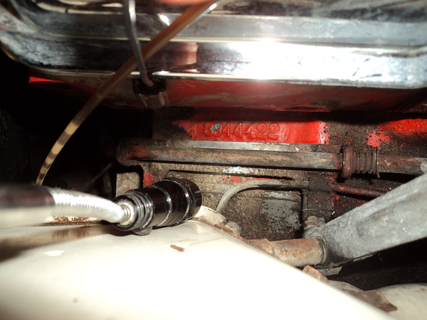

Can you post a picture of the engine pad?

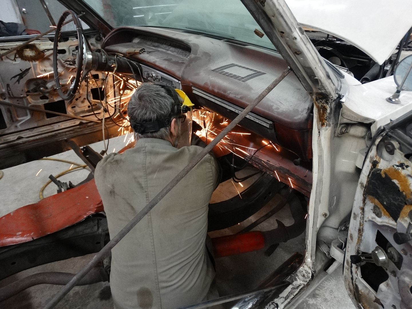

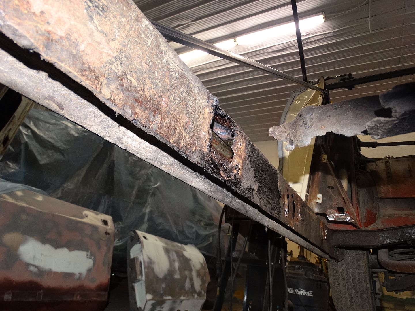

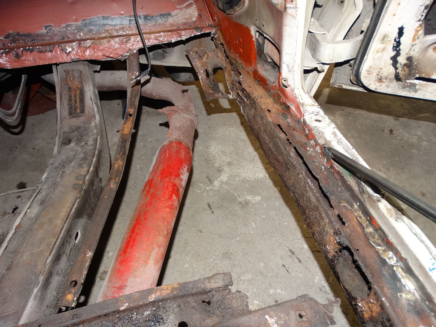

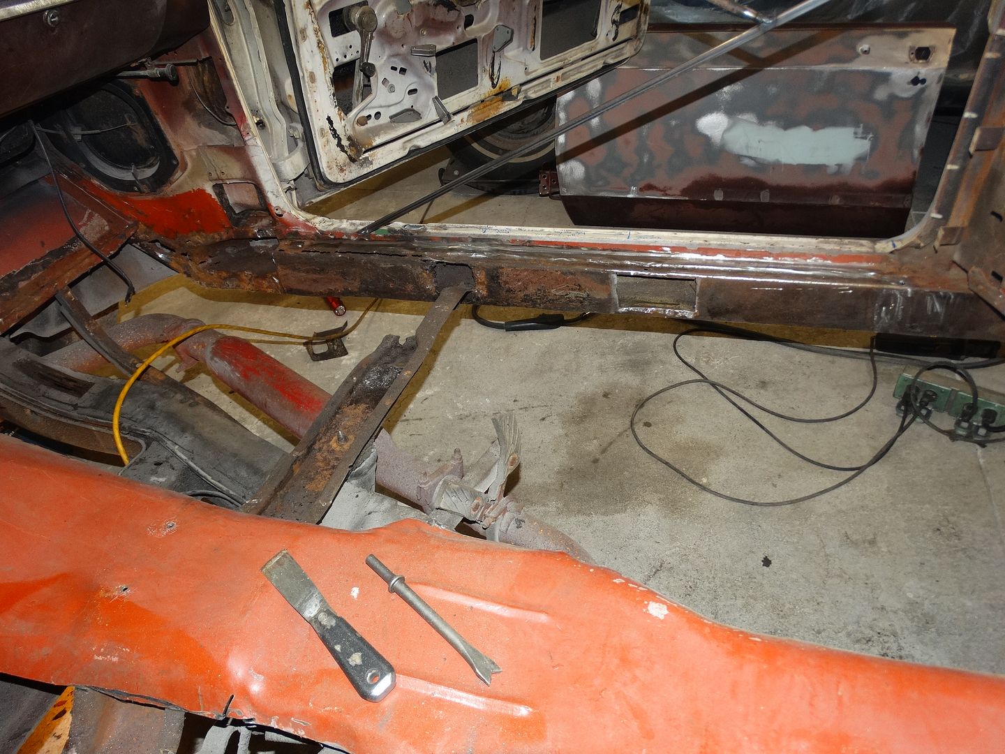

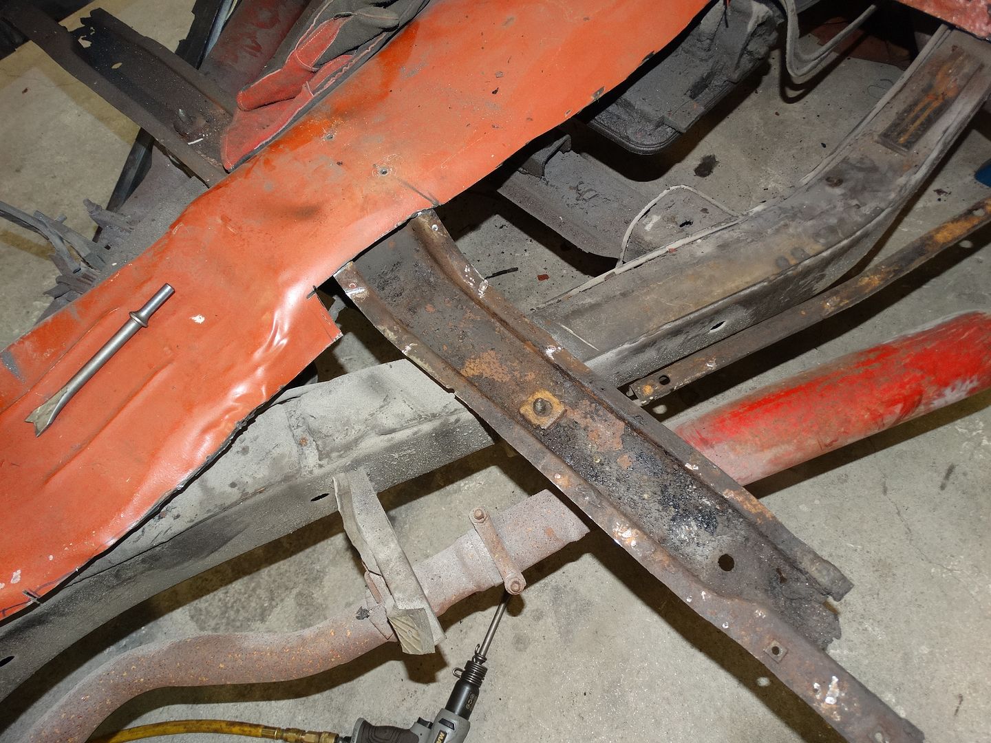

Got some more done today. Started cutting out the floor boards. There were two separate repairs done over the years, the first using brazing rod, the second with rivets and tar!
pic time,
Had to remove the rear braces to be able to get the floor pan in.
A little bit of inner rocker work required.
cheers

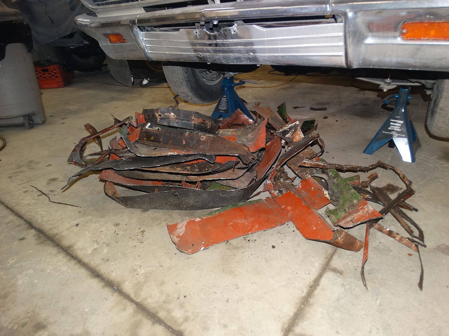

I quoted him 130 hours to replace the floor pans and get it ready for paint.
Got the rest of the drivers side floor removed and welded up the inner rockers today.
Total time so far, 16 hours.
The scraps so far;
All patched up,
cheers

The Canadian cars to my knowledge did not have the VIN number stamped on the block.
348-409.com will have all the casting codes etc to determine the actual engine, and if it does turn out to be a 409, then perhaps GM historical services can give you some insight as to whether the car was born with it..or what it was born with.

Well it's a real 409 block,
According to 348-409 website
http://www.348-409.com/cgi-bin/block/csvsear ch.pl?...
Block# 3844422
Year used: 1964
Model: Passenger car
Engine: 409
Horsepower: 340,400,425
Bore: 4.3125
Stroke: 3.50
Main Journal: 2.50
Rod Journal: 2.20
Notes: This block was used for all 409 applications in 1964. This block has the "X" on the front.
And I'm doing nothing else but the body work and floors, no other detailing or interior etc.

The reason I commented about the 409, is that it would seem to have a 348 oil pan on it if nothing else, and usually when the shroud is missing, the engine is usually a transplant... nonetheless not your issue I guess.. block appears legit. Stamp number would still be cool to know though..!
You bet Don... of course there will be a block stamp, but he asked about a serial/VIN number...Tonowanda didn't know the recipient cars' VIN, and to my understanding the Canadian car plant did not bother to stamp it on while installing it.

Well got some more work done, the right side inner rocker was a little more rusted than the left,
Those captured nuts on the crossmember for the body mounts will have to be transferred over to the new brace.
More ickyness,
The pile keeps growing,
Inner rocker cut out,
New metal going in,
Working on the inner-inner rocker.
Almost fixed, one more little section to replace,
Action shot, cutting out the last of the floor.
Until next time!
cheers

I am surprised the frame didn't collapse. Looks like the rocker strength is near non existent . When there is so much decay how do you weld to the adjacent thin metal ? This could never be placed on a rotissery without ending up in two pieces.
Your a " brave rust eater " for sure. Hard to watch the full cycle of metal returning to earth.

You're welcome for the pics, this also helps me document the repairs for my customers.
Don't forget, these cars have the X-Frame, so the structural support for the frame is down the center of the car, the rockers provide support for the body. And yes being a convertible these rockers are very structurally important. When I first lifted it on my 2 post hoist (first getting the owners permission) the upper rear gap on the doors opened up about another 3/8 of an inch when the weight was lifted (with the doors closed, would never try this with open doors LOL). We'll see after all the repairs how it performs in that test.
This is also why it's a necessity to brace up vehicles, especially convertibles, when repairing/replacing any body or frame pieces.
In regards to a rotisserie, I do have one but I don't use it for rust repair just for that reason. These cars were assembled on a line, not hanging with only the attachment points on the ends. I do all the structural repairs on a level surface (in this case with all the weight on the suspension) and then move it to the rotisserie for body work and paint. Also this way you know everything will line up (body mounts etc.)
