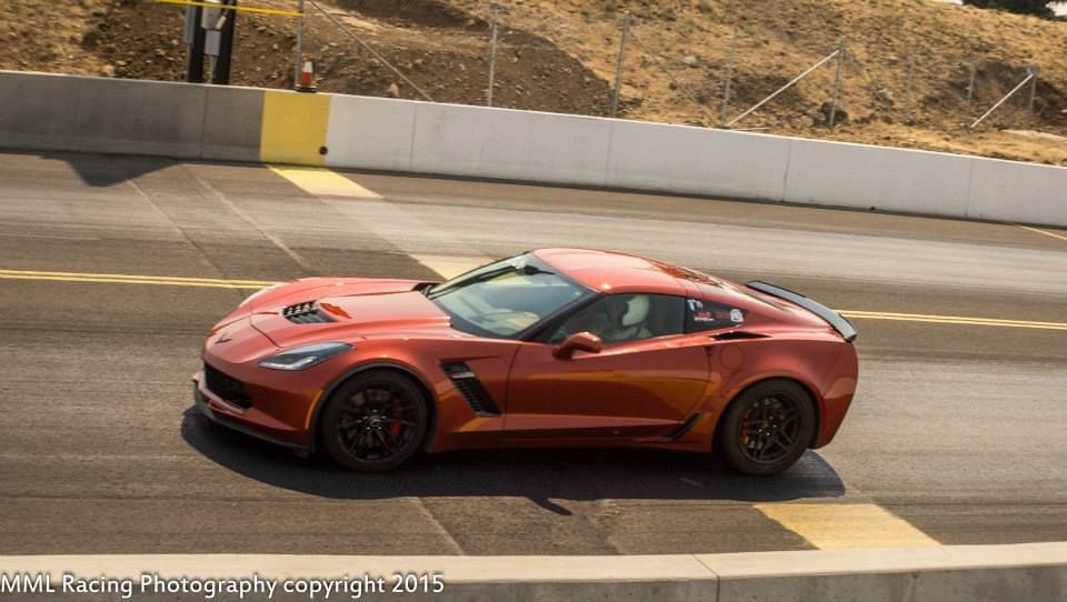

Well. We parked it for the year. I haven't been on here all year because we have been racing all summer and fall. We had an awesome year. We did blow a transmission and that was a big bummer....but its replaced now. We had 390 drag race passes and 13,000 miles on it when it failed. (It has 15,500 now) Chevy said they wouldn't honor the warranty because we "Used it in a manner inconsistent with what it was built for"...but our dealer replaced it once out of goodwill. It's shifting hard again so we are about to take it back to see what's up with that. After that we have a pile of bolt ons to wake it up. It should be just over 1kwhp when we are done.
Stock her best pass was 10.86 at 128. Her best mph was 130. We did a few roll race events too. There she trapped 140. We used her for a few hpde. hubby got her up to 151 and I hung around 135 to 140 as my top speed. That was all I was ever comfortable with. The trans broke on our second hpde weekend.
We met a lot of cool people who loved the car....and a few who were haters for some reason or another. We raced in the IHRA points races all year and a bunch of other events. We also raced at an IHRA National event....
All in all it has been an absolute blast. Some months we were on the road racing and camping in our fifth wheel three weeks then home for a few days then back at it. We have no regrets. Chevy built one hell of a hotrod.
Here are some of the pics from our first year.
