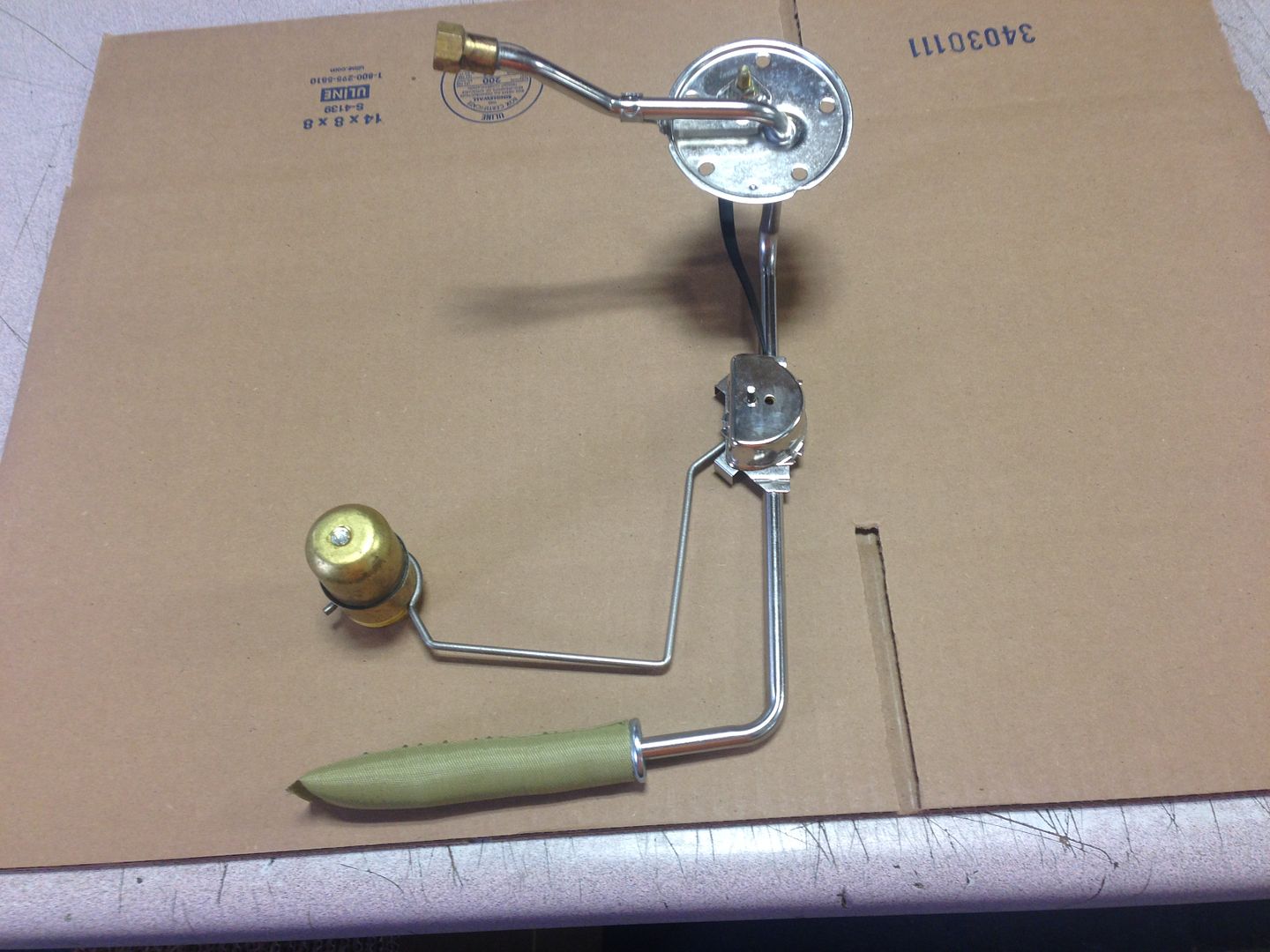

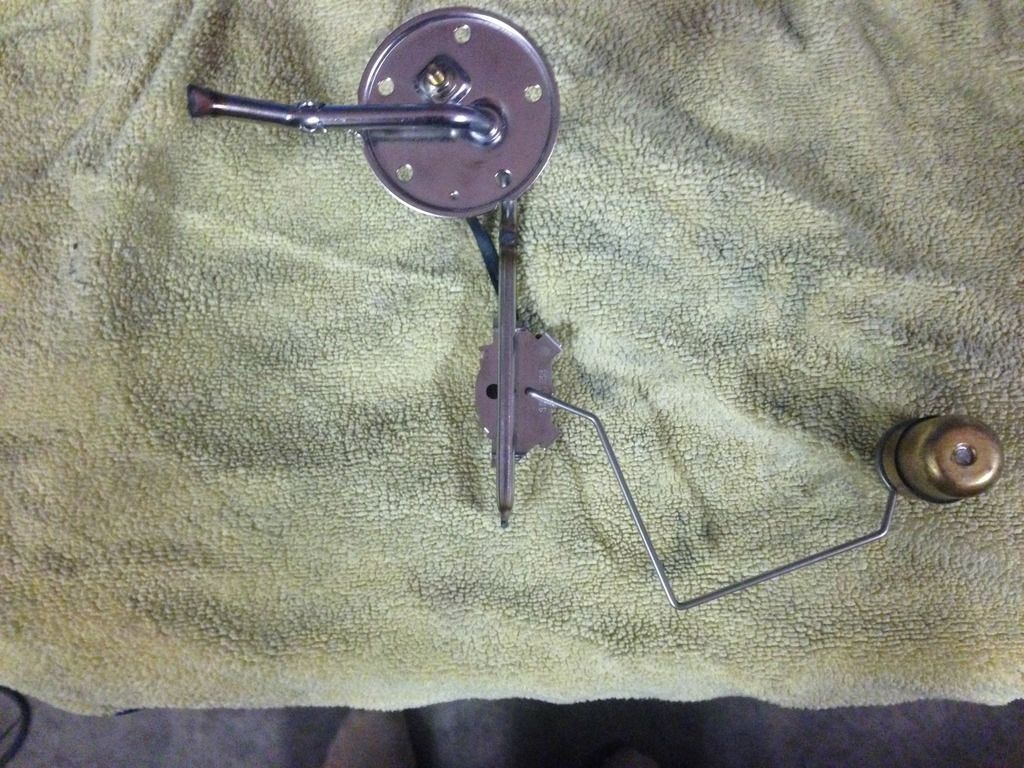

Had another little issue come up......when I did the gas tank revision I didn't think it thru correctly, the stock fuel level sender had the float arm going in to the left.......LOL.....it and the new fuel pump were fighting for the same spot..........I ended up ruining the original sender in modifying it......new one showed up and was modified correctly ..........cut off the pick-up tube that the sender was mounted to and rotated it 180 degrees......and since I am not using the tube anymore we welded it up solid to eliminate any fuel leaks.......installed it and everything works perfectly....Two little issues remain (until I find more).........the intercooler pump doesn't turn on and the fittings I used to connect the intercooler lines to the Supercharger leak.........Always something.........the exhaust will go on this week and I moved the car under it's own power for the first time ........just in and out of the garage.........

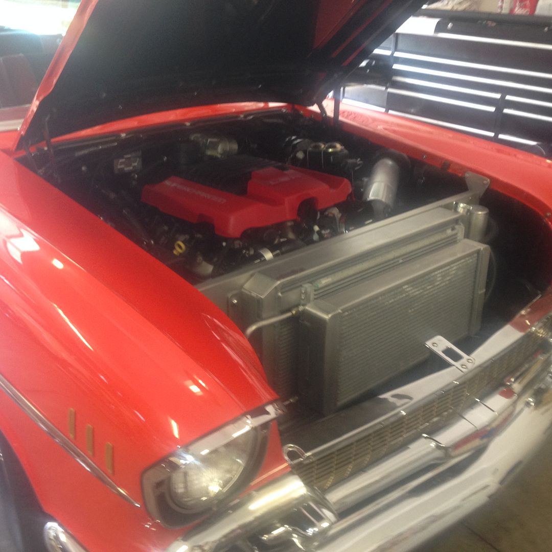

The learning curve continues..........I didn't take the car to the Automotion show in the Dells as planned because the Intercooler wasn't working........I had the car running for a while and was checking the cooling system with my infrared heat gun........Noticed the intercooler was ambient temp.......Hummm.....Check the intercooler lines and just a gradual heat change Hummm.......I checked the plug and had Power.......Humm.......I added a Reservoir for the coolant that was higher than the Supercharger and it was full.....but there was no movement of coolant when running.........I called Pace Performance (where the system was purchased) and told them the pump wasn't working........They said they would Warranty it and send out a new one.........(paid for in advance till they got the defective one back)........So.....We get back from the Dells and the box was waiting for me.........Beautiful !!!....So......I change out the pump......fill with water again (was surprised there wasn't a lot of coolant leakage from the line from the intercooler).......started the car and the pump ran for about 10 seconds and shut off...........Darn !!!.........Check all the fuses......everything good.....
Hummm!!!!.........Come in the house and do a Internet search about the pump........Found a thread about this exact problem..........Air in the System.......When the pump sees Air it turns off......Hummm....System is full at it's highest point..........Hummm.......Go out and now Focus and this issue...........I ended up putting a "T" fitting from a Radiator flush kit in the upper Intercooler hose....I back filled the Intercooler that I thought was full wit 3/4 of a gallon of coolant.....capped it off and it now works perfectly..........Sheesh !!!.......This car stuff is Hard !!!!

Frustrating, but your troubleshooting methodology eventually led to you figuring out the cause of the problem. Thanks to the internet....
Remember when (back in the day) when there was no internet and you had to shade-tree all this stuff without the benefit of anyone else to ask...

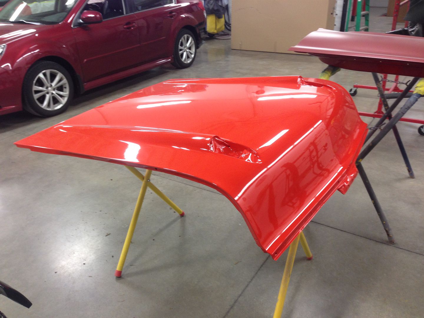

The Hood had a bunch of stone chips on it from a couple years of Power Tours.....And ....everyone knows how that works out.......Now that the big stuff is finished and every time I looked at the car, all I saw was the stone chips.......So.......the car is at Pulera's getting the hood repainted, other little chips touched up.......then a good buffing......Then it's time to put some miles under it's belt......

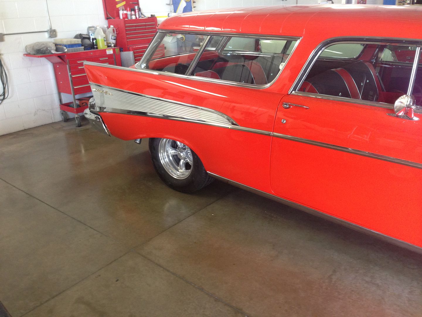

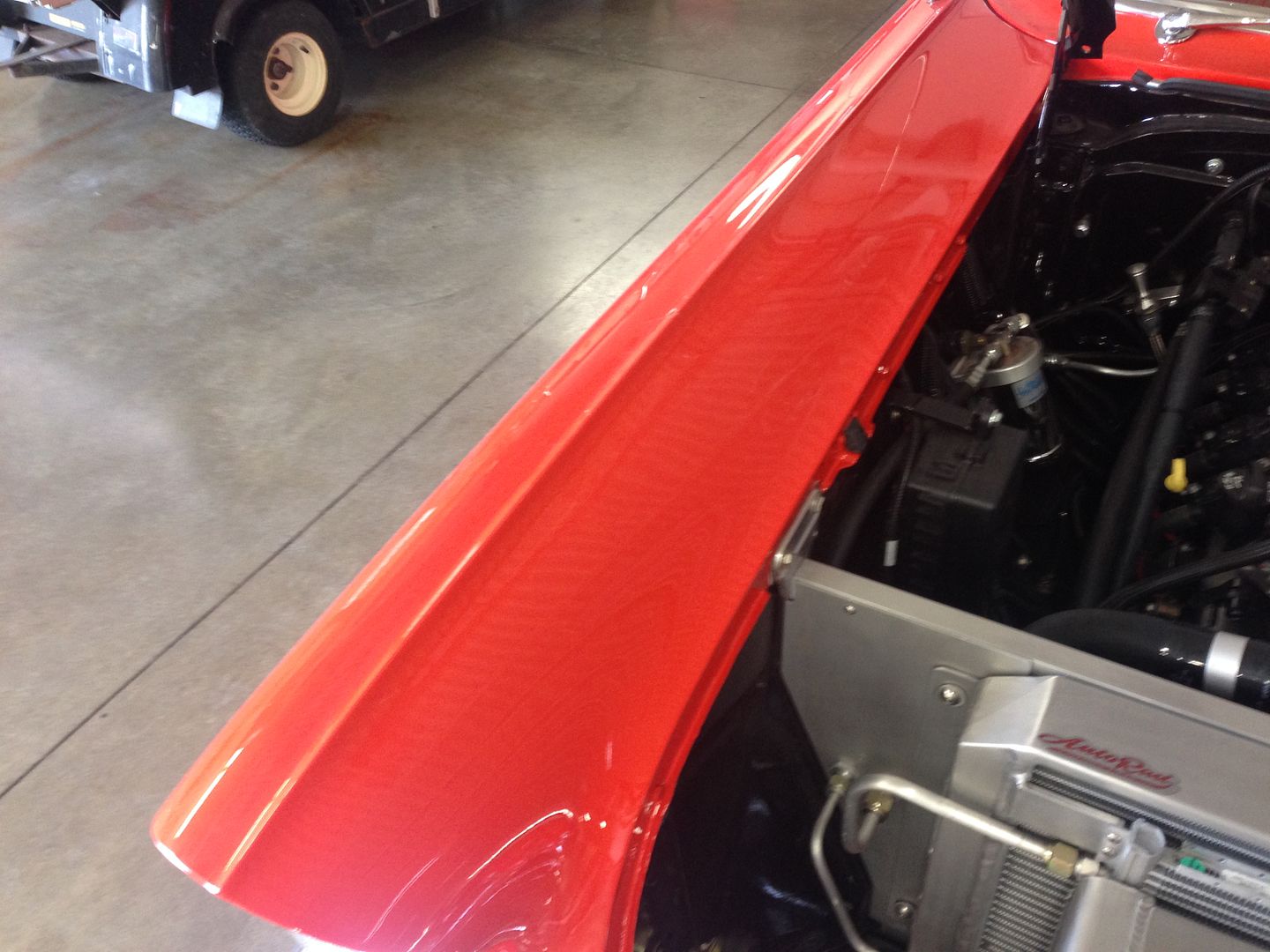

It's been a while , update........Pulera's got the paint mixed and matched.......as long as they got it that close I decided to have them fix the passenger side wheel well area.......there was a spot (very small) where there was a paint adhesion problem (small bubble)......not a rust issue at all....But......Like everything at Pulera's......they don't do anything unless they do it correctly.....so....Before and after pic's............Should get it back next week so I can get some miles on it.......
After
They also repainted the top of the fenders that had a bunch of paint chips that I put in while installing the core support
Almost there..........

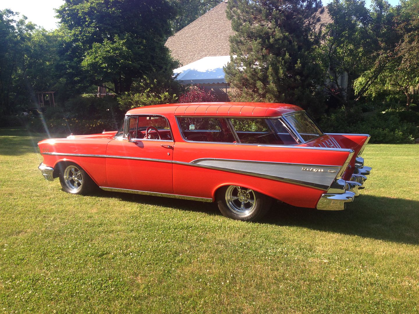

Update.........The car is pretty much finished and we have taken it on a couple of short trips to check it out.......A couple of things needing improvement are getting rid of the rear leaf spring choppy ride (to be replaced with a 4 link Coil Over set-up) and the front seat.........We will be getting a split bench contoured foam seat and get it re-upholstered in original material to match......the stock seat is like sitting on a Park bench......LOL........Done but not "Done"......

The car looks incredible! Keep up the good work

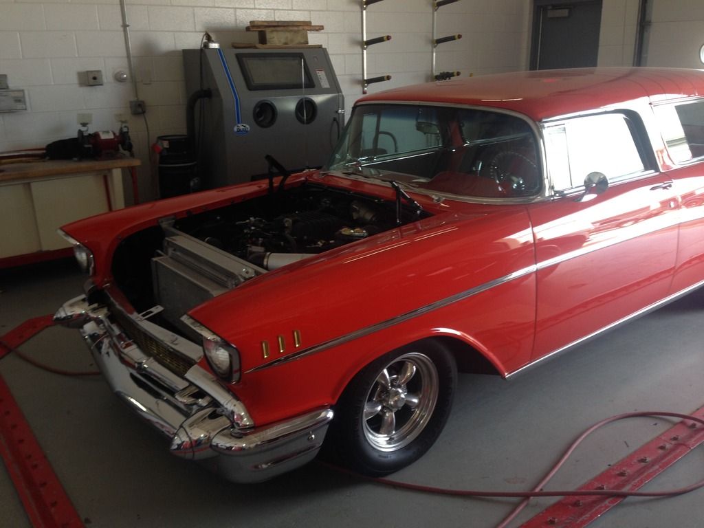

Update........A couple of things........Took the car to Nickey Chicago for tuning......during the tuning process a couple of issues popped up.........#1....I put a Concept 1 front drive set-up on the car to allow for the A/C compressor to be mounted up top ( no room in the stock low position due to cross member clearance issues)....this setup drives everything off of one 8 rib belt.........and in the Dyno tuning process when given full throttle, the belt squeal made it apparent the Belt wrap on the crank pulley was not the best along with the belt dust all over the engine..........I had a Gatorback belt on the car which has cross grooves which make the belt quieter,........But the guys at Nickey told me to get a Gates Fleet Runner Belt which doesn't have the cross grooves and will give more gripping surface..........Only made 7lbs of boost with the slippage.........New Belt installed..........2nd.......the Horsepower on the Dyno was lower than I expected..(442 RWHP).....Also in driving the car home it ran good but just didn't have the power of the LSA powered 66 Chevelle) ............After getting the car home I put it up on the lift and after looking at the exhaust system..........I now realized that I should have not used the stock cast iron manifolds........and when the exhaust was fabricated, the 90 degree bend put in the pipe coming down from the manifolds actually reduced the pipe diameter quite a bit..........so....as I looked at this set-up, I really realized the Choke point of trying to push all the exhaust at RPM thru that area of pipe........So..........Here we go again......LOL......Ordered a set of 4 tube headers........(pic's to follow).........It will be interesting to see what the numbers will be after getting everything installed and tuned again............I'm also going to install a set of Ring Bros Hood Hinges........
