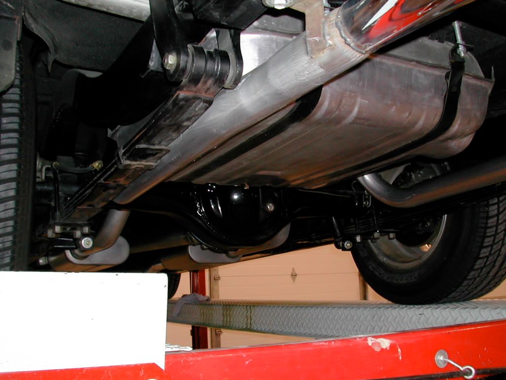

Below are photos of 58" wide Ford Granada 9" rear-end in one of my 55's. I moved the springs to under the frame rails and used 10" wide wheels with a 4&7/8" backspace. Worked well and did not rub.

Jack
No there was no steel wool in the exhaust tip, it was just the inside of the exhaust tip. The car had an absolutely great sound. With the burgundy 55 below, I have really struggled with the sound. As you can see from the photos of the frame below there is almost no place for mufflers. It has mufflers right at the back of the headers and 5 1/2' of cambered pipe on each side and still has a sound that I don't like. Very pretty car but very frustrating.

Rick
I believe you are correct about the Granada and Lincoln Versailles rear-ends being 581/2" wide rather than 58". I do remember ordering the wheels 10" wide with a 4 7/8" backspace. These rear-ends fit great in 55-57s. I still have 2 with disc brakes stashed in my storage unit
