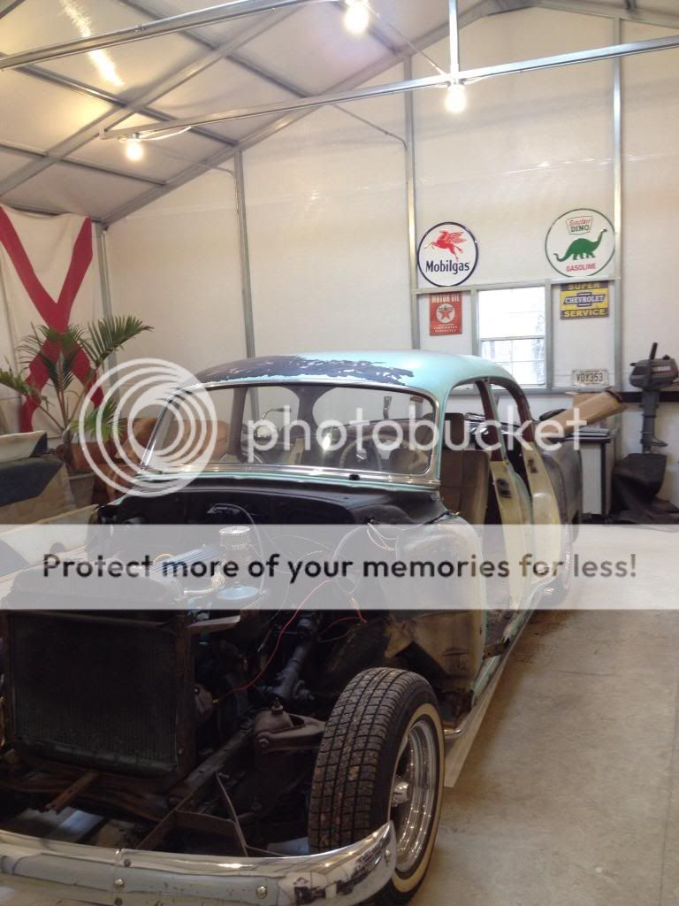

So I posted this initially over on the HAMB, but as you can imagine (if you visit there often), I'm a bit out-of-place.
Anyhow...I bought the car back on Labor Day (2013), drove it around a little but and jumped straight into the restoration. I've got several pics so far, so I'll try to post a bunch and get ya caught up to where I am now.
My disclaimer: rookie car restorer. Rookie welder. Love these old cars and just want to make mine look good again. The car had an AWESOME presence just like I bought it, but it was in pretty bad shape. The pics from when I got it do the car GREAT justice, as you can't see all the problems.
Weigh in, critique, and give advice please. I take criticism well.
William

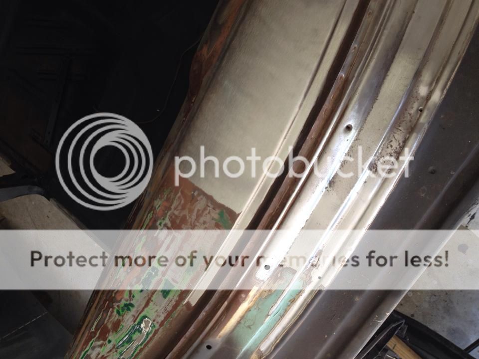

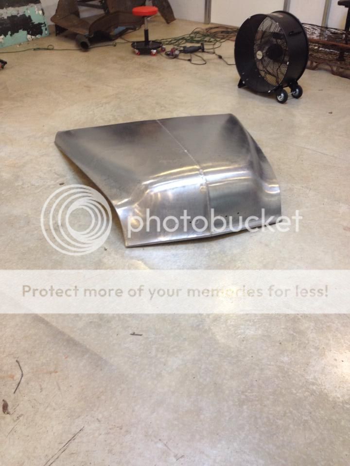

Started stripping the paint. Original primer, original paint original paint second coat (car was a two tone), the newer primer and the top coat.

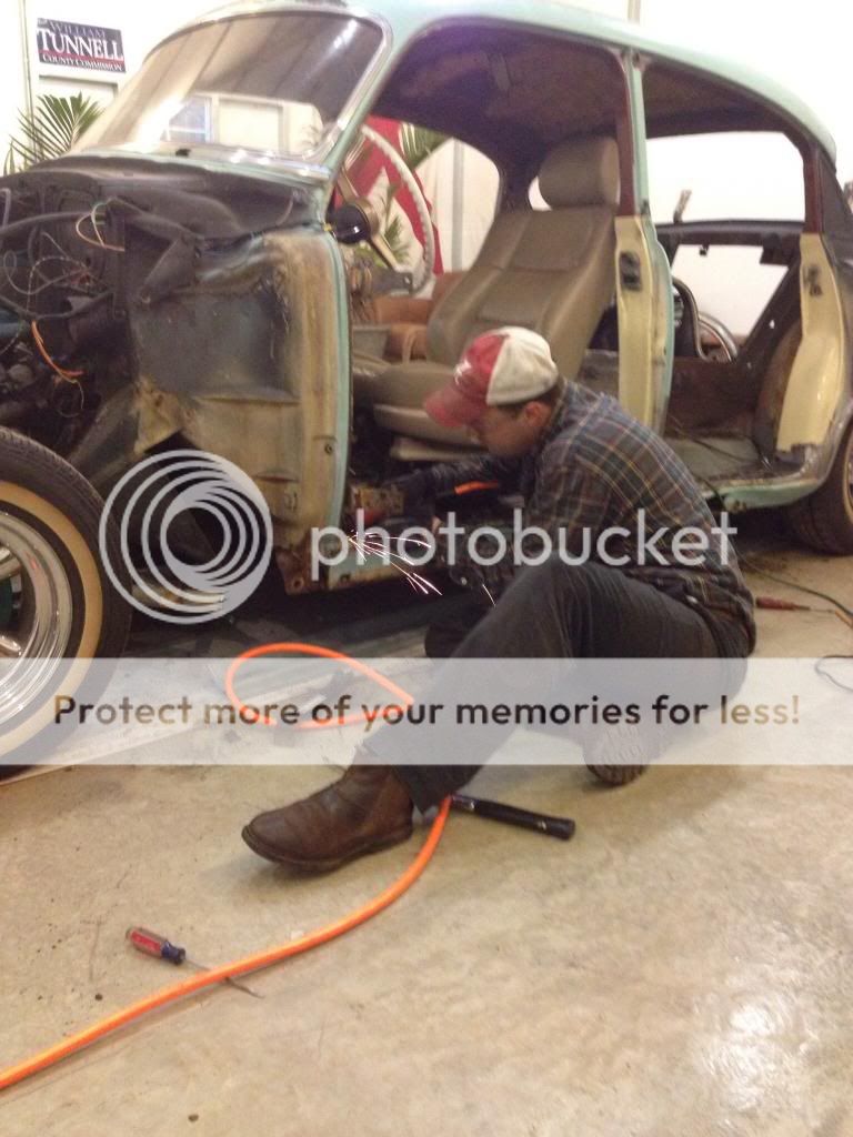

02-23-14 05:44 AM - Post#2429520
    In response to WillyT

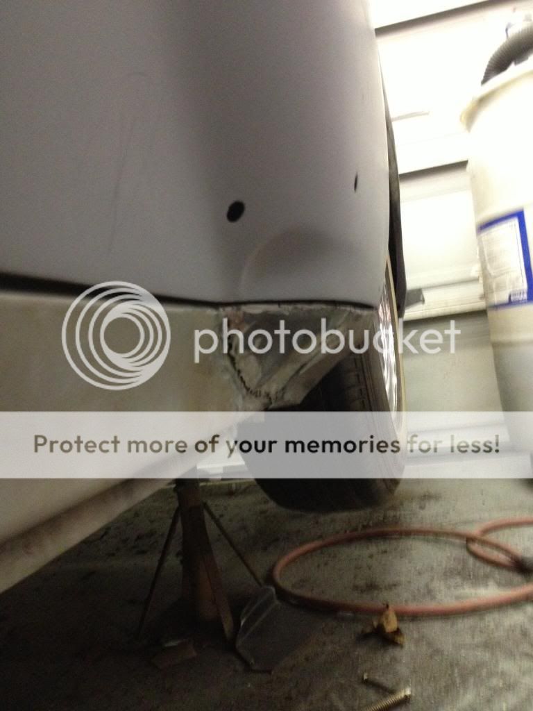

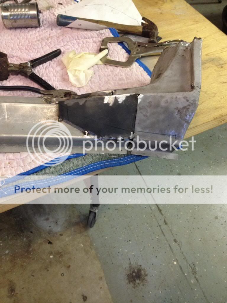

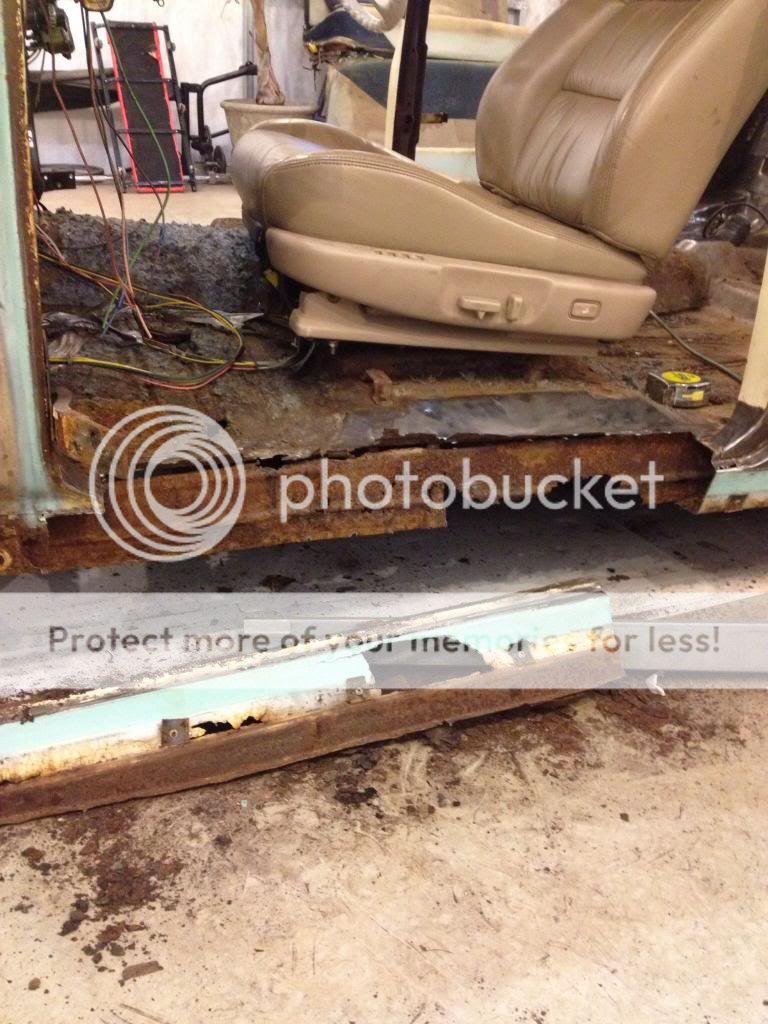

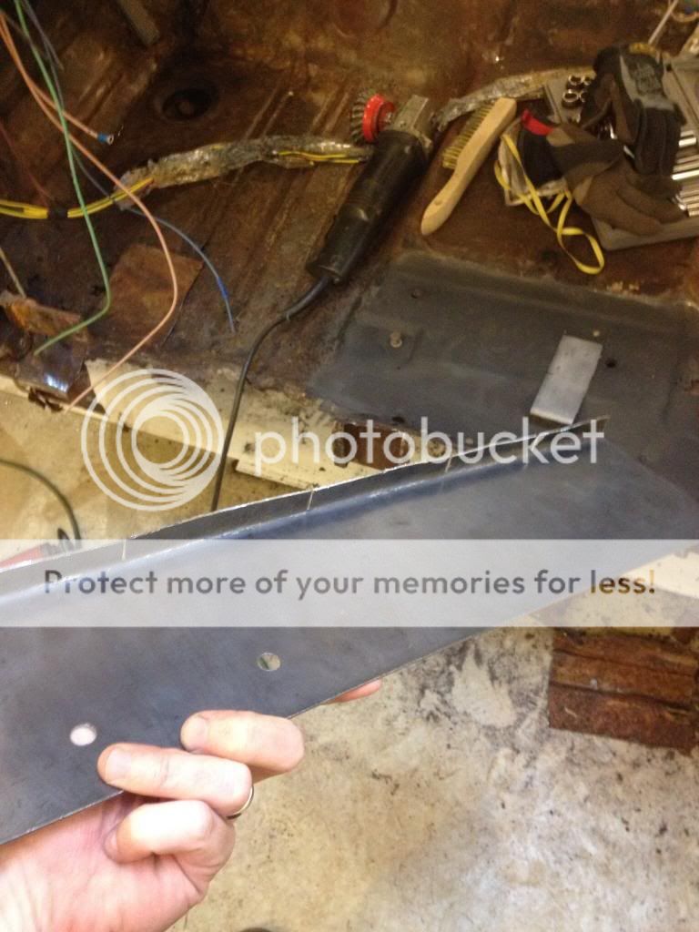

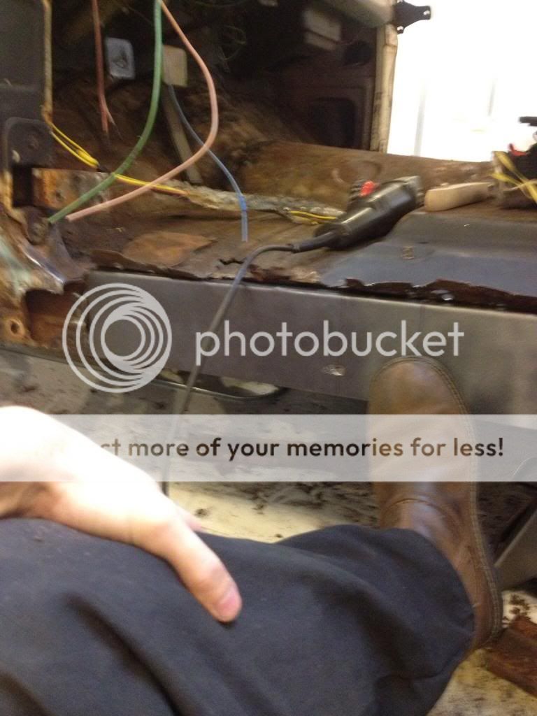

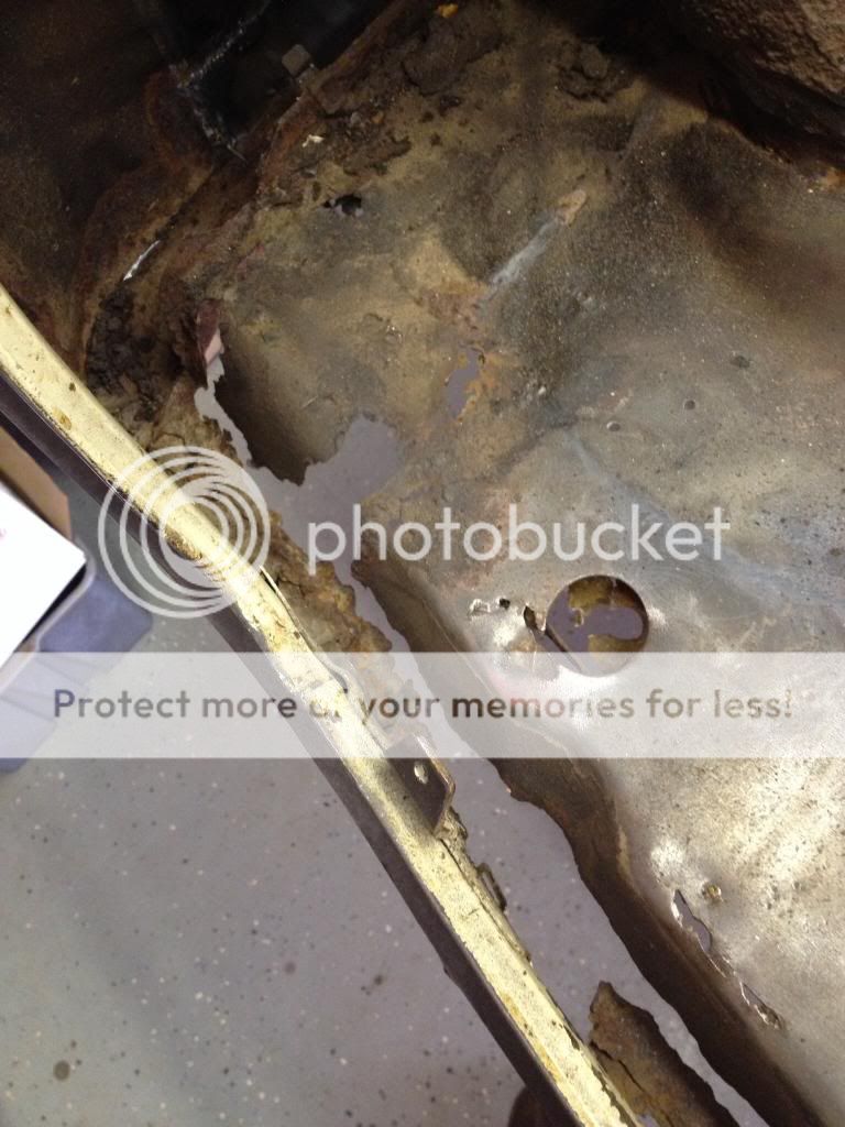

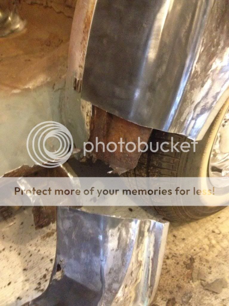

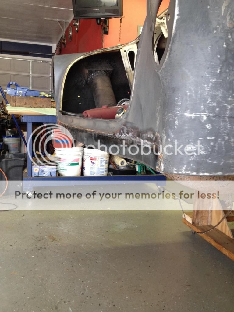

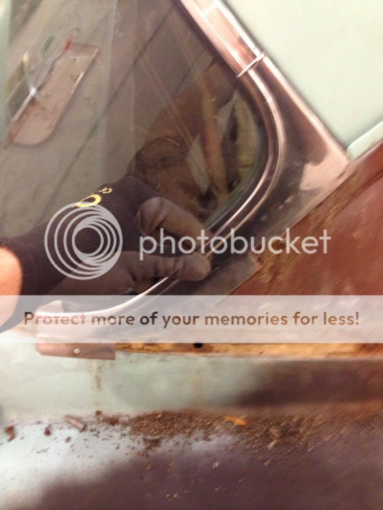

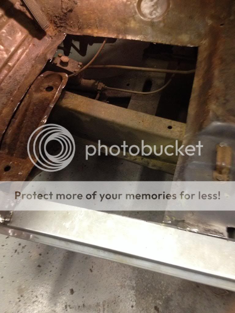

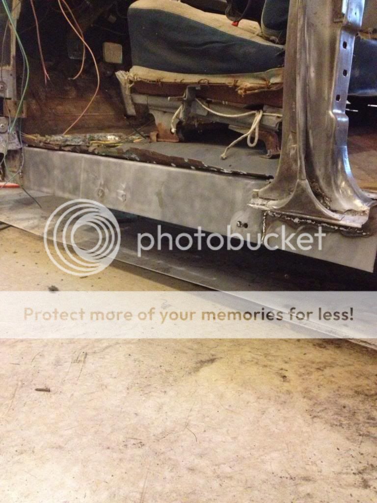

Found the first hidden rot in the bottom of the drivers side back door. The trunk has rot, as do quarter panels ( rear), inner and outer rockers and front floor pans. Piece by piece, it's all getting replaced and repaired. I should say that while I will buy some replacement sheet metal, We are going to do plenty of it ourselves (my Dad and I).

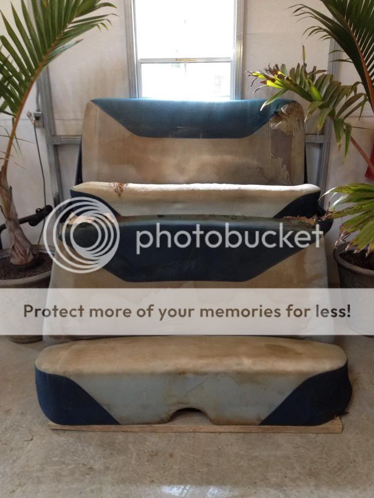

Here's my first official purchase: front and rear seats off www.eBay.com. Dad drove 4 hours one way to Mobile, AL, and picked them up for $160! Covers and foam are obviously shot, but the frames are great and fit perfectly.
Got the doors , fenders, hood, and grill all removed.
Now to the rockers...lots if rot, rust galore, but it's all gone. We made our inner rockers ourselves. Not original, but heavy and strong! We're happy with them and with the low stance of the car, they'll never even be seen
And a "dry run" to see the fit of the outer rockers.

Nice fabrication and fit. I didn't have the rust as bad as you have, but we blasted what we found and coated it with Por 15 and it made it a nice job. My son and I did most of the work except for metal fab which we bought from EMS. Keep up the good work and keep us posted.

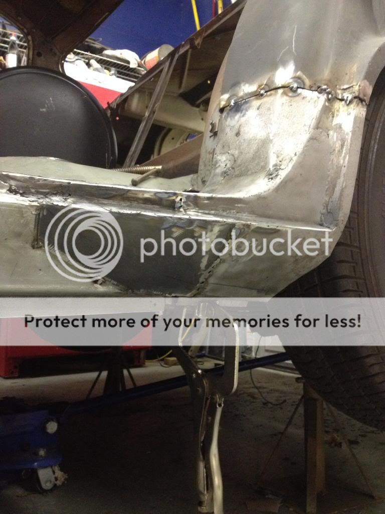

WillyT
Posts: 120
Loc: Alabama
Reg: 11-21-13
02-23-14 07:33 PM - Post#2429814

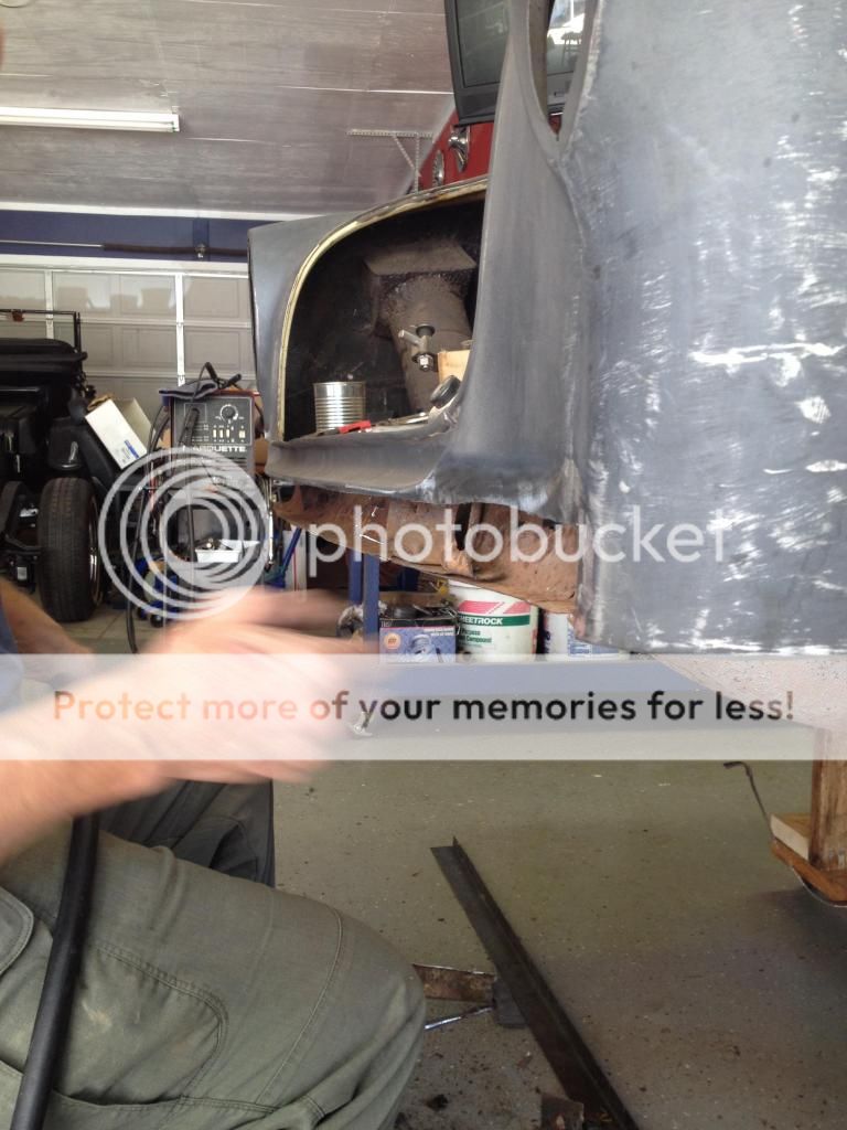

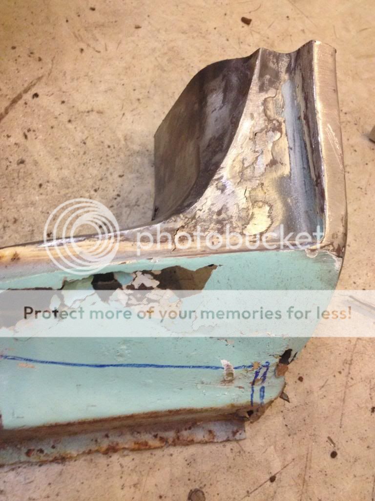

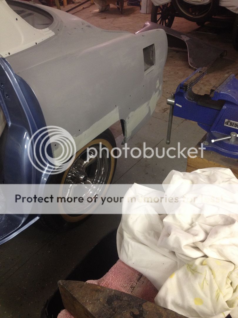

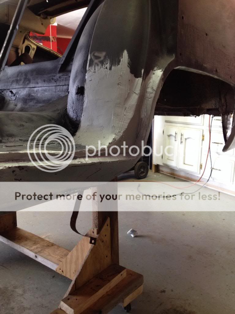

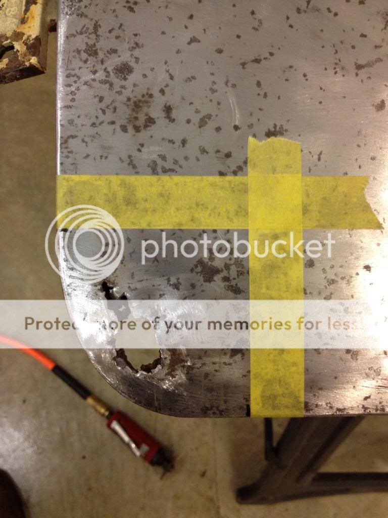

My replacement outer rockers didn't cover the extreme lower part of the pontoon, and it was rotted, as was part of the dogleg. So, I simply cut it out. After having done so, simple is not the word I would choose. Nevertheless, after all is said and done, all's well that ends well.
After sanding down the metal compound, it'll look like the passenger side, which I think turned out really nice.

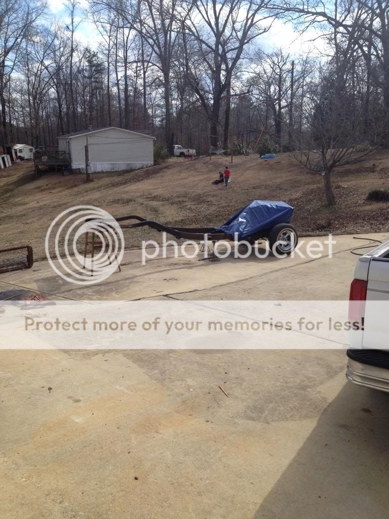

I moved the car over to Dad's house so it would be closer to all the right tools. After getting it there we lifted the body with his Kubota just enough to get it on our homemade rolling rack. Not much to it, but this thing rolls so smooth and the body is very secure.
Thanks for the nice comments. It's been a lot of fun working on an old car and I've especially enjoyed working with my Dad. He's been a Ford man all his life - has never owned anything else - but it's been fun watching him get into this Chevrolet.

After both inner rockers and outer rockers were out in place, welded in, ground down, and ready for primer, I needed to replace both front floor pans.

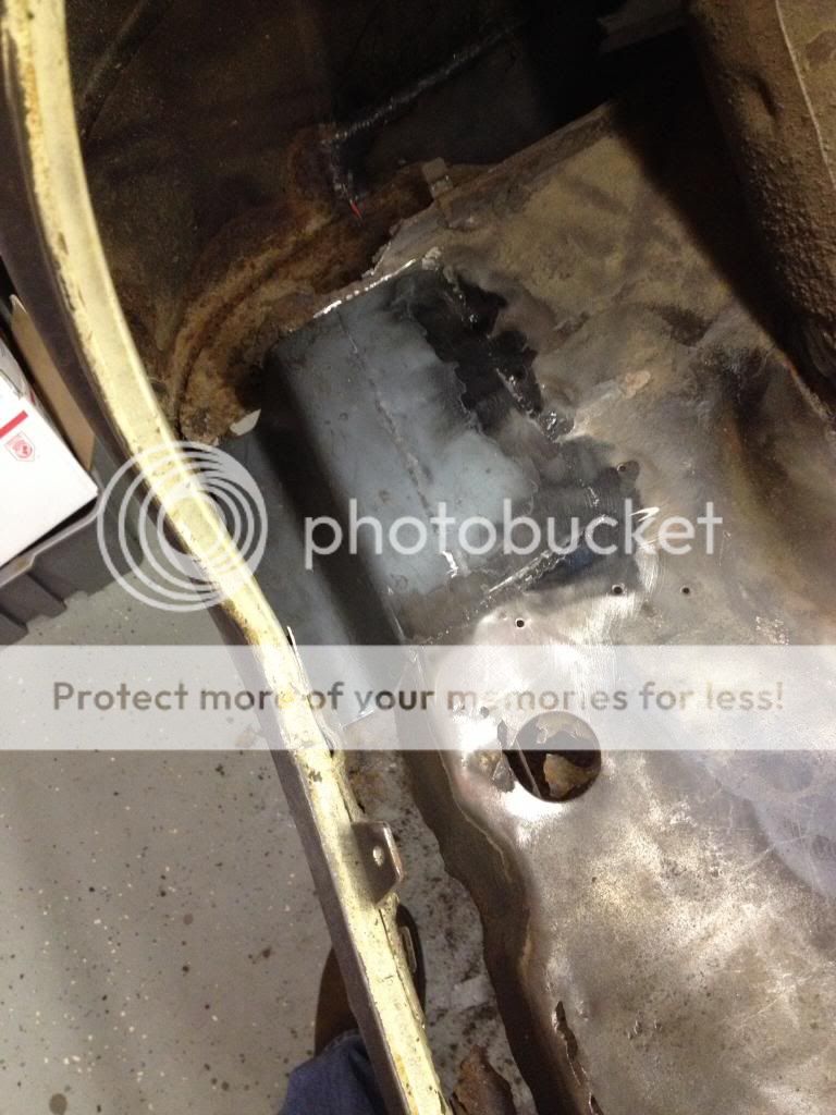

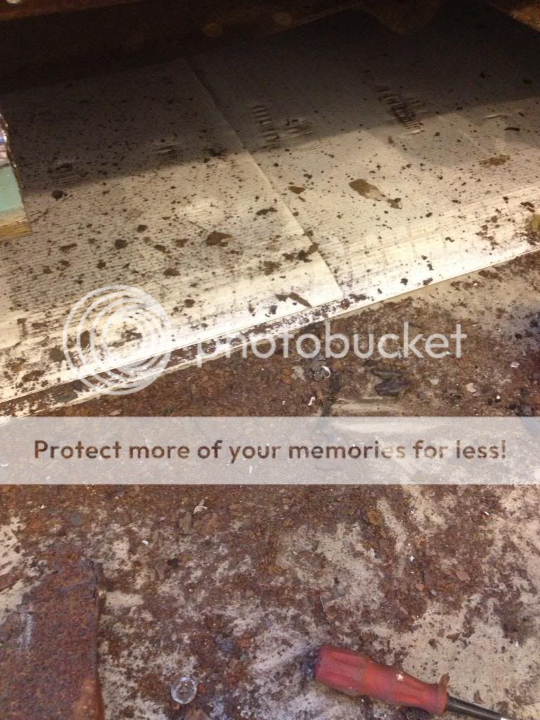

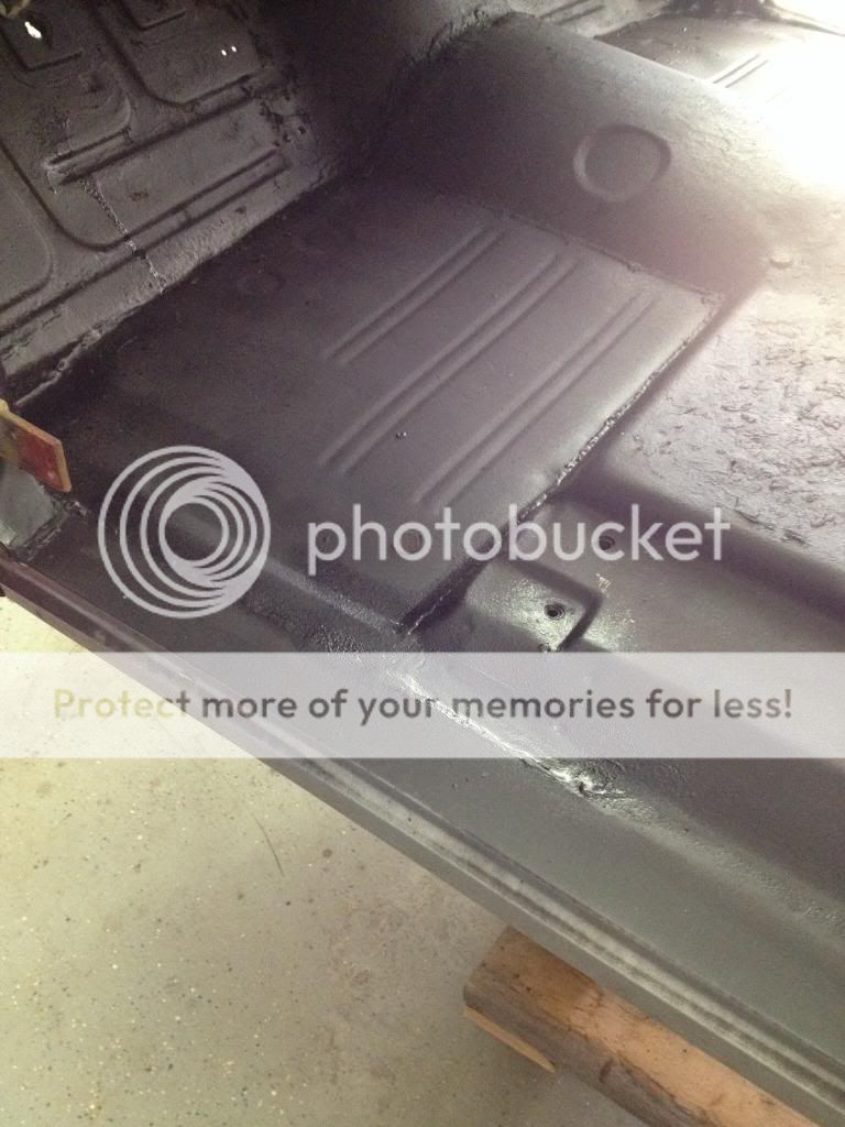

Sorry it's been so long since I wrote an update. Here are some pics of the work we've accomplished since then.

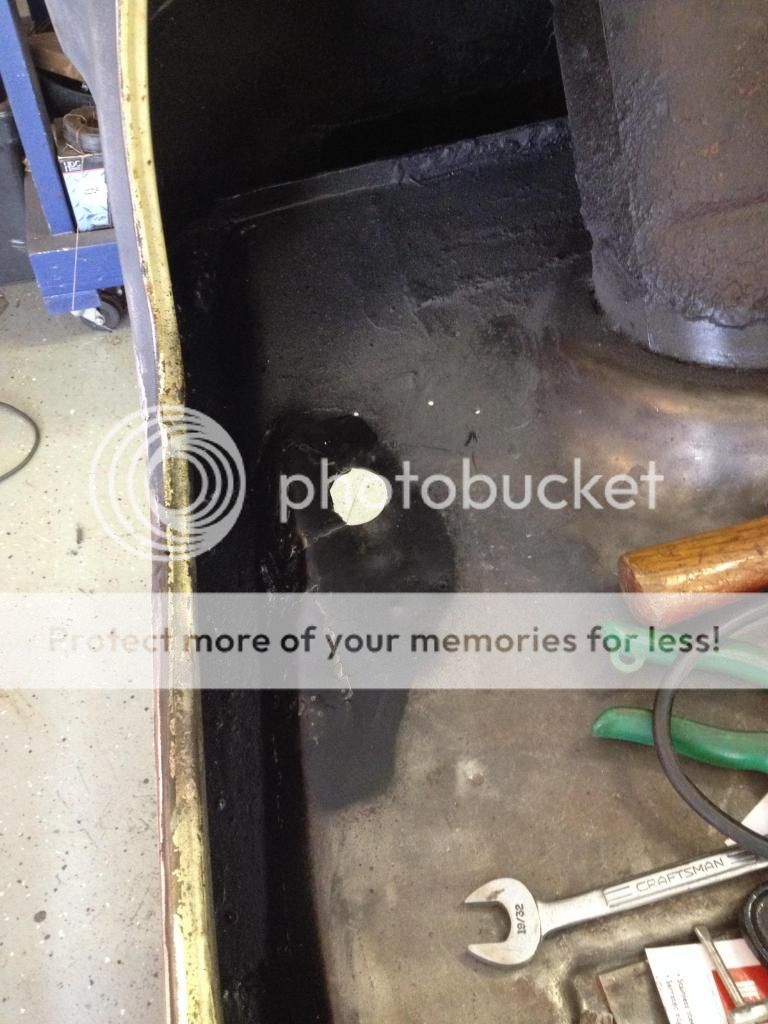

Floor pans in and coated.
Now on to some sheet metal work in the trunk.

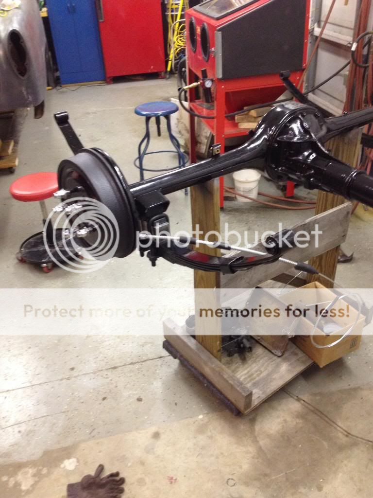

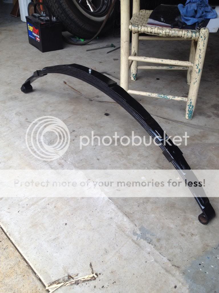

still working in the rear

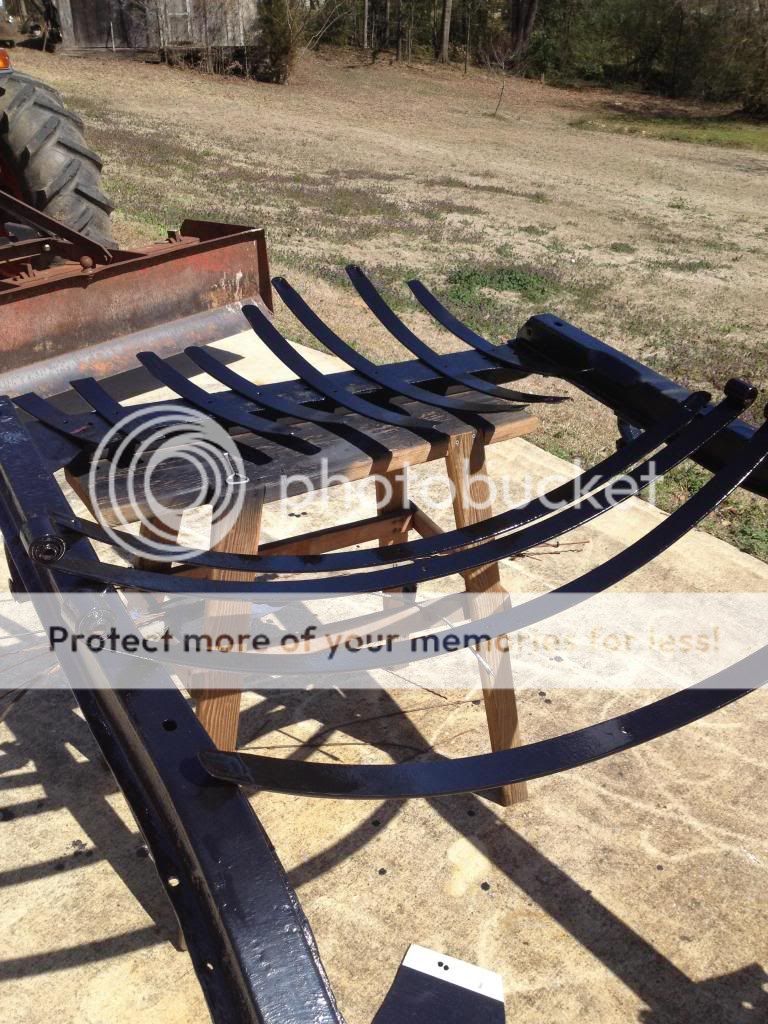

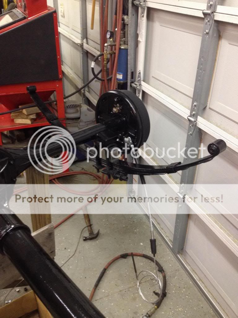

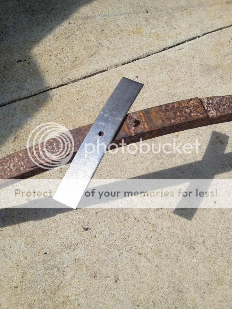

and now the leaf springs...donated from another CT member, Bikeless Bill.
and the rear-end...cleaned, brushed, painted and reassembled.
53 Bel Air 4-door.
Ephesians 2:8-9

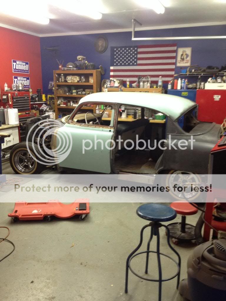

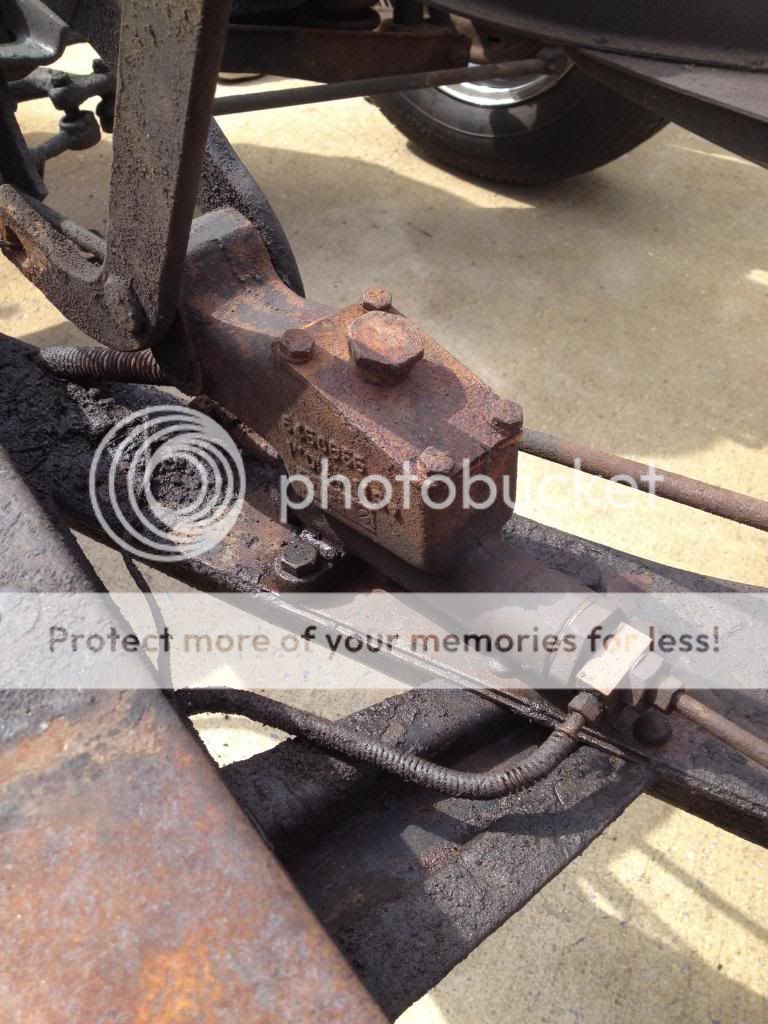

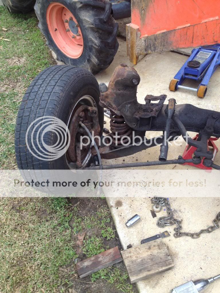

WillyT
Posts: 120
Loc: Alabama
Reg: 11-21-13

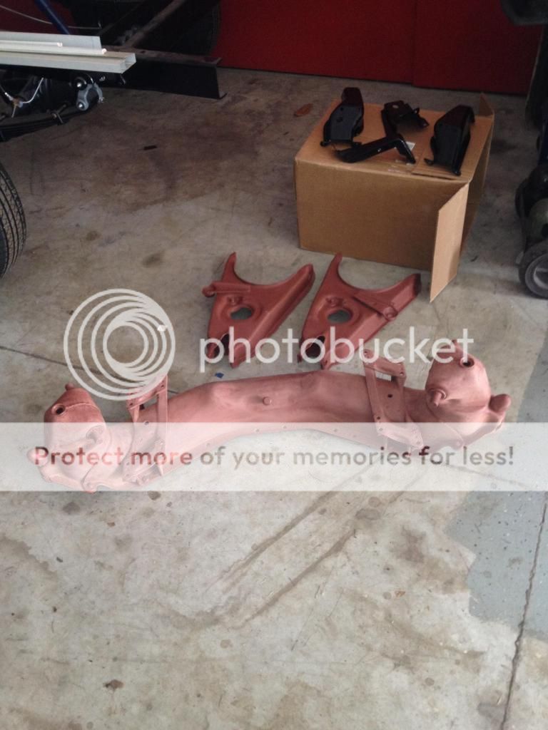

07-19-14 07:08 PM - Post#2470402

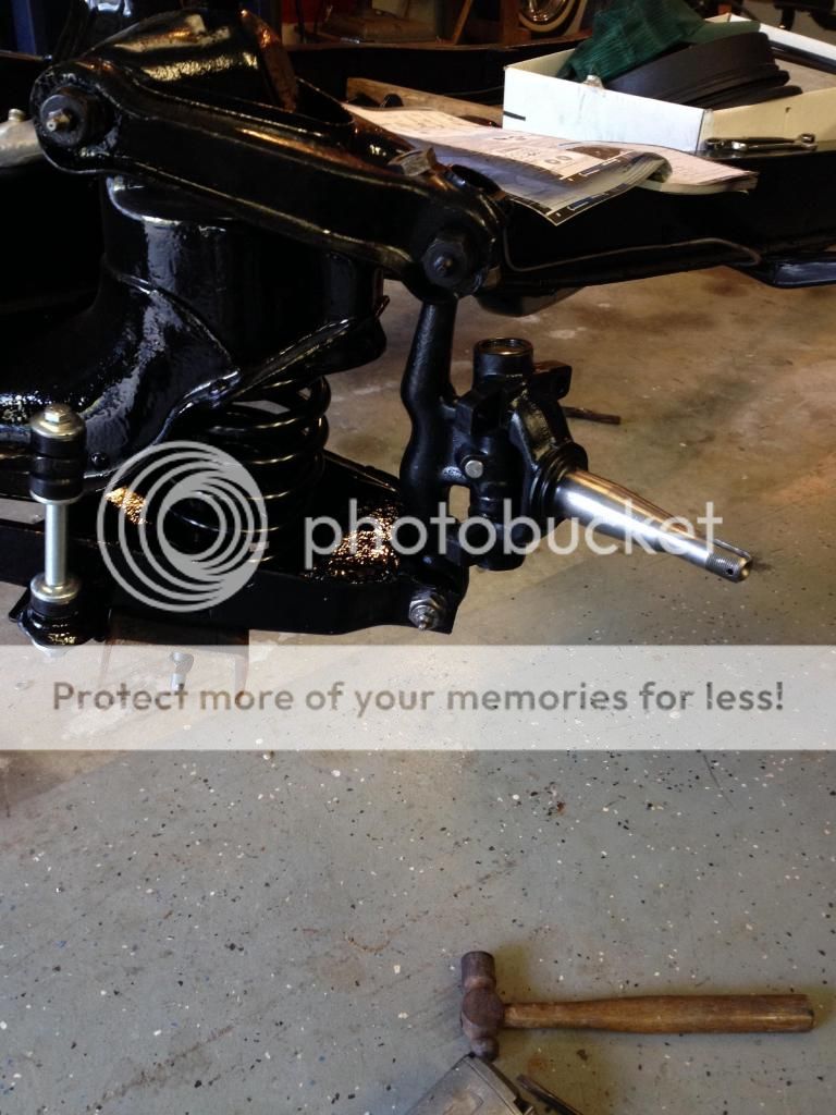

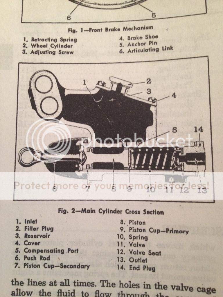

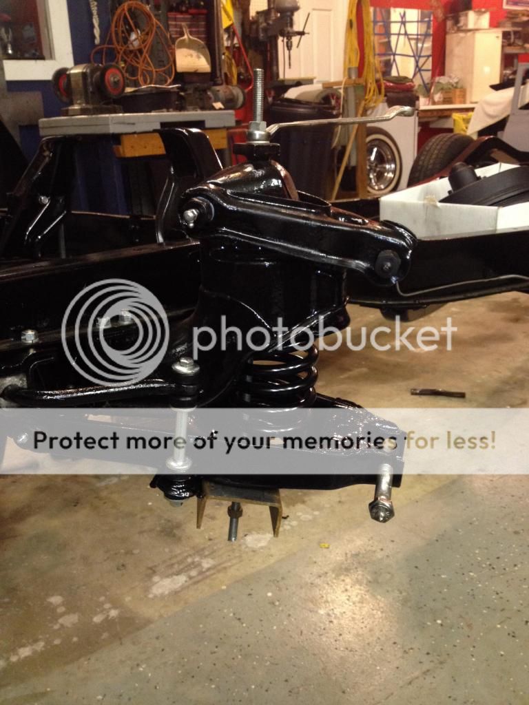

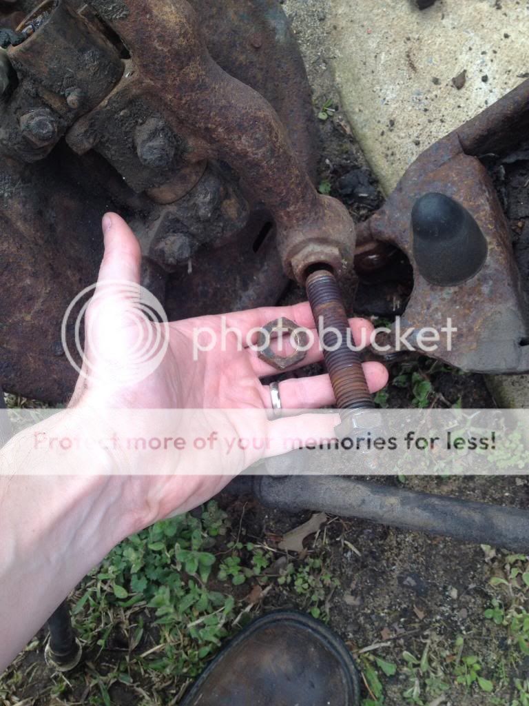

Before -
Little help from the Shop Manual!
After!

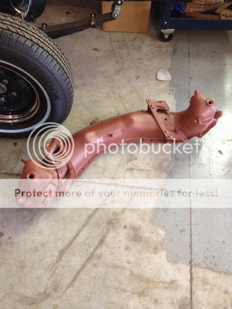

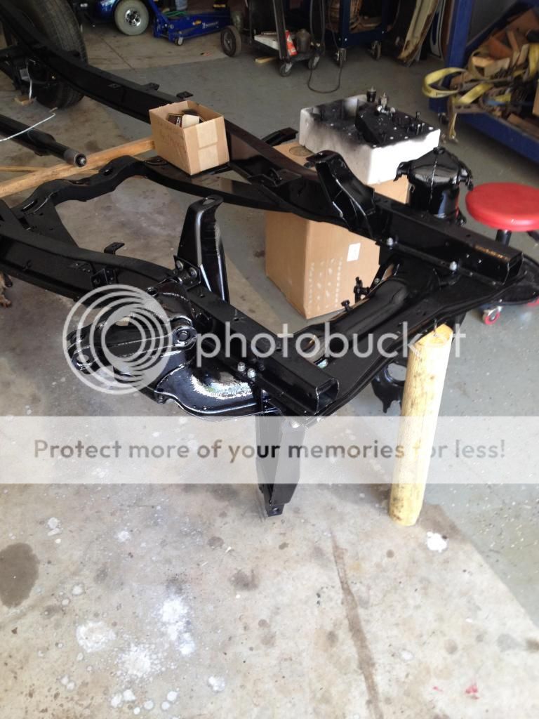

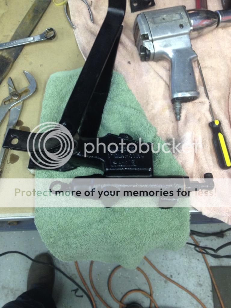

The front cross member and suspension gets completely rebuilt. Blasted, primed, painted, refitted with new king pins, new coil springs (which will need to be cut), all new rubbers, new brakes, and new wheel cylinders.
53 Bel Air 4-door.
Ephesians 2:8-9

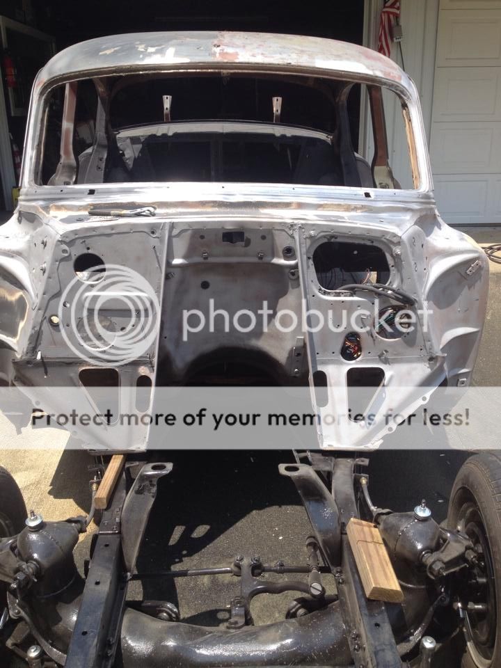

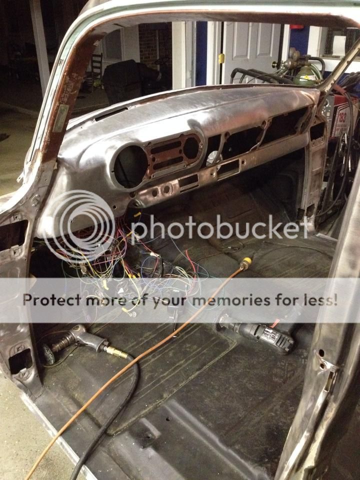

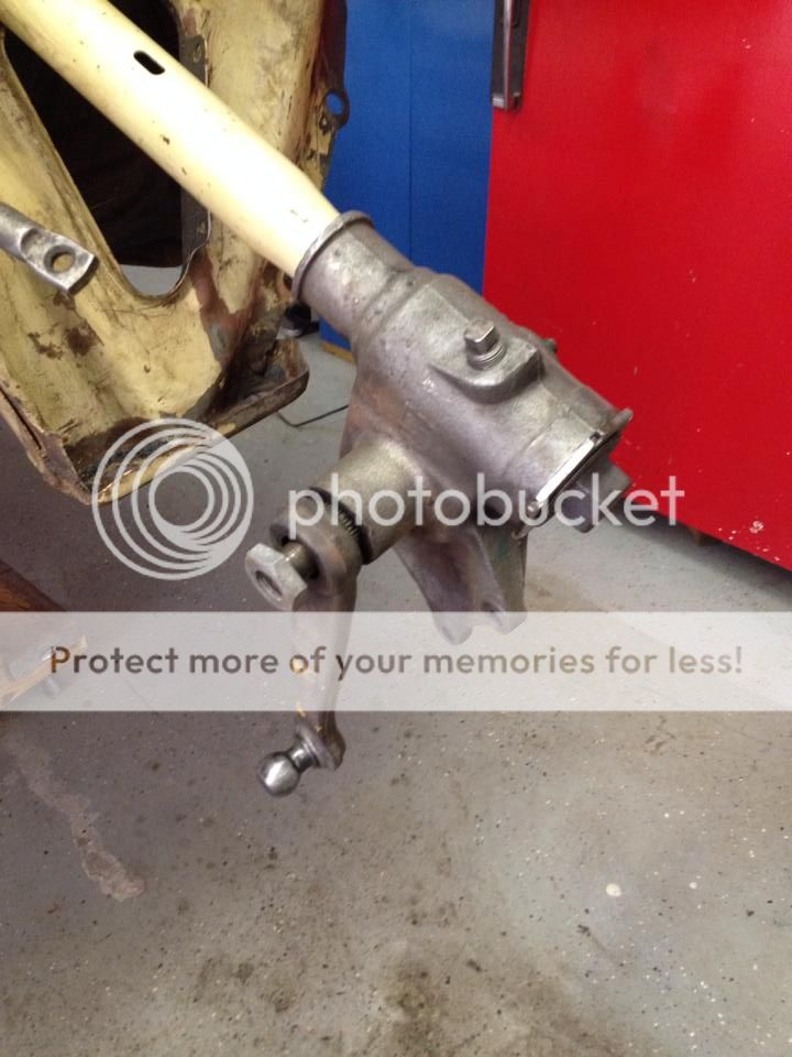

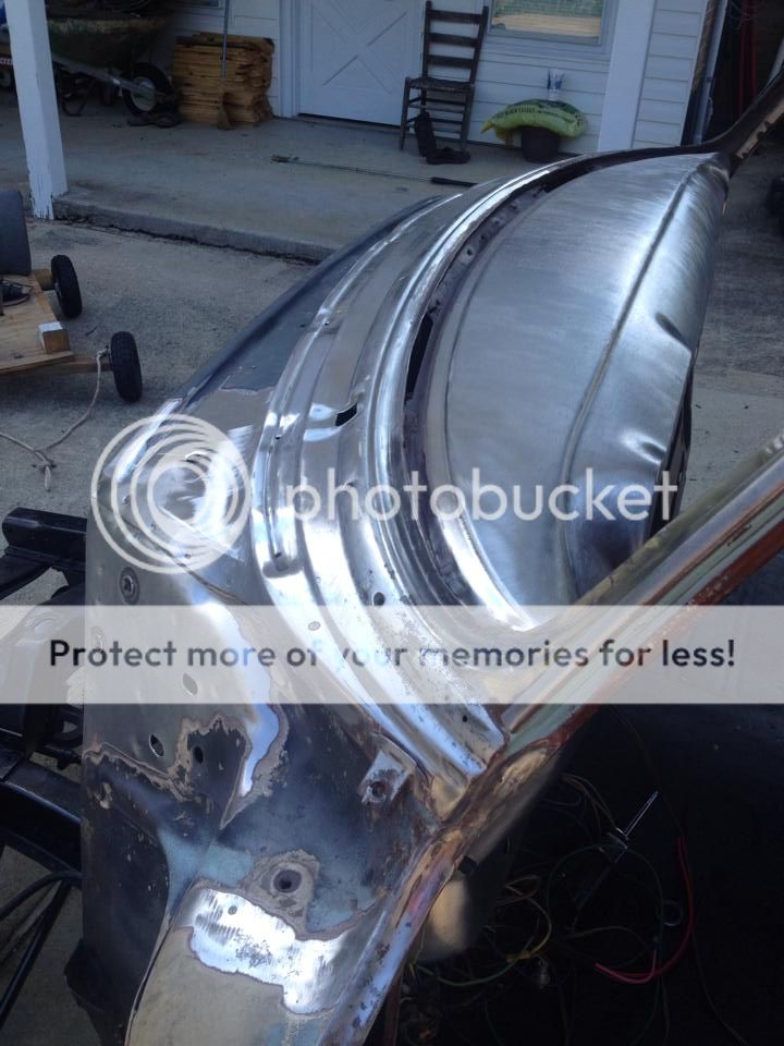

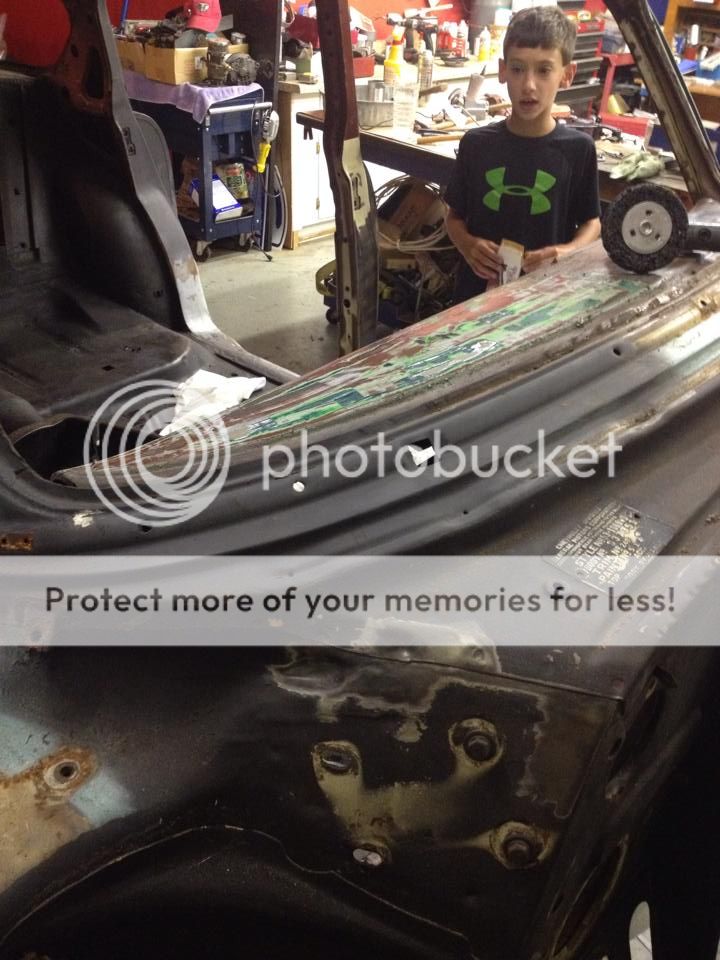

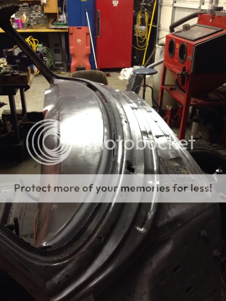

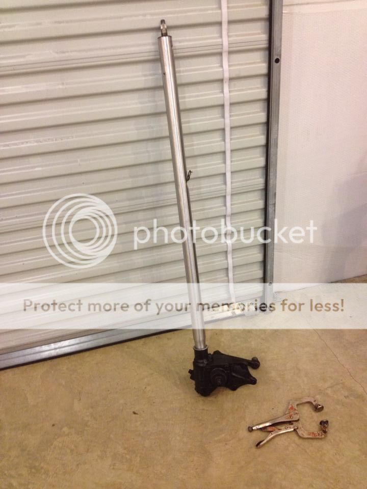

Steering Column de-greased, then pulled, then cleaned and stripped - ready for primer.

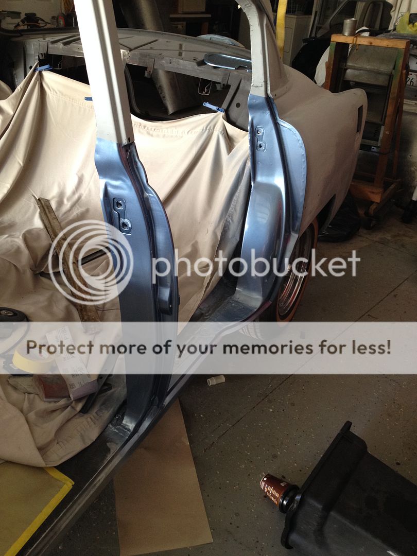

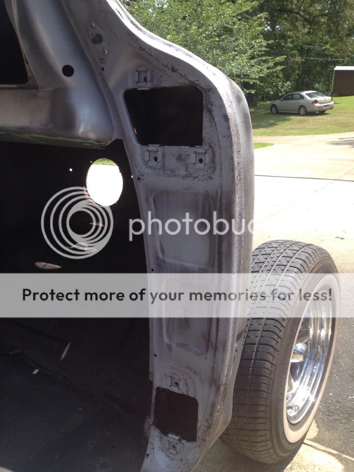

Now with ALMOST all the body metal work done, (still a few very small holes to clean and weld up), I've started stripping the paint from all the rest of the body parts. Here's the hood. It feels good to get them all clean and ready for primer.

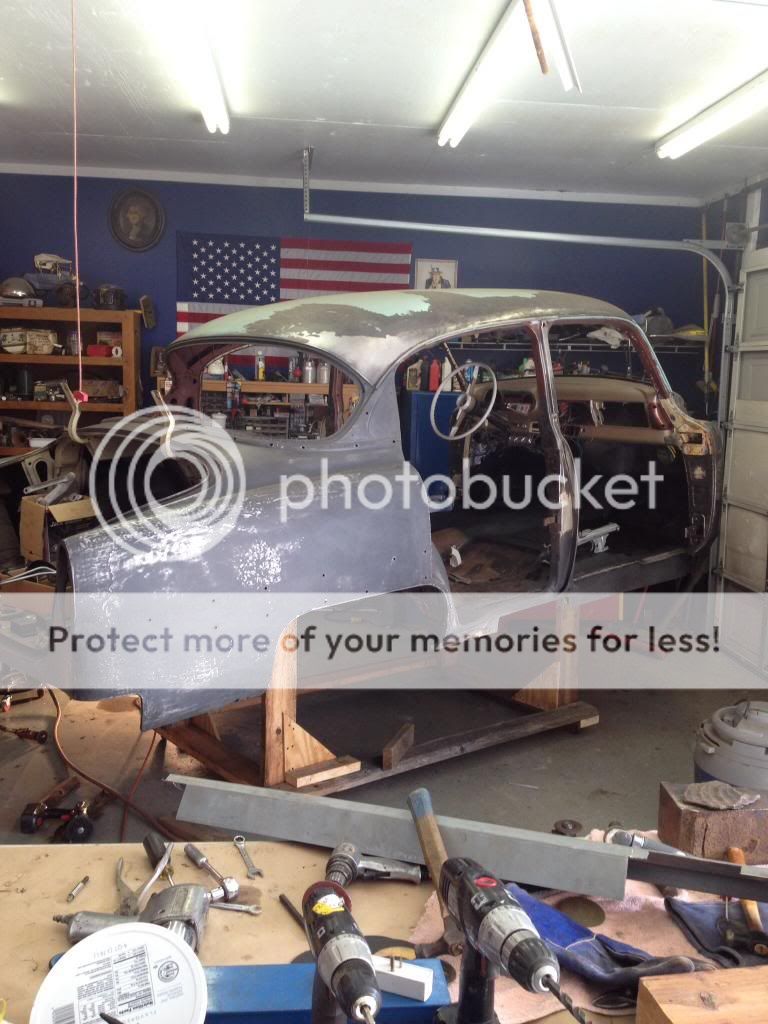

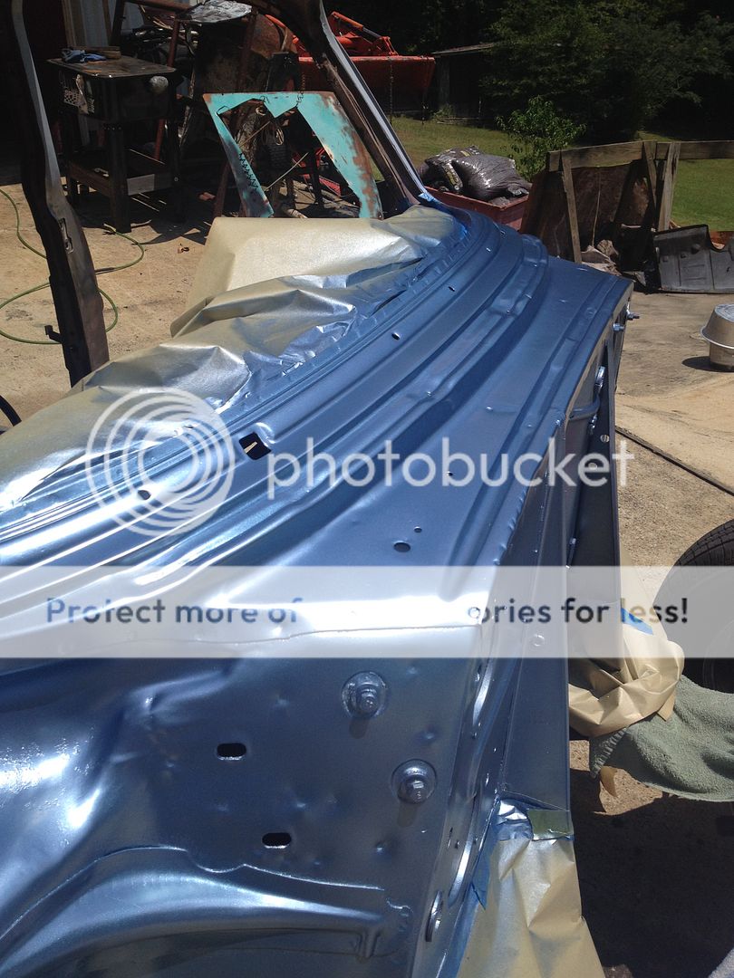

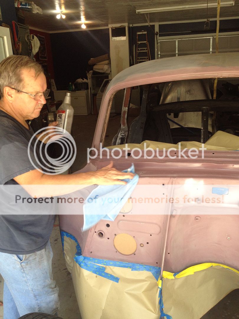

Media-blasting the Firewall. Dad set the body back down on the chassis. I had to be very careful to cover up the front to keep from blasting away our pretty new paint. It got dirty still, but it'll clean up. Ideally, we'd have left the body on the rack we built, but Dad needed the room in his shop.

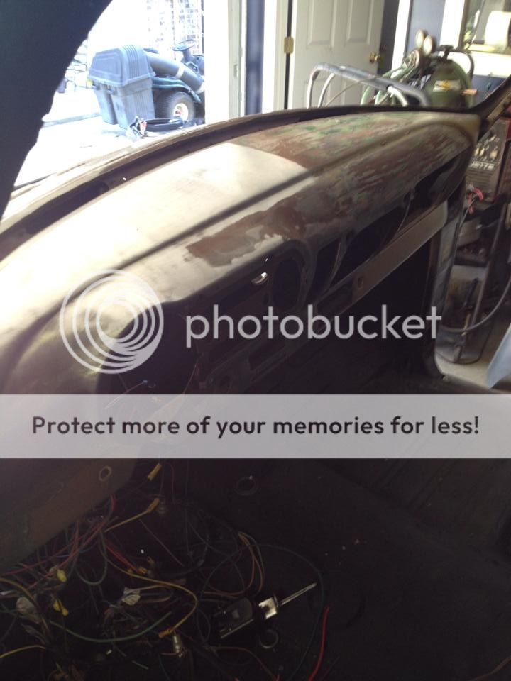

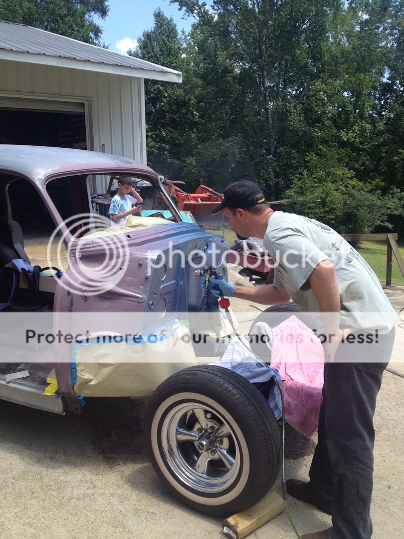

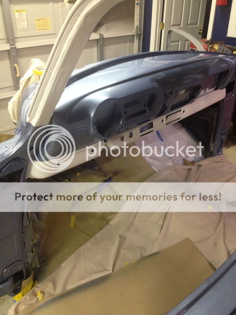

And my best friend, the 3M stripper on the cowl, dash, windshield pinch, etc. That dash had about 7 coats of paint on it! About two layers down was a metal flake green. I don't have the final picture, but it's all spotless now.

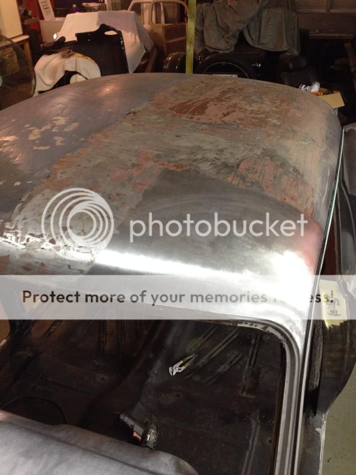

Then I've started on the roof. Three different applications of the paint stripper and I can start again with the 3M wheel. (I'd been paying about $13 bucks a piece for these things at Auto Zone, and then found them at Tractor Supply for $9, and then at WalMart for $8. Just FYI)

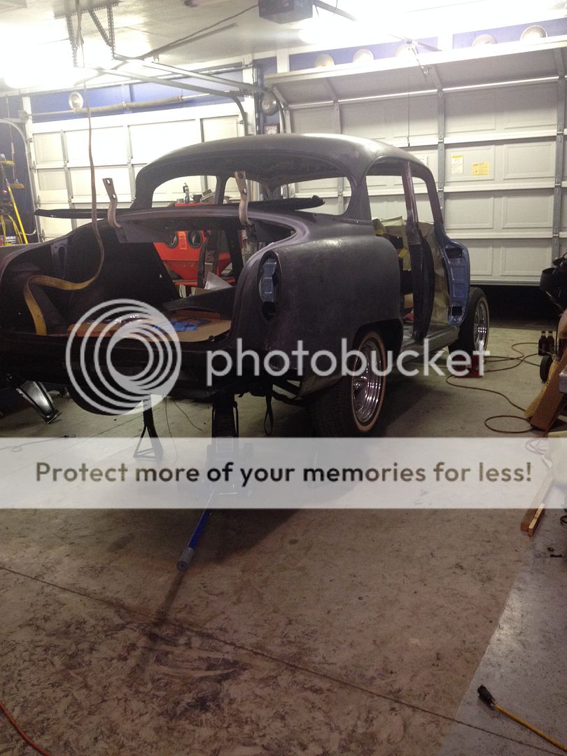

So this is where the car stands right now. I have some other pictures of things like the exhaust manifolds I've blasted and painted with high temp silver, my seat frames that are bare, one painted, one not yet - I've got the radiator restored and painted, ready to install, etc. I'll get some pics of that stuff, but it's random.
Next up, inner fenders. One will need work, I can already tell.
See ya on the next update!

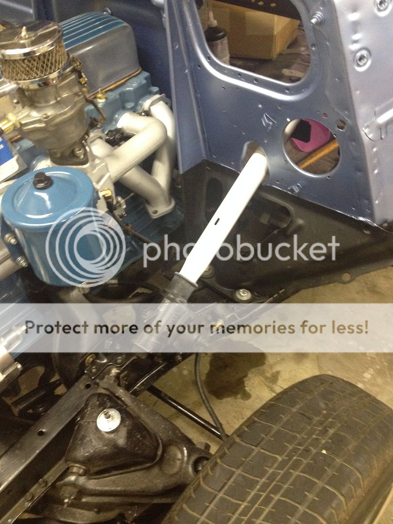

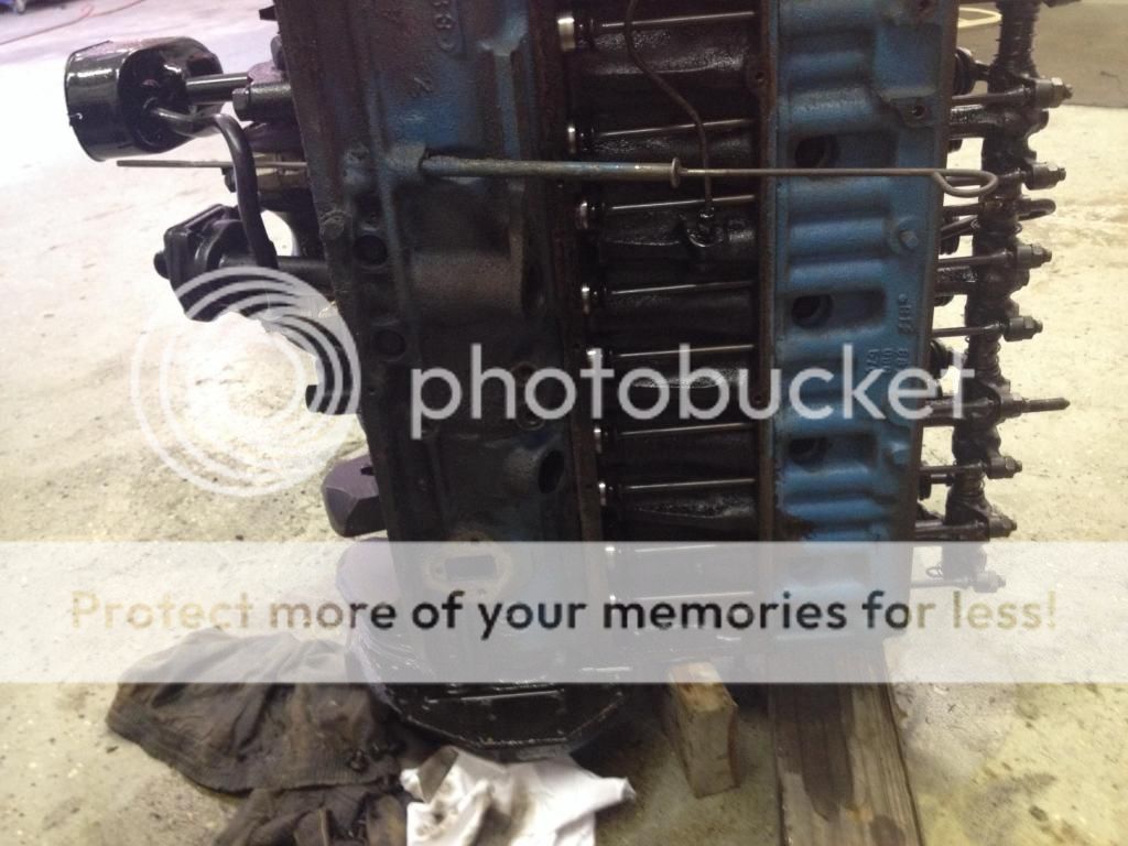

09-30-14 07:29 PM - Post#2487818

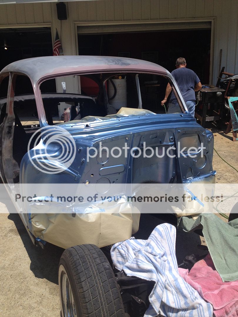

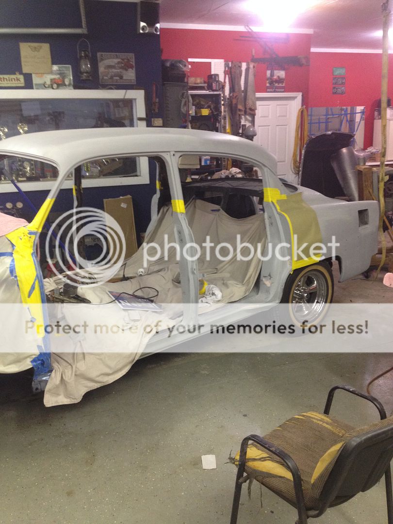

Man, it's been a long time since I updated. It seems like there hasn't been much progress, but looking back at my pictures, we have made some headway. We may have gotten ahead of ourselves just a little bit, but who cares - we picked out our paint and went ahead and got a gallon mixed. Once we got it, we couldn't wait to see what it was going to look like, so we hit our paint-ready firewall and cowl. Much FUN on that day! The paint covered pretty good, but has a lot of metallic, so we'll probably let a professional spray it for us. The top will be white, as will the spear on the back quarters, but the rest will be this blue. The pictures really don't do it justice.
After a few layers of clear, I think this thing's gonna turn out OK.

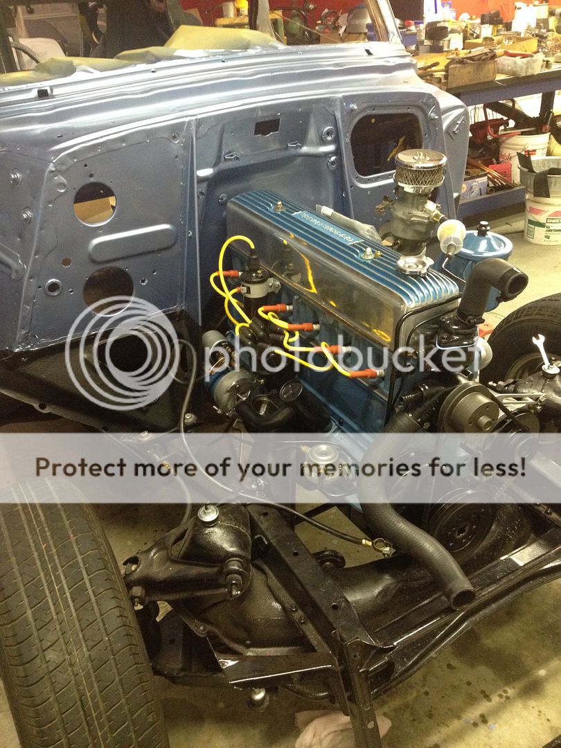

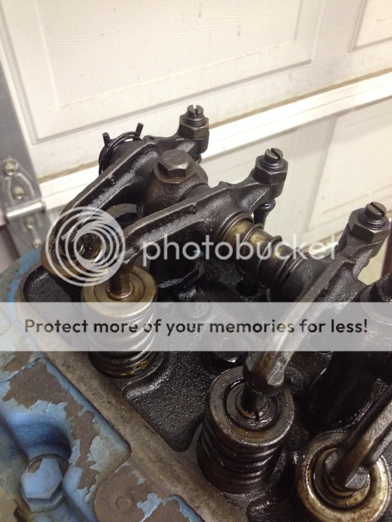

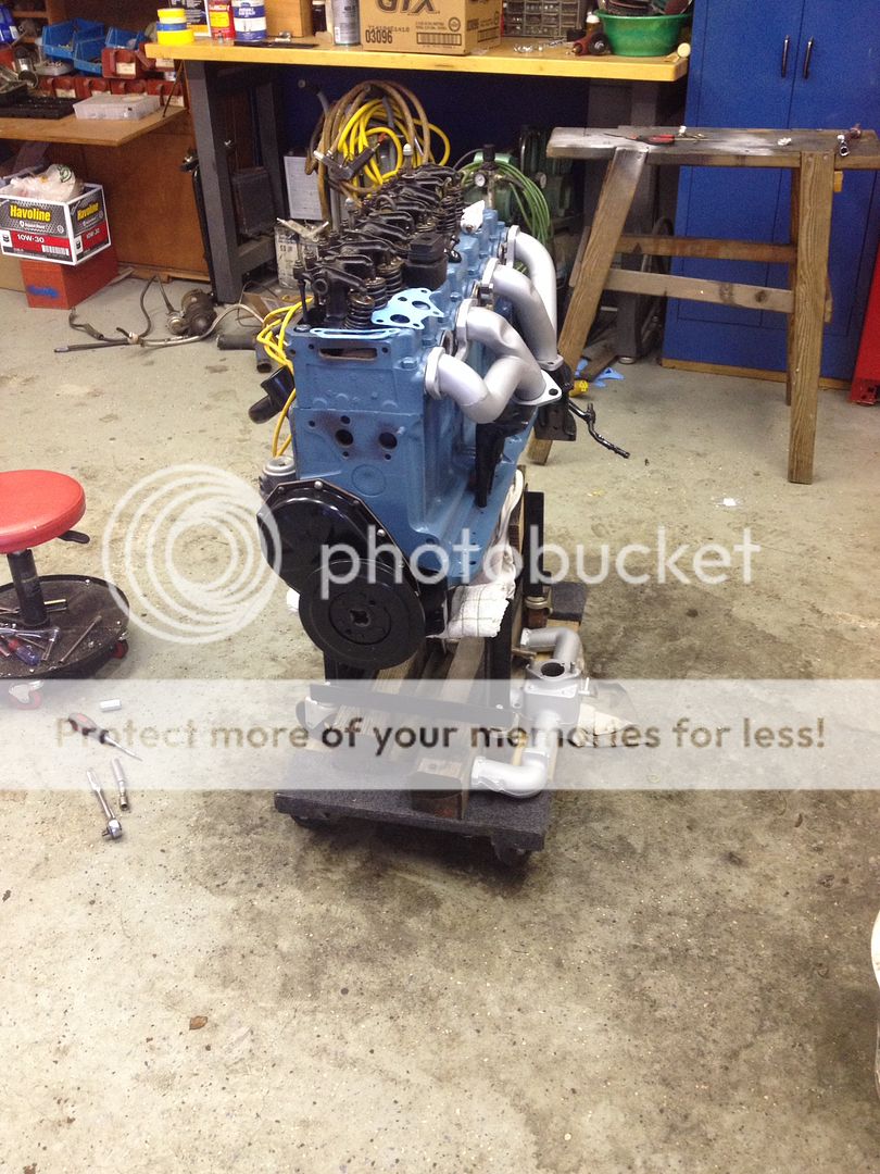

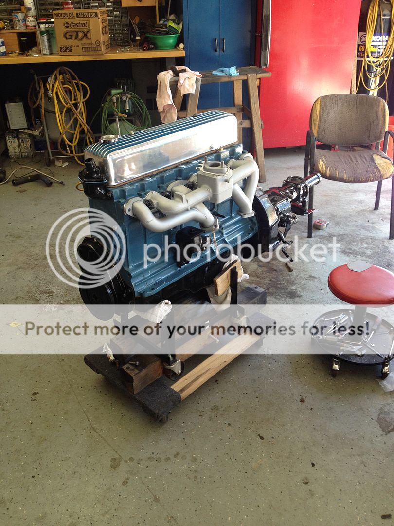

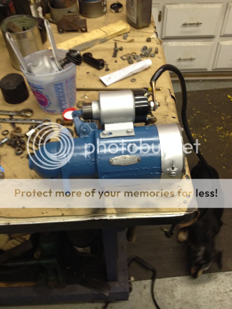

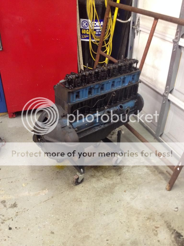

We then took a break from the body of the car and focused on getting our engine back like we wanted it. Totally stock, (Offenhauser valve cover came with the car when I got it and I don't have an original). This wasn't a rebuild; mainly a go-through, clean up, repaint, regasket and seal, and replace things we could. To be honest, internally - this motor was CLEAN!!! It ran really good before the tear down, so we didn't feel like we needed a total rebuild. Once looking inside, we agreed not to "fix what ain't broke".
Few things left to button up on the engine - fuel line connections (we lost a piece), hook up accelerator, etc. Hopefully, we might fire it up this week.
I also bought my white paint the other day, and we hit a few parts with it. These are pieces of the steering column. I think the white and blue will go together nicely.

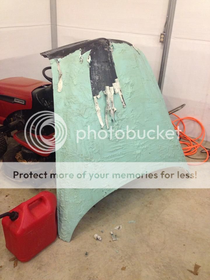

I've done a TON of work getting the inner fenders done. Rot repair, weld, re-weld, grind, clean, and paint with POR 15. I've heard some bad stories about POR 15, but I love it so far. No pics (thought I had some) but they look fantastic. Here's a couple of the fan blade and brake/clutch pedals, and a final pic of how the car sits right now.
53 Bel Air 4-door.
Ephesians 2:8-9

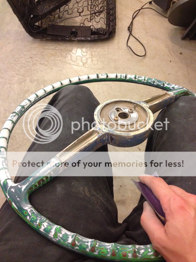

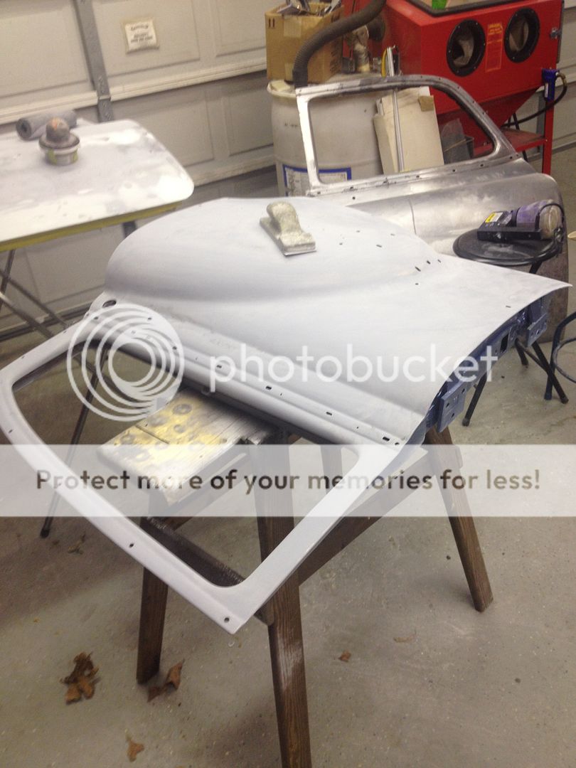

11-16-14 08:56 PM - Post#2499207
A few updated pictures.

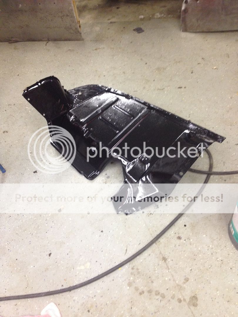

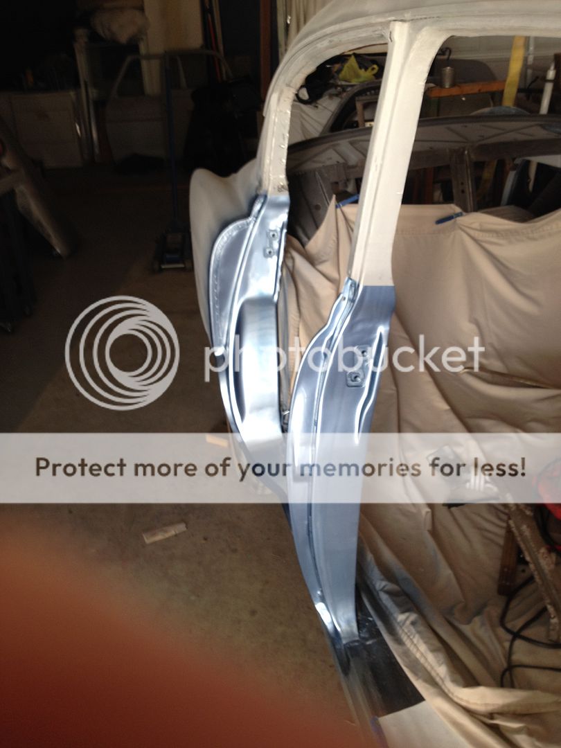

Inner fender - one needed patching, but they were both in pretty good shape. This one is painted with POR15.
All primed up!
Painting door posts.
And the dash
And now on to the outside.

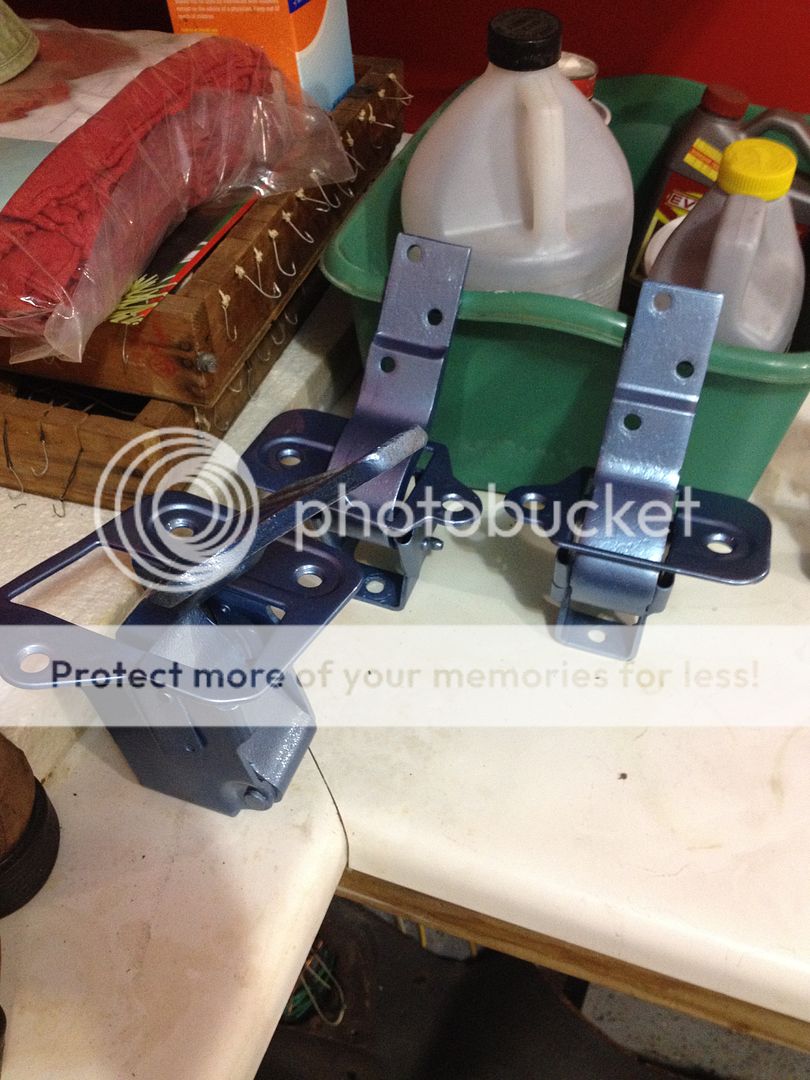

Door hinges. They're now installed.
And a little bit of steering wheel rehab. Can't wait till I'm sitting behind this thing!
53 Bel Air 4-door.
Ephesians 2:8-9
