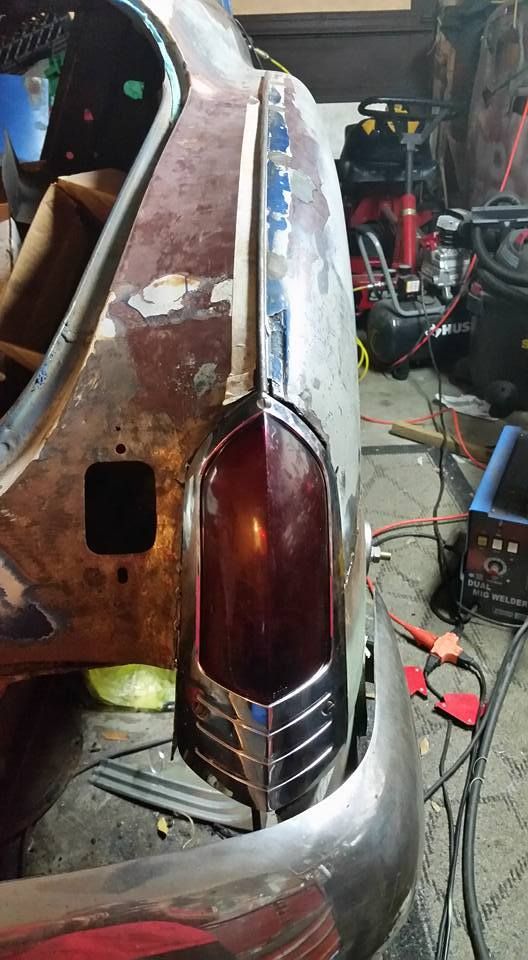

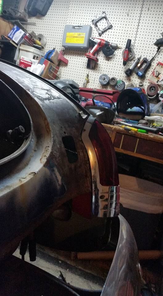

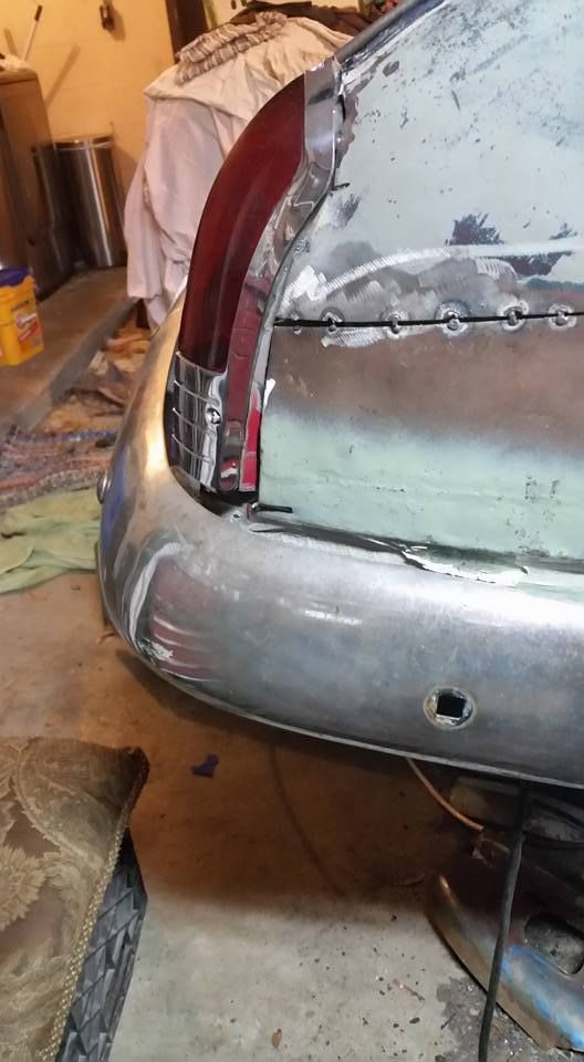

Moved on to the rear to reshape and tuck the 54 front bumper. Since the bumper matches the flow of the rear so well I deleted the splash pan and will mount the bumper flush to the body. I decided to mount the 49 buick taillights differently since I got the new bumper so Ill have to go back and redo the pass side to match. I made a new bucket for the drivers side and mounted the light using a cabinet door hinge attached to a round stock frame. The gas door will be shaved and the filler located under the light, havent cut the hole for it yet as I dont know what style cap im gonna go with yet. I raised and peaked the top of the fender to flow with the new light, the same will happen on the back side of the fender below the light.
Hinged Tail Light Rear
Hinged Tail Light Side
