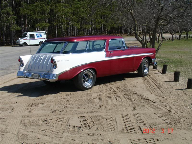

Henrys57wagon
Posts: 3182
Henrys57wagon
Loc: Ontario
Reg: 04-15-06
05-22-12 06:45 AM - Post#2228578
    In response to Nomad Jack
I did not install a seal at the rear bumper either and no exhaust smell. My exhaust exits just before the bumper, good day.
