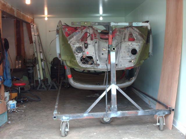

This is my Barbecue grill, the bars in the trunk is fastened in the frame mont holes.

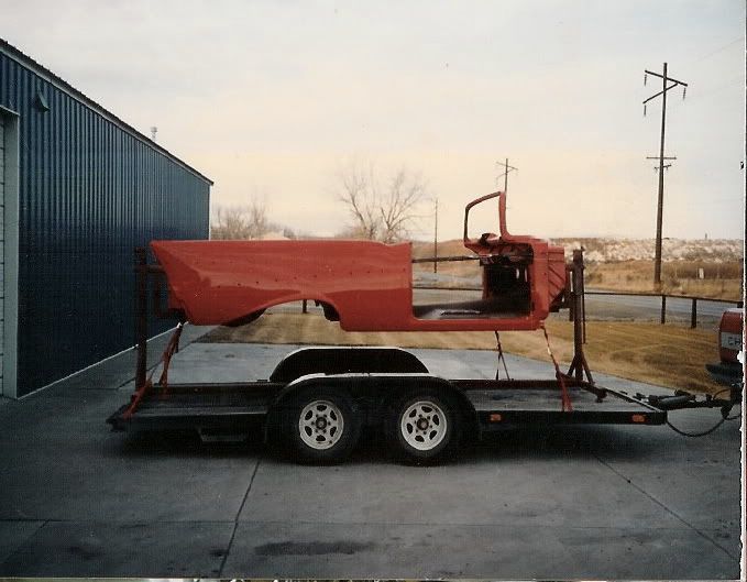

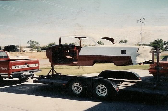

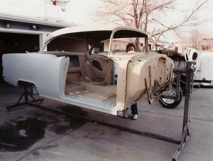

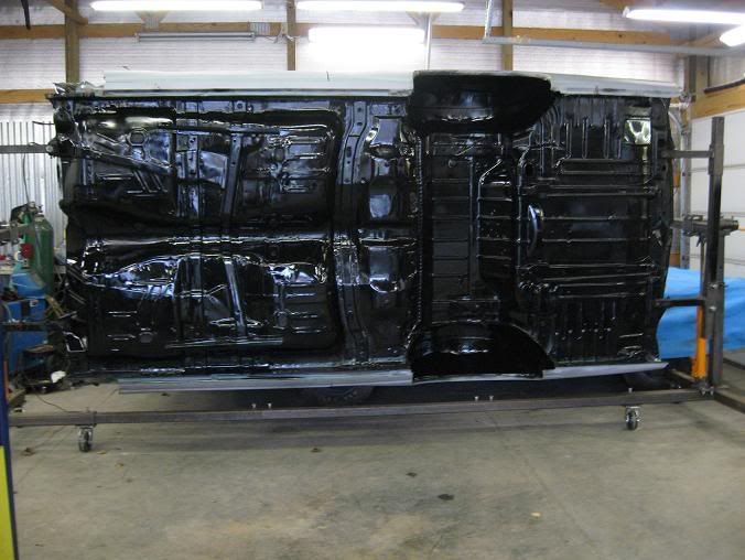

03-29-11 08:56 PM - Post#2069310
    In response to usmile4
Bill

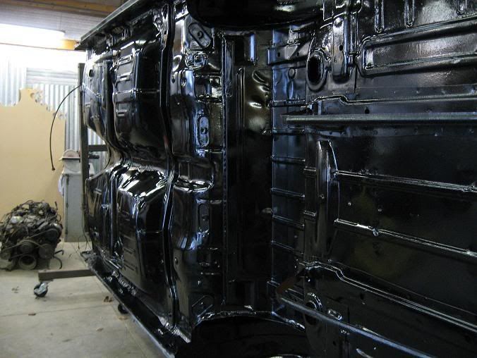

I built this one 21 years ago and have used it for many restorations. I build adapters for the different cars I used it for. Here some photos of it in use.

One more pics off my car.

Sure makes it easy to do all the metal repairs. Your project is looking great.

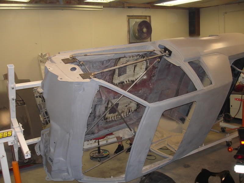

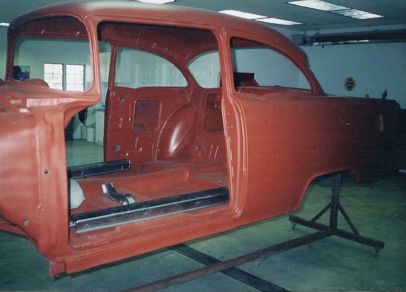

04-18-11 09:46 AM - Post#2078366
I saw this home made wood rotisserie on another site.
I borrowed this store bought rotisserie from a friend to clean up the underside of my '56.

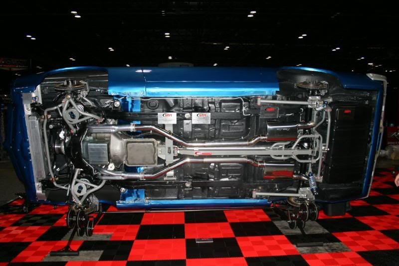

04-21-11 05:00 PM - Post#2080003
heres where i got mine from, hes actually having a special on them if you want one DIRT CHEAP! I HAVE NO AFFILIATION with this company other than being a happy customer.
things work great and are woth the freight..

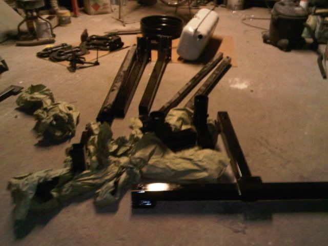

yes, assemble and paint, paint is optional for some, i just wanted mine to last so i powdercoated it.
and your correct the pistons go on that mast then the cross brace and casters..
ill get a shot of it once all assembled, I built my first one my self but it was just a dollie for about 100 bucks.

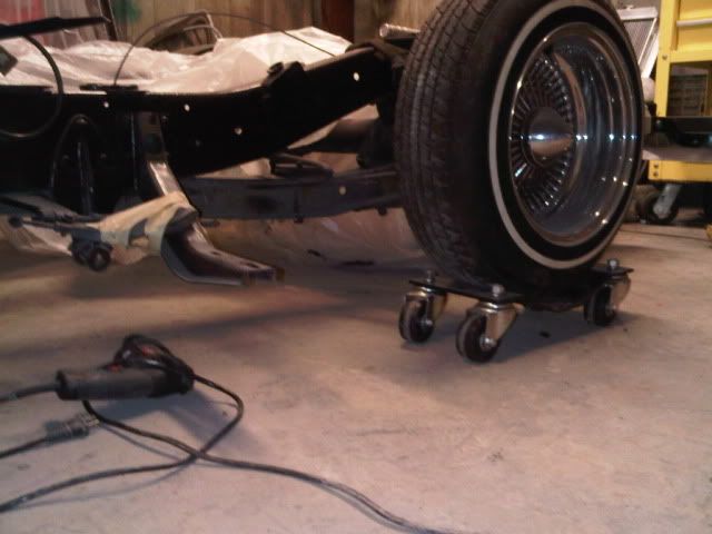

also got some sweet tire skates. these things are a blast to have, push a car acoss my shop SIDEWAYS with one hand.

These things are great, all you have to do is bolt on the wheels, will prob run you same what the Hfreight junk go for..
these things are a breze.. shove a car across my shop floor no problem... if you need better pics of em let me know...
