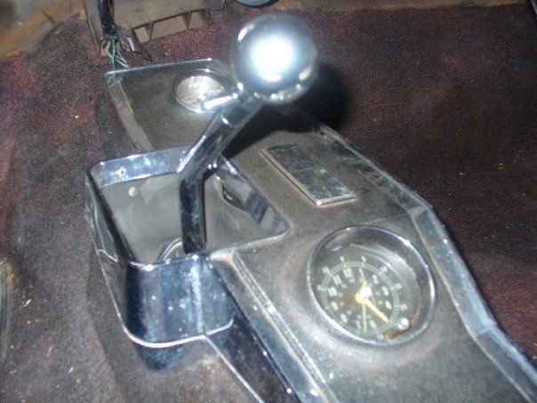

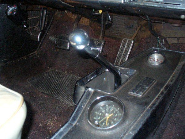

Here are some pictures of the reproduction boot Bill (vet65b) had sent to me. Thanks to you, Bill for letting me have a look at it, and present it to the forum. I'm sure everyone is interested in this part - whether they have an SS or not. This product is very exciting for those in need of a new boot for their 65 SS cars! It's been a long time coming.
My first impressions of this boot are good. The consistency and weight of the molded rubber is very similar to the original.
As with any copy, the finer details are slightly lower in quality than the original, but overall, quite good. The finish is more shiny than the original which will be obvious to anyone who knows what an original one looks like.
The area that slips over the Muncie shifter handle rod is kind of rounded on the top of the opening, where the original is trimmed flat on the top of the rubber.
The rubber has no apparent odor like most imported rubber products, so your car's interior will not smell like it was made overseas!
Rough casting flashings are apparent on the outside of the boot but these will be of no consequence because they will be inside the console and won't be seen.
Although I can't take my console apart to mount this baby up, I trust that it's size is accurate. It looks like the upper console trim holes are in the right place and the correct number of "hump" holes are in the lower rubber flange.
There is the GM part number cast on the inside of the boot with the part number 3860109 and the obligatory MADE IN USA added on the top of the lower flange using a Dymo tape labeler.
All in all, I will give this part a 4.5 out of 5, with the slight deduction for the shiny finish. Perhaps some rubber cleaner could be applied that would dull the finish to make it look original. I have some TEAC Rubber Cleaner that I used in my electronics shop to remove the glaze on tape recorder rubber drive parts, but will not try it on this boot since it does not belong to me.

Nice, but I question if it is correct for a '66 because, from what I can tell, '66 SS's had two separate boots; upper and lower.
I have no idea if the upper boot in my '66 is original - it came with the car. I have had it out a number of times though and there is no way it was ever part of a lower boot. Also, the car has what is left of the lower - including the steel ring, and there's no sign that it was ever part of the upper.
Which brings up a question. Since my original lower is shot (I'm making due with a generic boot) is anyone reproducing the '66 SS lower?
Dan
Dan

Note on your observation of the hole for the shifter handle being rounded instead of flat.
I still have my original boot which I'm getting ready to re-install and it has the rounded top.
I"ll probably just pick one of these up in case my rubber one finally bites it down the road.
I too would try and find a way to dull the finish.

Not sure if anyone else had the same experience, but I just finished installing this boot and I promise to not use any of colorful language that resulted in my wife running out to the garage expecting to find the worst. I did get it installed, but it was not easy. Now that it is installed it looks great though. Here's what I found.
Before you start, be absolutely certain you are done with any transmission/shifter work because you don't want to disassemble/reassemble anytime in the near future!
1) The console attachment holes along the side of the boot didn't even come close to reaching the console hole attachment points. My advice when installing on the hump is to be as generous as possible so you have the most material you can to get the boot to stretch up for console attachment.
2) Make sure the boot is warm and pliable.
3) I ended up using 4 awls to line up the four holes with the console and let it stretch over a number of days to finally get the boot installed.
4) Per the included instructions, start with the long screw on the passenger side toward the firewall first.
5) Be aggressive! Use an awl through the cover, then stretch the boot up to get the hole in the boot to go over the awl. Then try to move things down and get the awl into the matching screw hole in the console.
6) This is where it got really colorful! Push down on the cover as hard as possible while pulling the awl out in an attempt to keep the boot in place and the holes aligned. Hopefully the holes will stay aligned and you can get the screw in and started. Do not tighten anything down until you've got the last screw in. (Actually, leave as loose as possible.)
7) Repeat for the other 3 screws.
8) Have a drink of your choice and apologize to anyone that was within earshot during the procedure and admire the look of the new boot installed in your 65.
I'ld like to know if anyone had a similar experience.
Have fun,
GLM409
P.S. I recommend the boot, but it is a bear to install.
