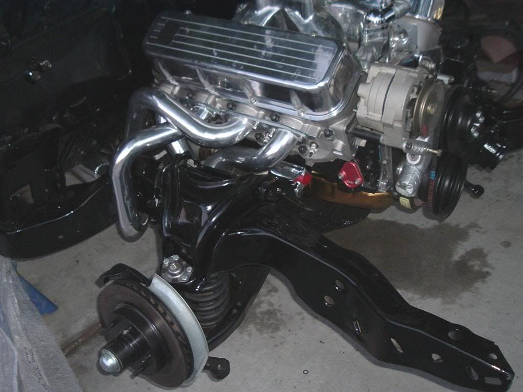

I had really good stuff for the start of the engine ('71 454 block and crank, AFR 335 heads, Isky Roller, Dart intake, BG 1025, etc.) but I figured I'd do a little Krylon tuneup, just to make it look nice under the hood too. Once I started getting ready to yank the old motor out, I decided to take it up a notch, take off the front sheet metal and make the frame look good too. Hmmm, well now that it this far, maybe I should take the rest of the car apart underneath and at least clean it up too Ok, since the motor's pretty nasty I didn't think it needed the AC and what dad didn't know, won't hurt me!

Now he still has no idea any of this is going on. Thank goodness everyone who did kept their mouth shut! After about 10 gallons of diesel in my steam cleaner and another 5 gallons of purple stuff (degreaser) It was coming along ok. Looking back, I should have just taken the body off the frame, but at the time I just thinking about cleaning it up and making it look nice. I was underneath the thing for hours cleaning off undercoat and taking most of the paint down to bare metal. As I'm doing this I'm wondering what did I get myself into. Having a good friend with a powdercoat shop also came in very handy! Anything I could unbolt (suspension pieces and parts, brackets pretty much everything) was coated in a nice eggshell finish black! I painted the whole chassis in semi-gloss chassis black. Time to start bolting parts back on!

I decided to take a break from the car and focus on the engine. After all the machine work was done, cam degreed, pushrods measured and made, etc., I put it on the test stand to fire it off, get everything adjusted and checked for leaks. Man, you have to love the sound of nasty, roller cammed big block! I tell dad the motor runs, I just need to get the transmission redone before I can drop it in. He has no idea his car is completely torn apart!

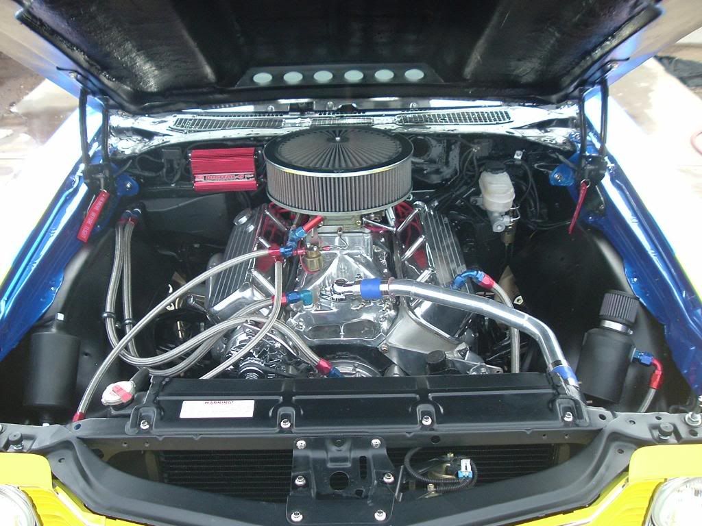

Still need to repaint the rear coils and get the rest of my new fasteners. Now it's cool because dad is no longer bugging me about getting his car back. I made the radiator hoses, just to give it a little flair. Finished it off with silicone ends and t-bolts. Ended up remounting the fan relay, 'cuz it looked so bad. Also made braided hose for the power steering and designed the laser cut bracket to hold both the steering pump and the torque strap to the frame.

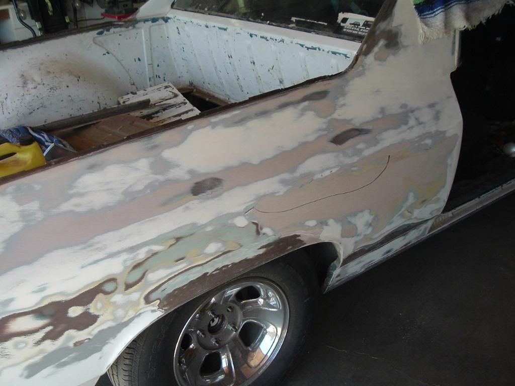

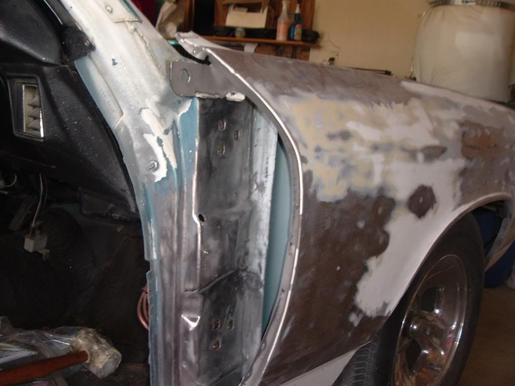

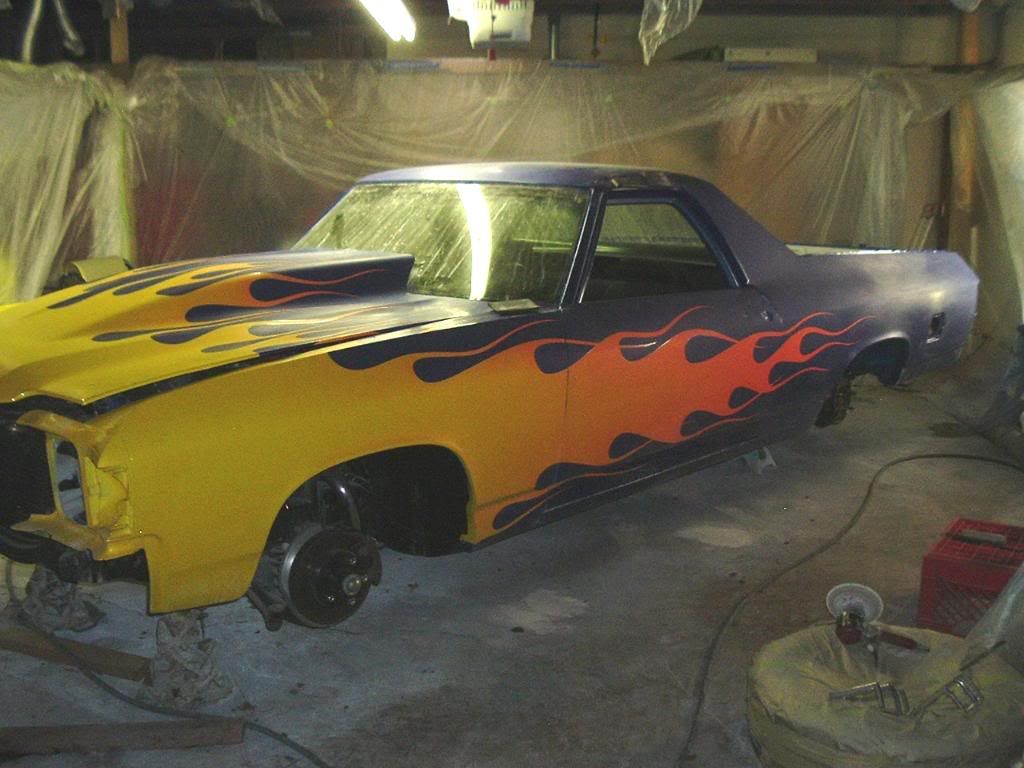

So now what? I've now decided I'm going to repaint it! Being a custom painter for the last 25+ years kinda helps in this area. I start taking everything down with 80 grit to see where I'm at. Holy crap, this car is really rough! I end up replacing both doors, the pass. fender and strip the quarters down to bare metal! I end up doing a panel at a time, stripping it and starting all over! NO end to the bare metal madness! So now it's ever so slowly (this is over months!) coming along. After priming and blocking (LOTS of different sized blocks) 4 times (lots of primer too) it was actually looking really straight! WOW! Now dad knew I was painting it, but I just told him I was going to do it white again and do something cool with the cowl stripes, 'cuz I didn't think it would be anywhere close enough to do it any other color. Now that it's actually straight enough to paint it ANY color I make the executive decision to paint it blue! Dad wanted it blue, as Marina blue was the original color of the car and where it peeked through, he really liked. I'd worked with a custom painter by the name of Dick Vale for almost 17 years, when I was at this point and we'd discussed different designs and colors and decided that HOK True Blue would really rock on this thing! It's a little darker and cleaner than the original blue and would look really nice. Game on! Car jambed and put back together Since I decided I didn't want to tie up anybodys paint booth for a week (my main gig is pinstriping and lettering, so don't need a booth too often) I decided to convert my garage into a full on booth with lights, exhaust and filtered air system! It worked really well. My parents came down to my other daughters graduation and I was hoping to have the car painted. Didn't quite make it. Dad showed up to install gauges and help with other stuff (I'd lied to him and told him I was still working on one of the quarter panels, so he had no idea the car was ready to be painted!) I said no gauges, you're going to help me paint! He looked at me rather strange and I said yes, paint. I said I'd lied (again, he's a slow learner!) and told him we're not painting it white either. We're not? Nope, True Blue with FLAMES!!! Oh yeah, flames baby! He flipped and spent the next few days stuffed in my garage helping me paint his car! After basing the car out in white, I laid out and we masked off the flames

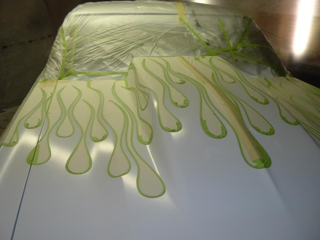

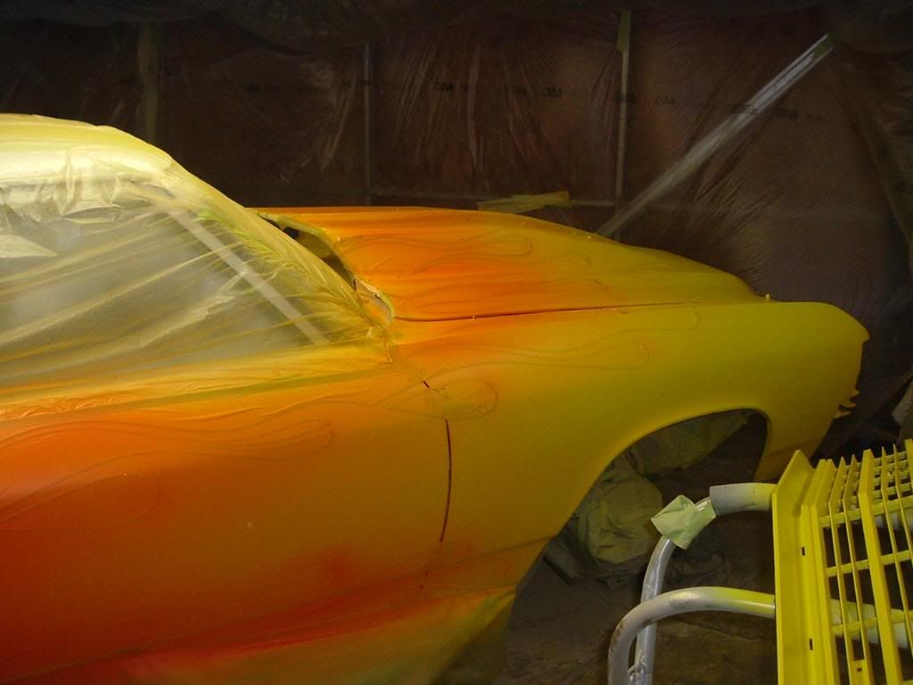

After the flames were painted Flames are HOK pearls, so they glow! Here's dad helping to backmask the flames to get ready for the blue Here it is painted, cleared and color sanded. I left the plastic up on the sides (took the roof plastic off) so I wouldn't get compound splattered everywhere. Here it is rubbed out and the beginning of the pinstriping

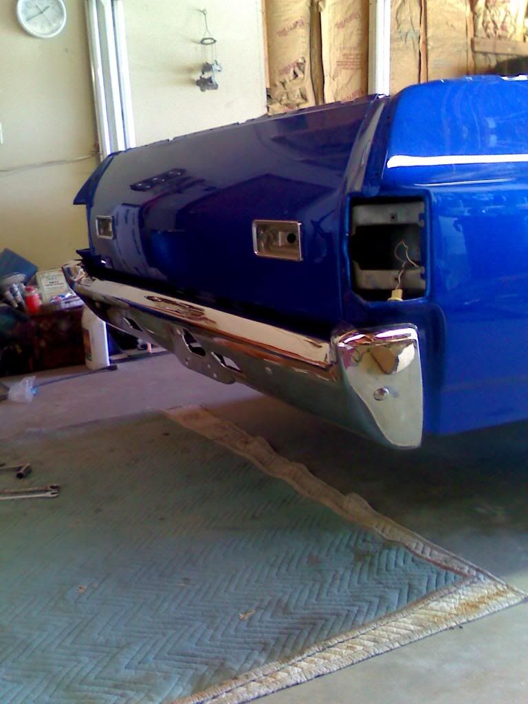

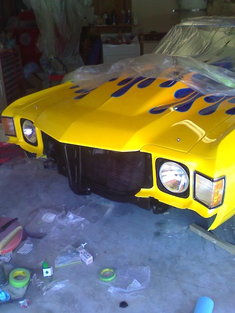

Now to start putting it together! Bumpers re-chromedI ended up painting the black outline around the signals yellow 'cuz I thought the black killed the front. Did the back ones blue.Notice the yellow striping in the flames and the dark blue on the outside. They go all the way to the gas door! Went to the inside and recovered the seat in black/black cloth and vinyl. New door panels, rubber, channels, carpet, etc. Also notice the shifter mount and use of the original column shift mount to hold the shift light!

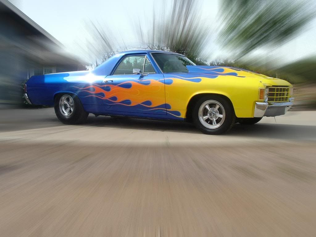

Mounted the trans cooler in the bed to keep the radiator openThe battery is also mounted in the bed. Made a pattern and had my friend Ron bend up and dimple die this aluminum piece for the back of the cowl opening.and the finished engine compartmentFinally, put 5" wheels up front w/165's and 295x65 drag radials in the back, trimmed about 1/2 coil off the front springs and it looks as good as it sounds!

Took it up to dad in August (He flipped!) and he had it in time for the big car show they have in town every year. He won his class! A few weeks ago I went up to help him get set up in the Boise Roadster Show (his first real show) and he was ready! He's built some really cool stantions out of his buddy's Pro Mod car rods and pistons! Took first place in his class too! Here I am pulling the car out of the building. http://www.youtube.com/watch?v=OroWTZRZGBw It was a lot of work over a period of 3 1/2 years but it's been fun watching the world's oldest 15 year old have fun!!!
