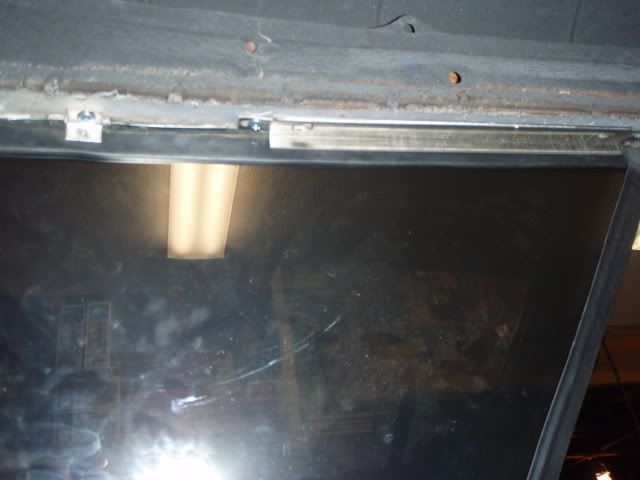

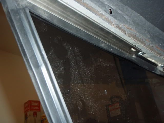

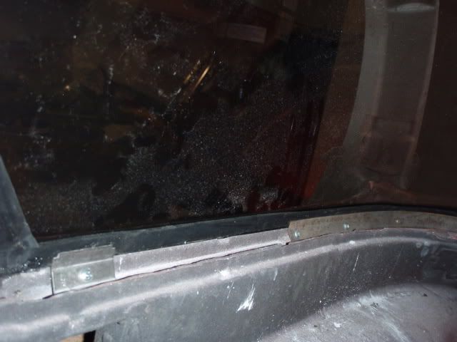

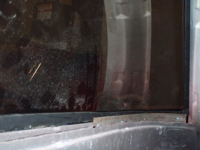

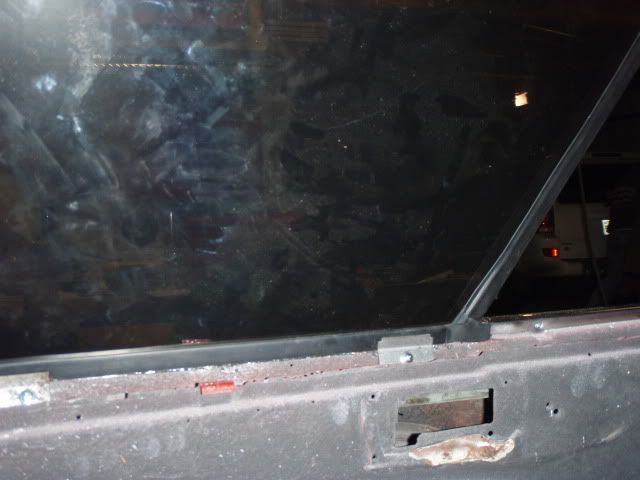

01-17-10 04:50 PM - Post#1844117
    In response to chevynut
Chevynut,
Here are the pictures I said I would get for you.
Hope they help!

Excellent! Thanks for taking those pics. I can't see what's at the very back TOP of the curved glass next to the liftgate. Are there more clips there?
I still can't see where all those 16 clips in that kit go. It looks like you used the curved retainer, the straight retainer on top, and a couple of the short clips per side.
Thanks for the pics!
