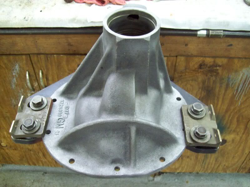

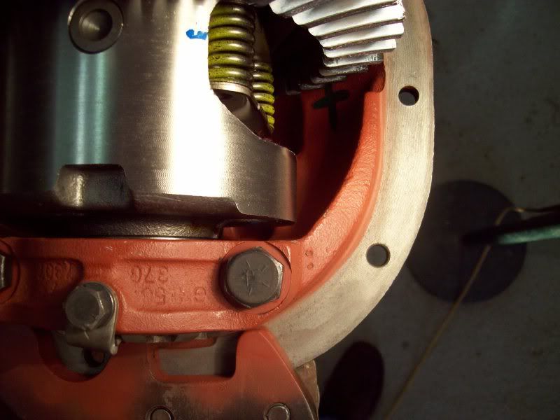

Here is a 55-56 style case with a posi already installed.
This is a 57-64 style NON-posi rear before disassembly. As can be clearly seen, the 57-64 case has a thicker, stronger webbing for the carrier bearings.

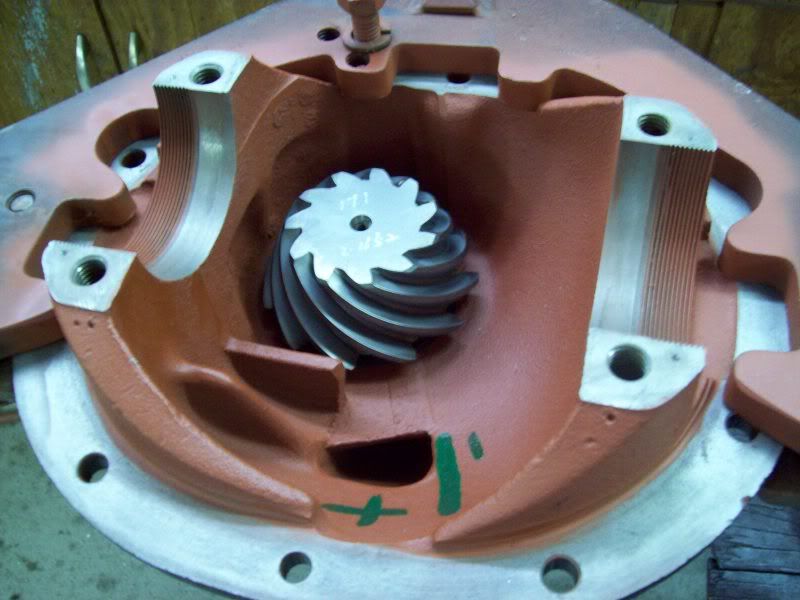

This is the non-posi case after disassembly and before cleaning. Notice the +1 which was hand painted on the assembly line during the original factory assembly process. This +1 marking is related to shim thickness installation on the pinion gear.

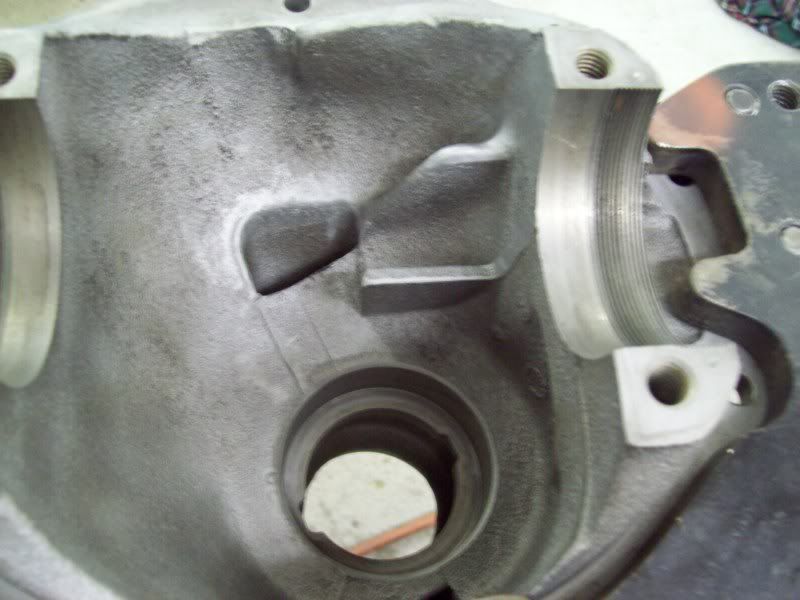

Also notice there are two protrusions that are cast inside the case. The squared off one is in all cases, both posi and non-posi.
The angled protrusion, or gusset, is ONLY in the 57-64 NON-posi cases.
THIS IS WHERE A MODIFICATION IS REQUIRED FOR THE 57-64 NON-POSI CASE BEFORE A POSI UNIT CAN BE INSTALLED. A portion of this gusset must be removed to provide clearance for the posi unit, and it does not matter if an original factory style posi is used or an aftermarket posi unit such as the Eaton is used.
I use a die grinder and a thin cutoff disc to remove the major portion of the gusset. The gusset only needs to be cut off about 1 1/2in from the mating surface for the bearing cap. It is important to remove the portion of the gusset ALL THE WAY to the inner wall of the case.
Here is the case after the portion of the gusset is removed. After cutting the larger portion of the gusset with a cutoff disc, I use a rotary file in the die grinder to remove the remainder of the gusset, then a small sanding disc to smooth out the grinding marks. I also smoothed out the parting lines from the casting mold.

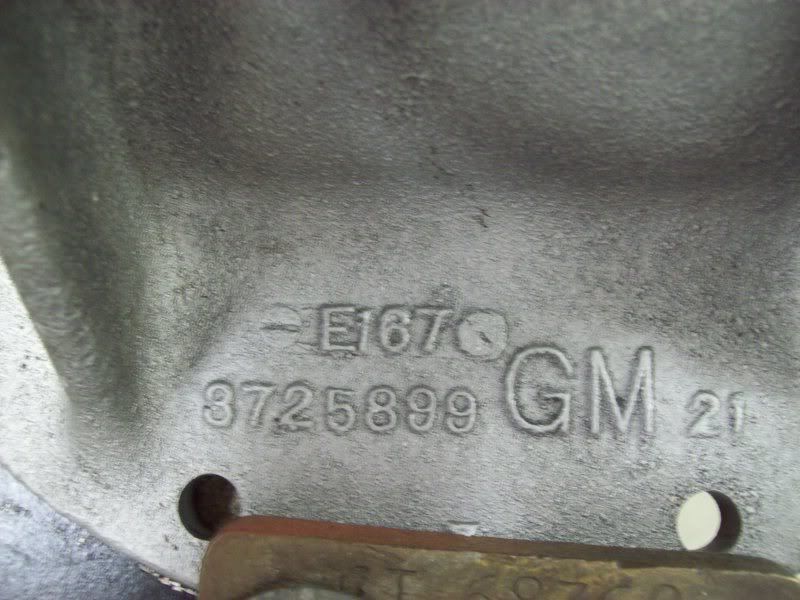

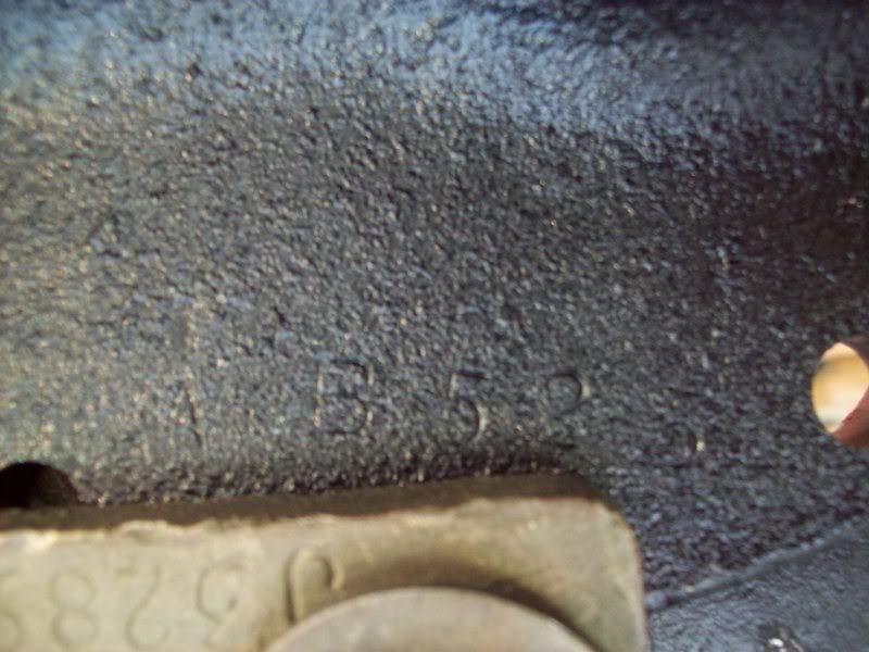

Once the case is cleaned and blasted, it is much easier to read the casting numbers and casting date on the driver side of the case and the ratio code and assembly date (AB 523-May 23) on the passenger side.
Often the stamped code and assembly date seen below is VERY difficult to find and usually requires thoroughly cleaning down to the bare cast iron.

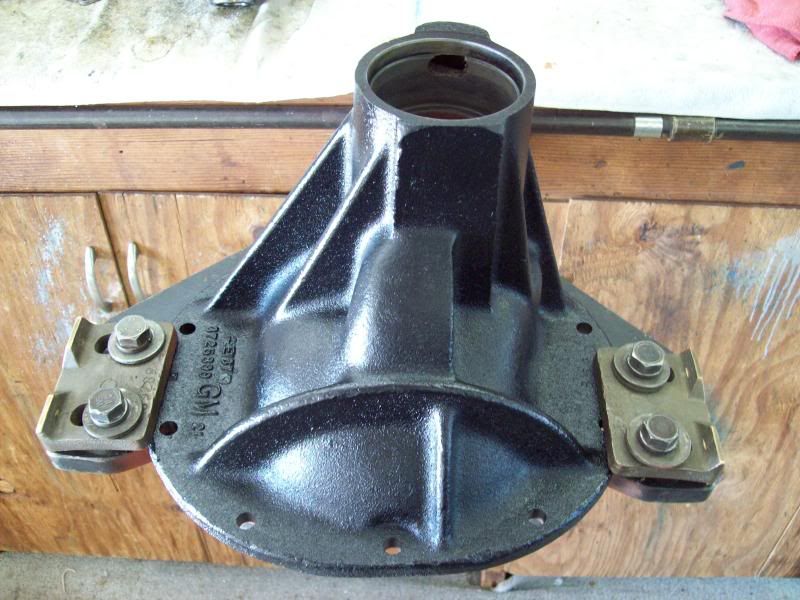

Painting is optional and your choice. Many early cases were painted a red oxide inside and outside, similar to that below.
As can be seen, I hand brushed green paint to attempt to duplicate the original marking from the factory. This step is totally unnecessary because it will never be seen after installation in the axle housing, but some people like it. No extra charge!
As can also be seen, once painted on the outside, the numbers and codes are not quite as easy to distinguish.

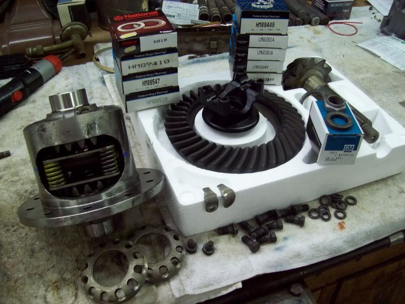

Here are all the parts to go into this case.
The customer wanted a brand new ring and pinion gear set. I wish to mention that if an original Chevy ring and pinion gear set in good condition is available, use it! The original Chevy gears are excellent quality and there is no reason to not re-use them. This is also the new Eaton posi unit, all new bearings, crush sleeve and pinion seal.

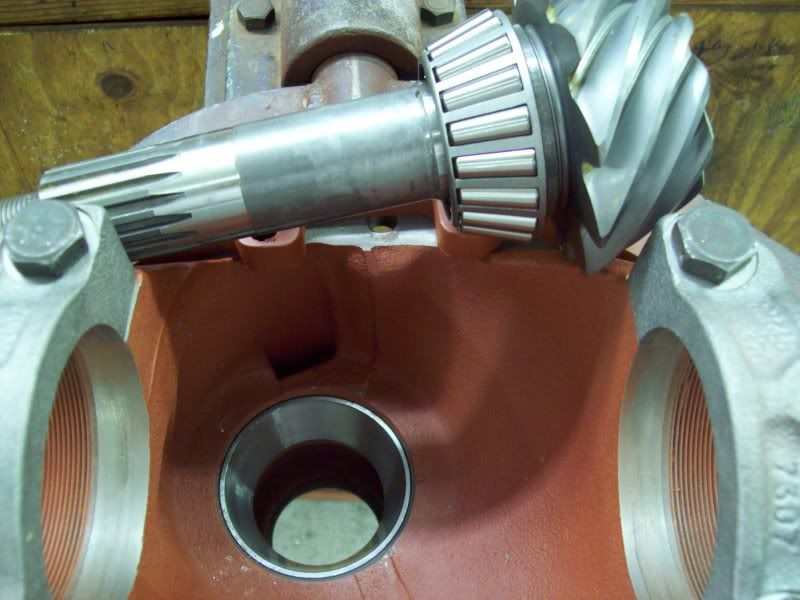

The first thing is to drive in the new pinion races. I have taken a pair (front/rear) of old races and slightly ground down the outer diameter so that they just slip into the holes in the case. I use the old races to do final driving of the new races to the bottom of their respective holes. Since the gears are new, even though the new pinion is marked for pinion depth, I have quit trying to set the depth. I start out selecting a pinion shim of .030in, slip it on and then press on the pinion bearing.
Lightly lube the pinion bearings and slip the pinion into the case, slip on the crush sleeve------------------ NO PINION SEAL YET--------------then the front pinion bearing, the yoke, big washer and pinion nut. Depending on condition of the old pinion nut, you may or may not choose to re-use it. For an original pinion nut that has never been removed, I frequently re-use it (I’ll get a lot of flak over this!).

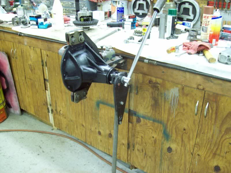

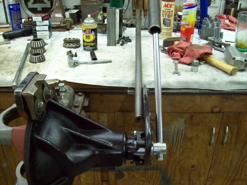

Years ago, I made my own pinion yoke holding tool from a piece of 1/2in steel plate. I cut it to shape with my die grinder and cutoff disc, drilled the holes and drilled for holes for each corner of the square hole to fit a 3/4in drive breaker bar into. I also drilled two holes for attachment of a very long handle which I made from a piece of steel rod.

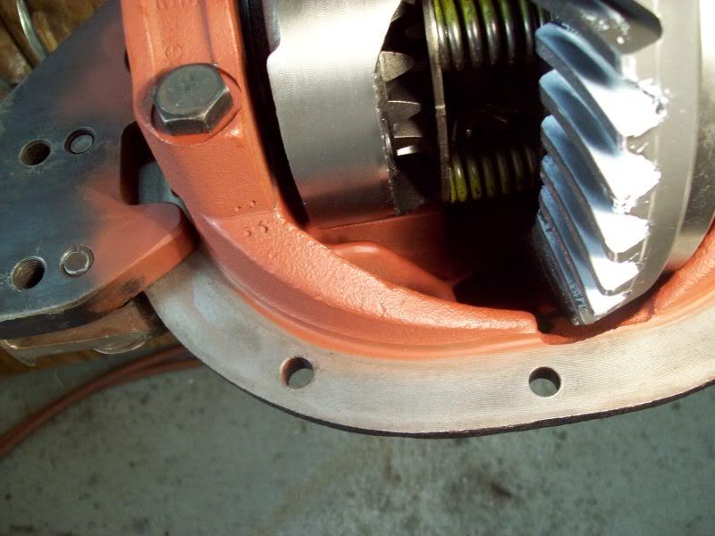

You can see from the next two pictures where the removed portion of the gusset has provided plenty of clearance for the posi unit.

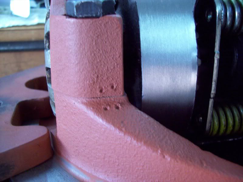

Also, notice the two punch marks on the case and the cap. I do this (failed to mention it much earlier) prior to disassembly so that there is no confusion which cap goes on which side. I make one punch mark on one side, two punch marks on the other side.

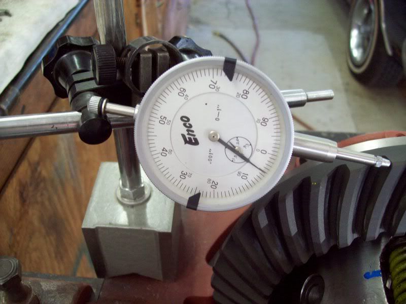

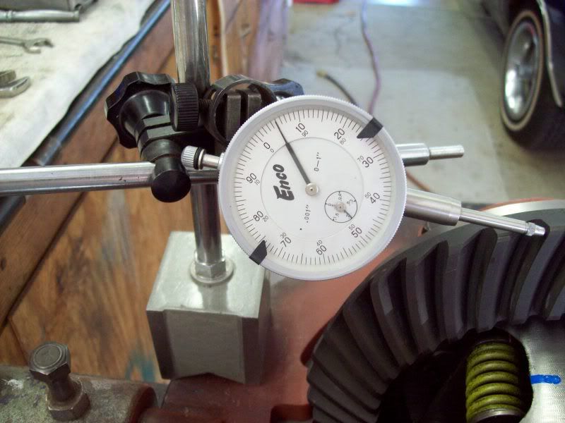

Again, the 56 rearend manual is quite clear about how to set bearing preload and backlash.
Here is my dial indicator showing .005in backlash in two different locations. The ideal range is .005-.008.

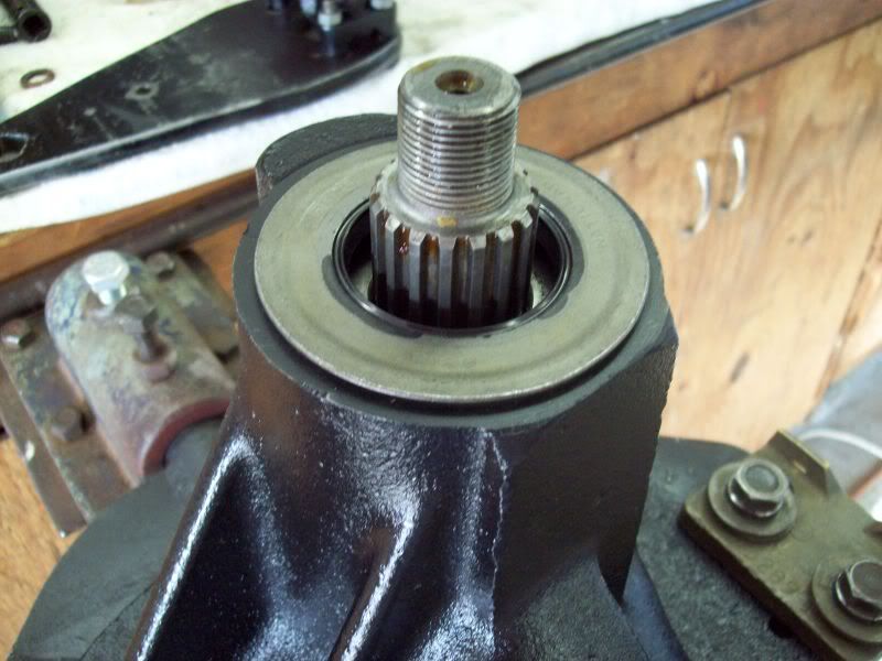

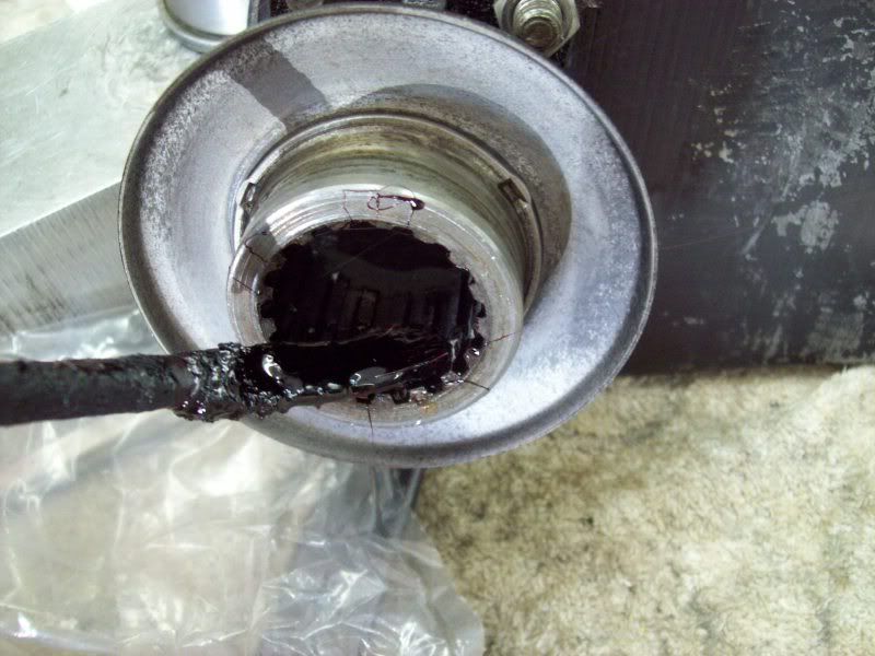

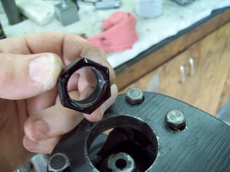

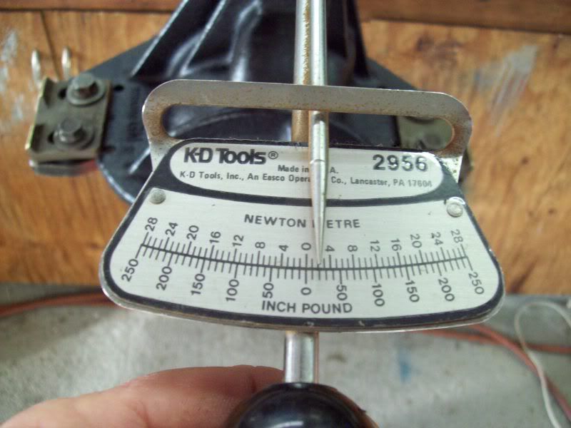

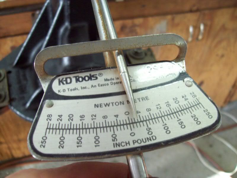

Once all adjustments and setup is complete, remove the nut, washer and yoke and install the new pinion seal. I like to use a VERY light coating of gasket sealer around the seal before carefully tapping it into the case.
Before putting the yoke back on, I THOROUGHLY clean the splines of the pinion and yoke and paint gasket sealer in the splines of the yoke to seal against any oil leaking through the splines. Put the yoke back on, then the washer and nut.
When I first setup the pinion with the new crush sleeve, BEFORE installing the new seal, I only tighten the nut to achieve about 20in/lb preload on the pinion bearings. Once the seal is installed and the yoke, washer and nut is finally installed, I also use gasket sealer on the washer and nut, then finish tightening the pinion nut to achieve the 25in/lbs specified in the rearend manual.

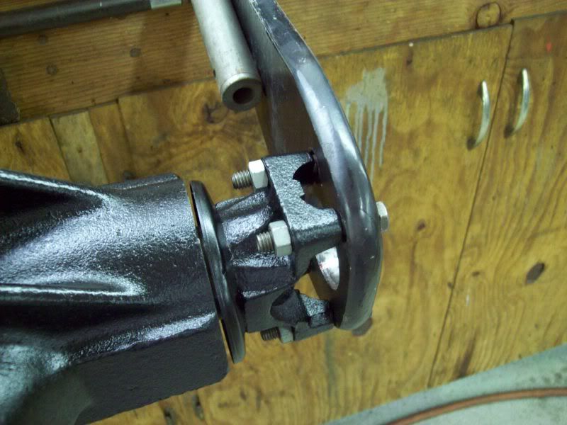

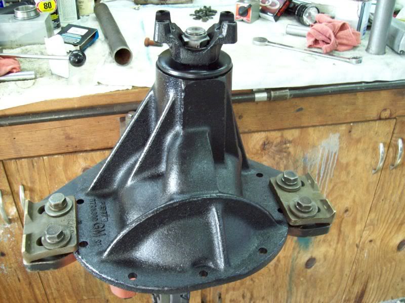

Finally finished.

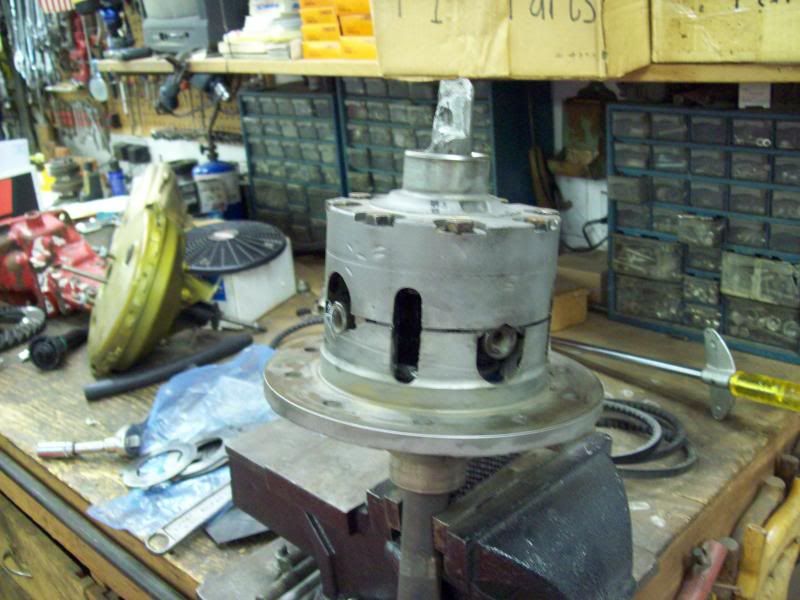

Here is an additional picture that I didn't include in the original information.

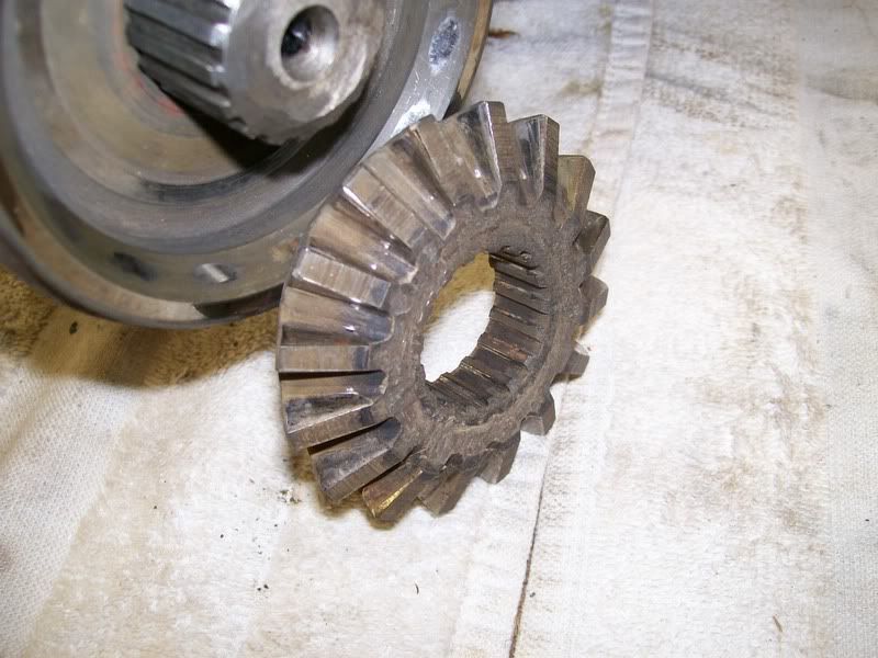

When rebuilding a FACTORY style posi unit (made for GM by DANA), it is VERY IMPORTANT to have the splines of the 2-piece axle gears lined up BEFORE pulling the 2 case halves to gether with the 8 bolts. It is TOOOOOOOO EASY to do!
You need 2 axles to do this with, or the splined ends from 2 junk axles. Insert each axle end ALLLLLLLL the way into both sides of the posi, assuring that they go all the way through BOTH of the 2-piece axle gears. I place an axle in the vice, and then insert the end of a junk axle in the other side of the posi unit and start tightening the bolts, then torque them (45lbs).
If the splines are not aligned when the posi is being reassembled, it may be VERY difficult to get the axles back into the axle housing because they cannot go into the splines of the second part of the axle gears.
Here is what the 2 parts of the axle gears look like when the axle splines are inserted into both parts.

Well, it turns out all my spider gears are pitted as well, as is also the carrier surfaces where these gears sit, so I guess I'll go with a new carrier -- an Eaton posi!! I just picked up a 3rd member kit containing Koyo bearings (made in Japan) that I was told were high-quality bearings. Is this true?
'56 210 Townsman wagon 6cyl/3spd OD | '58 Impala Sierra Gold 348
Member #51
Posts: 8977
04-30-10 06:40 PM - Post#1907749
    In response to LtFrankDrebin
Well, as bad as I hate to face the issue, here is my viewpoint on Jap bearings. Every see a failed bearing on a Honda, Toyota, Nissan, etc?
