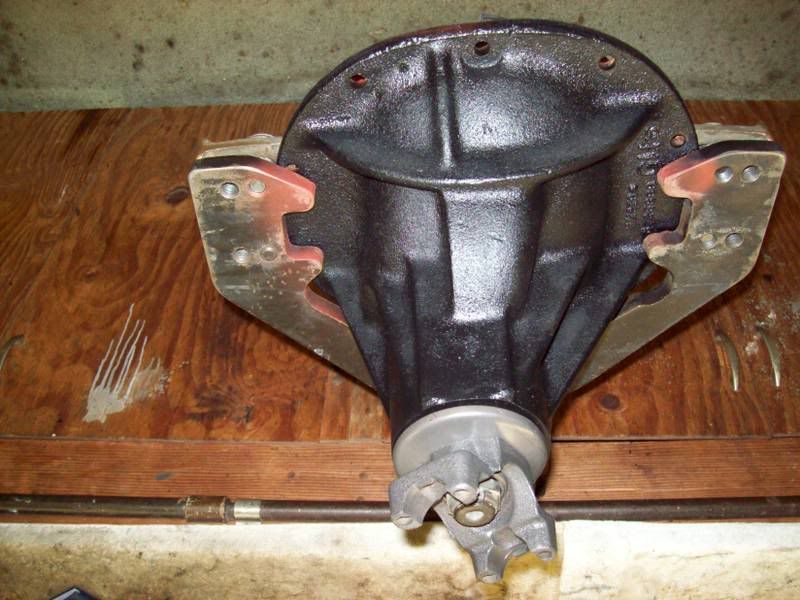

OK, here's what I know, and here's what I've been doing. These rears were built as a complete axle housing assembly (brake drum to brake drum) at one of two plants, Detroit Gear and Axle plant, or the Buffalo (NY) plant. After complete assembly was accomplished, the entire assembly was painted black BEFORE being shipped to the various assembly plants. Now, you know the saying--------don't buy a car built on a Monday because the workers were hung over from the weekend and don't buy a car built on Friday because the workers are in a hurry to get off for the weekend (never heard that? that's older than I am!). My point is that depending on the mood of the worker, time of day (just before break, just before lunch or just before the end of a shift) and the overall quality control at a plant, an axle housing assembly may have received a THOROUGH coat of black paint, or, it may have got a lick and a promise.
The 55-56 and EARLY 57 rearend center cases were painted some sort of a red oxide (like red primer) on the inside and the outside----BEFORE going to the machining processes (if you study an unmolested center case you can tell the machining was done AFTER painting. Sometime during mid-57 production of the rearend center case, the inside was no longer painted, and apparently the outside ONLY got black paint. How thoroughly? Again, that's anyone's guess!
Now, the first picture below shows how I finish MOST rears for customers--------------I ALWAYS consult with the owner FIRST before finishing/painting. My PREFERRED paint is satin black. The ACE hardware stores carry BOTH Rustoleum and their own in-house brand called Rust Stop. The ACE brand is about $1./can cheaper. It appears to be an enamel based paint and takes most of the day to dry to the touch and about 3days to cure. I paint the CASE (NOT the caps) BEFORE assembly then wipe off the over spray from the mounting flange and the bearing surfaces with lacquer thinner, brake cleaner, whatever. If a rear is a 55-early 57, and the interior red is faint, then I paint the inside (and outside if owner prefers) with Red Primer from ACE. On mid-57 and later, I DO NOT paint inside. SOME of the rears have hand brushed paint markings on the inside that designated pinion shim thickness (this marking IS NOT the shim thickness, it is from a table in the manual for rearend assembly). After a case is cleaned, I thoroughly blast it down to bare cast iron inside and out (if the inside can be just cleaned and the paint marking is clearly visible, I don't blast the inside, but if I do have to blast the inside and there is a hand painted shim marking, I re-paint by hand the shim marking). Now, again, per the owner's preference, I either paint the pinion yoke with the same satin black, or, since the pinion yoke has been blasted to bare metal, I VERY lightly dust it with a cast blast coat. This retains the appearance of a bare yoke, but also provides some protection from surface rusting forming. You can see this in the first picture.
Here is the inside of a virgin EARLY 57 case that I only cleaned.
Here is the inside of another EARLY 57 case that I blasted, painted and hand painted the shim marking.
This is the outside of that same case after painting satin black, befoe assembly.
This is the outside of the same case after assembly and the yoke painted satin black.
This is the inside of a 59 case (after thorough cleaning). NO PAINT, which is what the inside of a 58 case would look like.
This is the inside of that same 59 case after blasting (notice shim marking is now gone) and after I trimmed away a portion of the gusset to allow room for installing a posi unit.
Soooooooooooooooo, with all that said, was the entire rear (including yoke) of a 58 black, was the yoke seperately bare metal, or what? Your guess is as good as mine. BUT, based on the knowledge that I've picked up over the years, EVERYTHING between the drums should be (chassis) black. OK, so where did I come up with the bare metal finish on the yoke? Darn, I admit, oldtimers disease has got me------------I don't remember. But several owners prefer the black case and bare metal appearance of the yoke, including a particular owner who has me build rears for very early Vettes (which use the same rear) that are meticulously restored.
