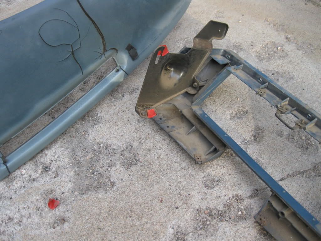

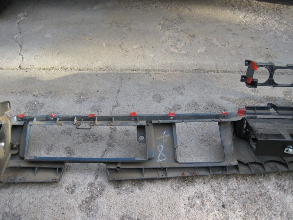

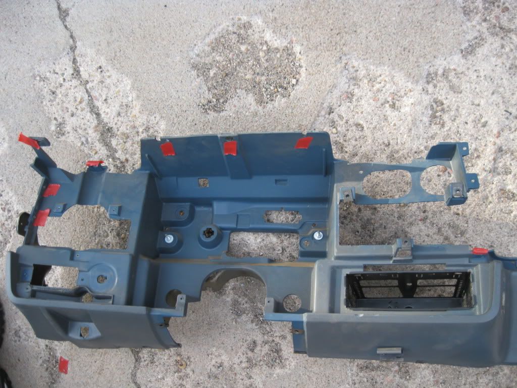

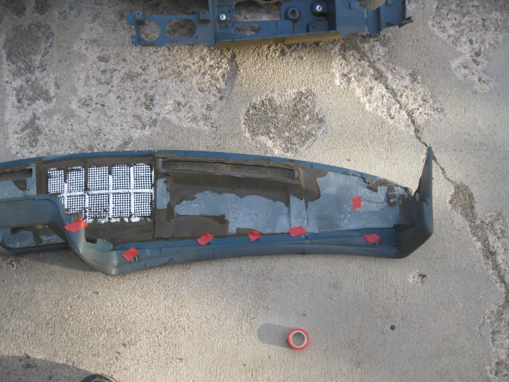

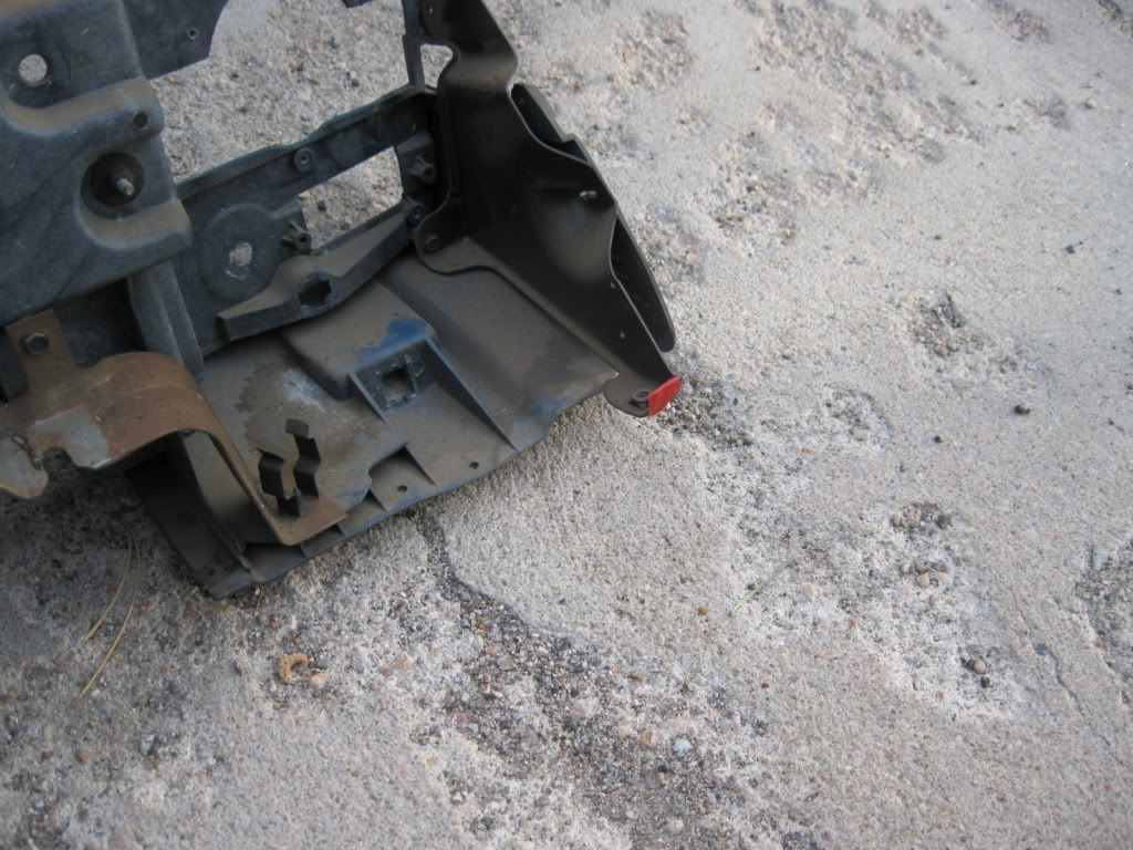

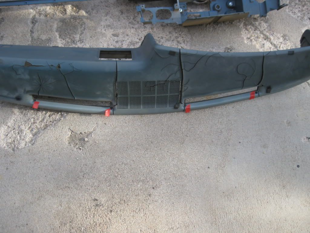

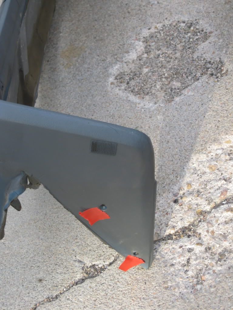

FIRST OFF CONTRARY TO EVERYONES BELIEF YOU DO NOT HAVE TO REMOVE THE WHOLE DASH TO REMOVE THE PAD and with that being said. My dash in my 76 laguna came from a 75 monte carlo and the pad itself came from a 74 Chevelle it does and will come apart.
#1. first and foremost DIS-CONNECT THE BATTERY......i didnt have to worry about that part my motor is out LOL
#2.there a total of 13 screws to remove the gauge bezels(you also must very carefully remove the clock setting knob)it comes off separate from the cluster ...........................................
#3. there a total 4 screws and two nuts holding the cluster in (the two nuts are 9 or 10mm nuts)and to remove the speedo cable from behind the cluster is a spring loaded clip push up or down (DON'T PUSH TO HARD IT WILL SNAP) then remove gently for you don't rip the circuit the connection for the electrical workings of the cluster ..................................................
#4.pull gently with a little strength it will just slide out after that..................(HOPEFULLY YOU ARE BAGGING AND TAGGING AT THIS POINT IF NOT DO IT FOR MOST OF SCREWS ARE DIFFERENT SIZES AND HAVE TO GO BACK IN PROPER SPOT OR YOU WILL FRY YOUR DASH PAD( YES I SAID PAD, FOR THE ONES I SEEN ALL ARE TWO PIECES UP TO A 76 I SEEN HAVE TWO PIECES)
#5. there are 2 bolts on each side one going up one going out.......remove both(that releases the frame the holds the pad and dash together) then once you get both sides out pull forward gently you will a phillip's head screw (that must come all the way out and removed,keep all these in a separate bag from rest they are different once again) then remove the glove box door (4 screws) remove ashtray (2 screw's) AND REMEMBER THE 4 SCREWS 2 ON A SIDE FOR THE DEFROSTER VENTS BY WINDSHIELD (AGAIN LENGTH CRUCIAL) .
#6 there about 12 to 14 ----- 1/4" head screws that go up into bottom of dash pad (Keep separate also these are length crucial)
#7 take the 4 bolt's out that hold the steering column in(let the steering column hang there)
#8 there are 4 more bolts that hold the dash to the steering column frame (THESE MUST COME OUT ALSO,again keep separate)
#9 the heater controls are next very carefully (PULL AND LABEL THE SPAGETTI FOR THE HEAT/AIR CONTROLS YOU MUST DO THIS FOR YOU DON'T FORGET ITS A HEADACHE TO FIX CORRECTLY)
#10 You can start inch your dash pad forward it will separate from the dash assy, there a few odd and end screws you will discover for the vents you will have to remove as you pull the dash pad forward, take your time on these THEY ARE VERY BRITTLE !!!! don't forget to disconnect the tubes for the air/vents
#11 when all the screws and such are removed there are two little clips slide in type one on each side of dash pad they are almost to the edge of dash pad (about one inch over from side of vehicle)
and these were taken from the chevelle side of life (FOR REFERENCE ONLY)NOT TO STEAL HIS THUNDER
Get to these after the glove box is removed, the two at the upper right can only be accessed by removing the HVAC controls
These are accessed after gauge cluster removal.
These are from the outside, the one closest to the point may need the kick panel loosened from the door jam
Defrost vents
Lower dash right side
Lower dash left side
This is directly above the glove box and must be removed along with it's bracket in order to remove the upper dash

the red tape marks on the dash (dash pad only) you remove them and the dash should / will come out
