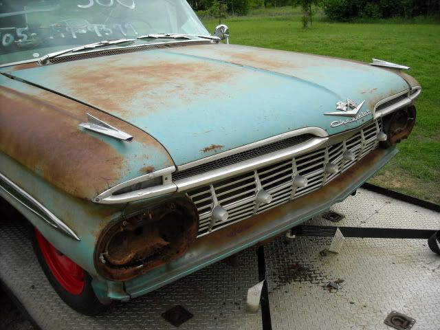

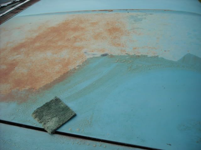

06-06-09 11:28 PM - Post#1712505
    In response to Skim
Heres a little sample I thought I'd share on how to remove surface rust off the original paint with CLR. Just a little demo on my 59 El Camino.

CJS57
Posts: 2466
CJS57
Loc: New Milford , Connecticut
Reg: 01-18-05
06-07-09 04:15 AM - Post#1712545
    In response to Skim
Skim, You are the Man! The patina "restoration" results are perfect! Your ElCamino will be the hit off the show.

inline0_0
Posts: 1456
inline0_0
Loc: Arizona desert
Reg: 03-10-04
06-07-09 04:54 AM - Post#1712571
    In response to CJS57
Skim, Thanks for the tip & pics. Lucky, my ride is orange so it don't show up so bad. Being my only car, I put 10 to 15 thou. mi./yr. on it. Since '88. How many can match that! Last speedo broke, no more local repairman, I went to a hourmeter for oil chages. Aircraft rated, $25, they never quit. Pics below.

gotta56forme
Posts: 3403
gotta56forme
Reg: 09-19-03
06-07-09 08:57 AM - Post#1712669
    In response to inline0_0
Wow... on those fender tops I would have said there wasn't any paint left on them. After you CLR'ed it I was really surprised...
I know better than anyone how deceiving photos can be, but I think they should nickname that CLR as 'Old paintjob in a jug'.
Does that car run? If it does, I'll give you $600 now that you've cleaned her up...

Deceased
Posts: 9224
cnbell
Reg: 04-14-04
06-07-09 01:59 PM - Post#1712843
    In response to Skim
$500 for a 59 El Camino ? I'll double your money if you're interested....
Hard to believe how well that CLR works.....

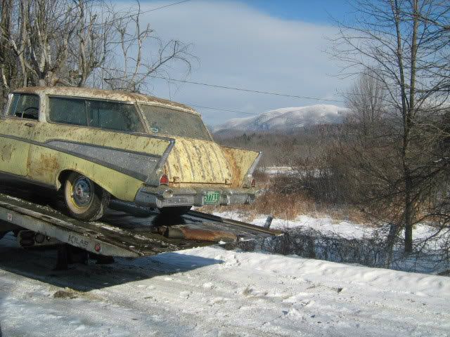

06-08-09 06:25 AM - Post#1713174
    In response to cnbell

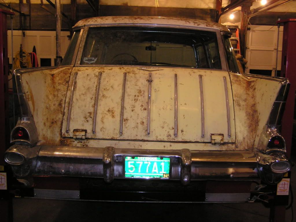

Great results on the 59'. What ya think about me trying on this Olde Wagon ?

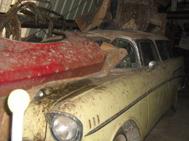

06-08-09 06:27 AM - Post#1713175
    In response to ssffnomad
Before Bird Poop Removal

Skim
Posts: 31
Skim
Reg: 03-22-08
06-08-09 06:38 AM - Post#1713184
Oh man, that would clean up so nice. CLR with warm water in a bucket 4 to 1 and the green scotch brite pad and that car would turn out nice.
as for the 59, yes its one of my next projects but later on after next year. That was right after I brought it home.

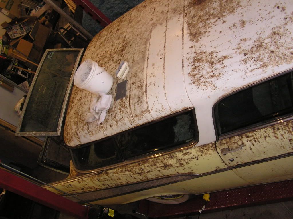

ssffnomad
Posts: 2491
ssffnomad
Loc: Saratoga Springs N.Y. U....
Reg: 10-19-00
06-08-09 07:02 AM - Post#1713193
    In response to Skim
Notice the lead seam at bottom of C post
Hot Water, Simple Green, Green Pad, Brush, Rubber Gloves, after $10.00 at Carwash on Flatbed @ Freezing Tempatures
