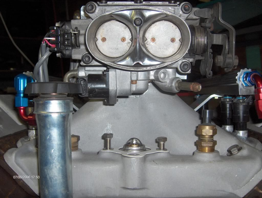

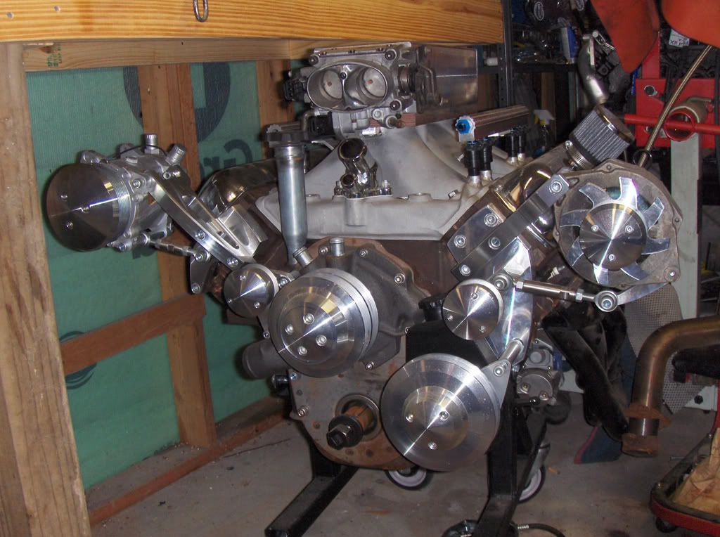

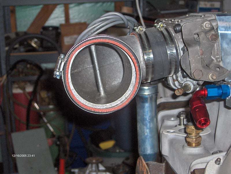

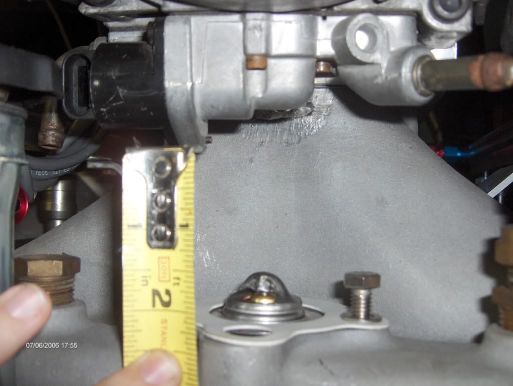

  • 2Loose Said:
[url=http://2loose.chevytalk.org/olds425four.html]
Willy,
Perhaps I missed it, but where did you get that water neck? I need something similar for my engine. I understand you had to modify it.
This last pic has a 1 inch spacer between the plenum and the lower manifold so the water neck is not touching the bottom of the throttle body.

I'd hafta think about that, don't remember right off hand, it was sorta like a one-off on the evil-bay, looked like hand machined, and I mod'ded it to clear the blower.
Drove that blower around town today, still a nice and very cool car to drive around here...
Willy
Update:
Ran across these pix of the manifold water hose neck after I cut and tig'd it back together...
