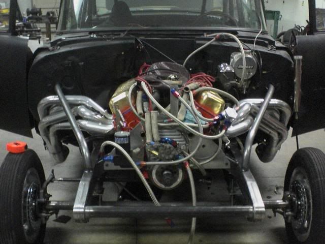

Well, here's what happens when a nutcase gets loose with a sawzall....
Only two pix on my webpage so far, will add more as we get started on the frame mods....
Link To "WhackJob" page
Here's a frame job on a '55 called "Shaky Puddin", I like the work these guys did, let's see how ours stacks up when it's all over but the drinkin'.....
I particularly like this shot when they were mocking up everything with the headers on, love those headers....
Aloha,
Willy

06-27-09 11:35 AM - Post#1724495
    In response to cnbell
Hi Guys.....
Am back from my travels in Italy and France, and am back to work on the '55 gasser project, started setting up the new front frame rails, and positioning the front axle and springs:
LINK TO MORE PHOTOS
It's coming along, taking my time and measuring everything repeatedly, I only want to weld this up one time!
I'm enjoying this project. I'm not working (the income producing kind) this year, so far, and not from choice, so I have more time to put in on my projects (and my wife's projects......), but am out of money, so good thing I already have most of the parts I need for this project on hand. The body will stay as is, with "original patina", for some time. The body is essentially solid, the doors hang straight and the hinges are tight, same with the hood and trunk hinges. Eventually it'll get redone, but just want to get it running and safe to drive!
Aloha,
Willy

07-11-09 11:59 AM - Post#1732925
    In response to 2Loose
Got the front springs mounted, looks good to go!
I've got 6 deg caster built into it, if I want more I will add steel wedges under the springs.
Will now setup a spare Olds 455 block I have with the pan and blower on it to determine final motor location and any possible interference with the steering setup. Still looking at several options for the steering.
Have any of you seen anyone do a proper job of using the stock '55 steering box with a straight axle setup? Location looks wrong to me, but will investigate further before final decision.
MORE PIX HERE
Aloha,
